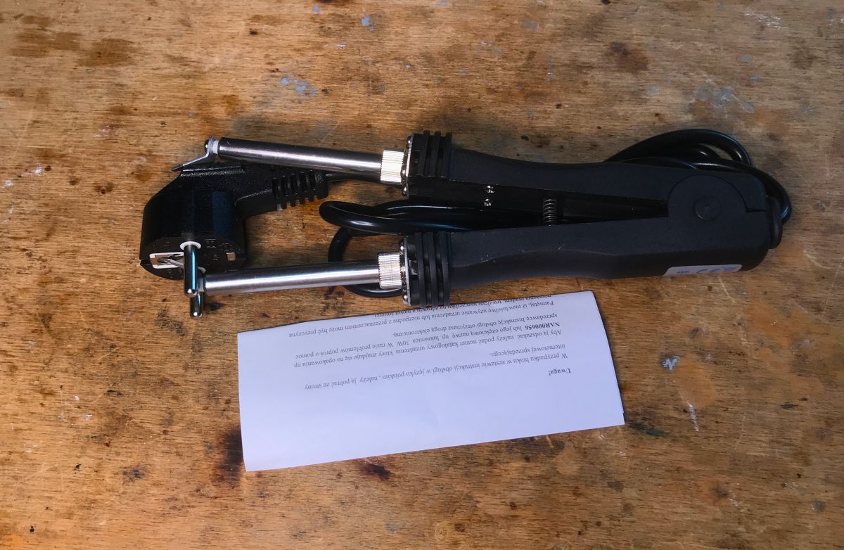

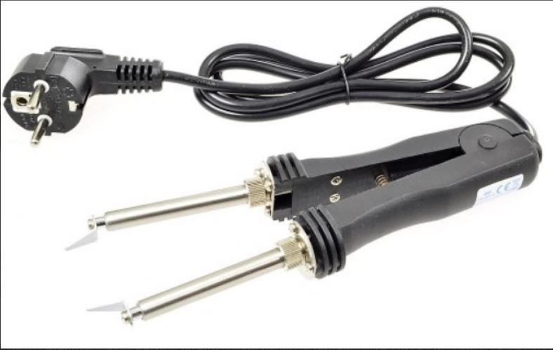

    As I wrote in the last sentence of the topic - it was tested and will be on the forum soon:
    Electric tweezers with a cable and plug lying on a wooden table, next to a sheet of paper.
    But in a nutshell, both solutions have their pros and cons, I was a little disappointed in the case of tweezer with less heating power, I was not supposed to reveal the details, but.... this capacitor already that tweezer what I had did not solder (and on the same motherboard I tested), my tweezer already required the help of a heater or hot air.

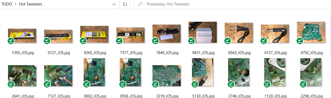

    I will write down the details and impressions soon, for now I only have photos:

    The model I tested was a 48W (88-4094), and it's also important not to transfer experience from it to other, potentially more powerful tweezers. It's like with hot air, there are stronger ones and weaker ones. For example, the Great Electronics Guy from YT has a decent hot air station he bought that heats up PCBs really fast, he doesn't even use a heater at all from what I've seen. Cheap hot airs don't compare to that. Just see at his place on materials called "shorts", which are really reports of repairs without trimming

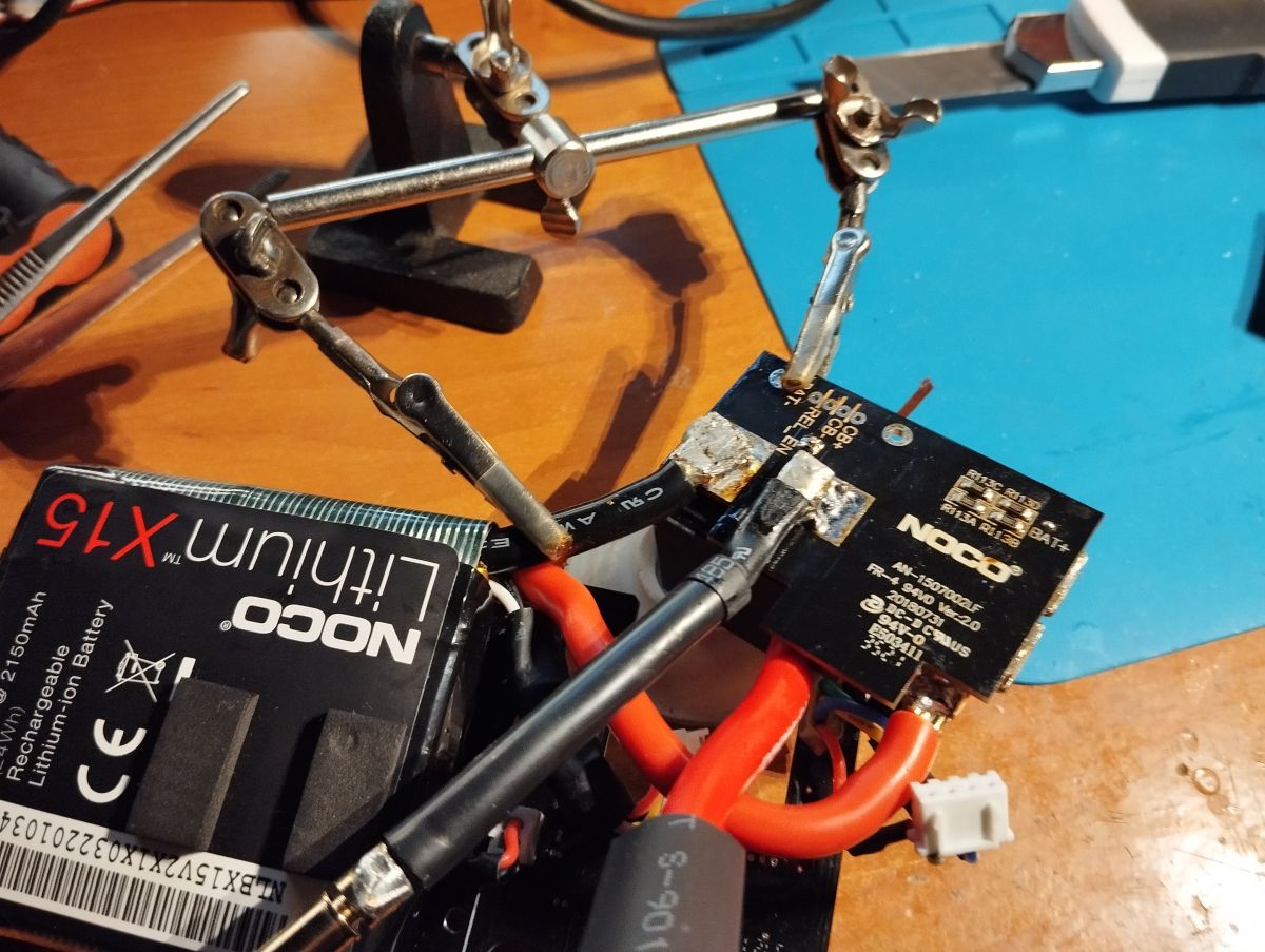

    I recently repaired a NOCO GB40 jumpstarter and on this occasion I used the technique of two soldering irons and a hotair.
    Cablochs so thick and such "fat" connections that otherwise it was impossible to move it.
    Repairing a NOCO GB40 jumpstarter using dual soldering techniques.
    And by the way, "tandem" soldering is the norm. Flask + transformer, transformer + desoldering machine, everyone plows as much as they can....

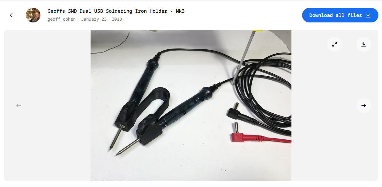

    I wonder if it would be possible in any meaningful way to make a kind of "adapter" from 3D printing to two typical soldering irons from China. This would allow one hand to operate both soldering irons.... or maybe someone has already figured it out? Need to check Thingiverse.
    Added after 8 [minutes]:
    https://www.thingiverse.com/thing:2766715
    3D-printed adapter for dual USB soldering irons. .
