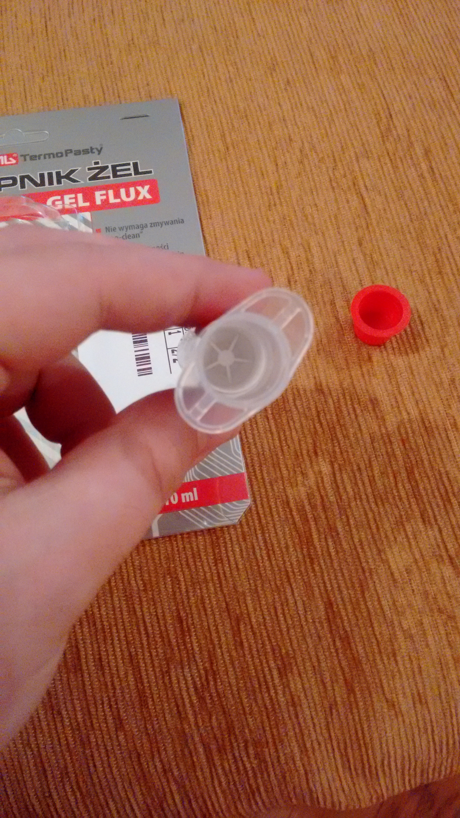

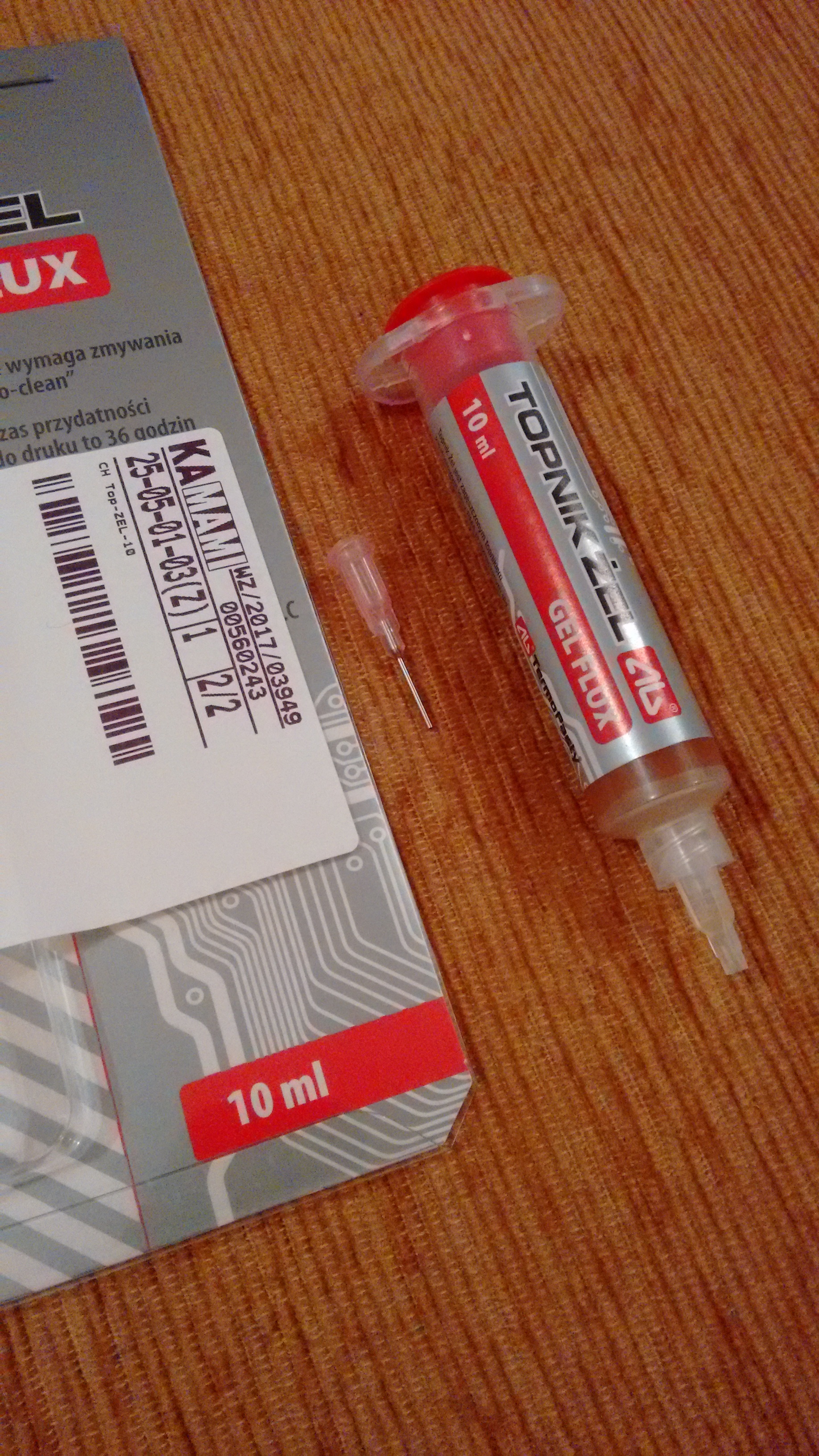

  • #16 16350136
    makaronmc
    Level 30  
    Posts: 2916
    Help: 7
    Rate: 238
    Board Language: polish
    Today my flux came from kamami.pl ...
    But I don't know how to use it .. because the set does not include the syringe plunger: /
    Do I need to buy something?

  • #17 16350152
    elektryku5
    Posts: 6292
    Help: 459
    Rate: 1049
    It should go from a 10ml syringe, for some fluxes they give a pusher, but it is different.

    makaronmc
    Level 30  
    Posts: 2916
    Help: 7
    Rate: 238
    I wonder why there isn't?
    I have to have something to push it out ..: /
  • #19 16350330
    tzok
    Posts: 38661
    Help: 3162
    Rate: 6406
    I use a pen ... there are actually cartridges for the squeezer (as for construction adhesives / silicones), but because they are expensive, in amateur conditions, people handle them in different ways:
    https://www.elektroda.pl/rtvforum/topic3169556.html
  • #20 16374350
    max-bit
    Posts: 4556
    Help: 116
    Rate: 834
    never has a plunger :) more precisely the follower :)
    Basically they are intended for automatic stations in which this is the pusher.
    and then something thinking doesn't work :)
    It's best to buy a 2ml syringe, a needle> 1.2 (1.6) thick, even a thick needle (for biopsy)
    Trim the cut and we have a beautiful kit
    You can also use small 1ml injection syringes for general cargo.
