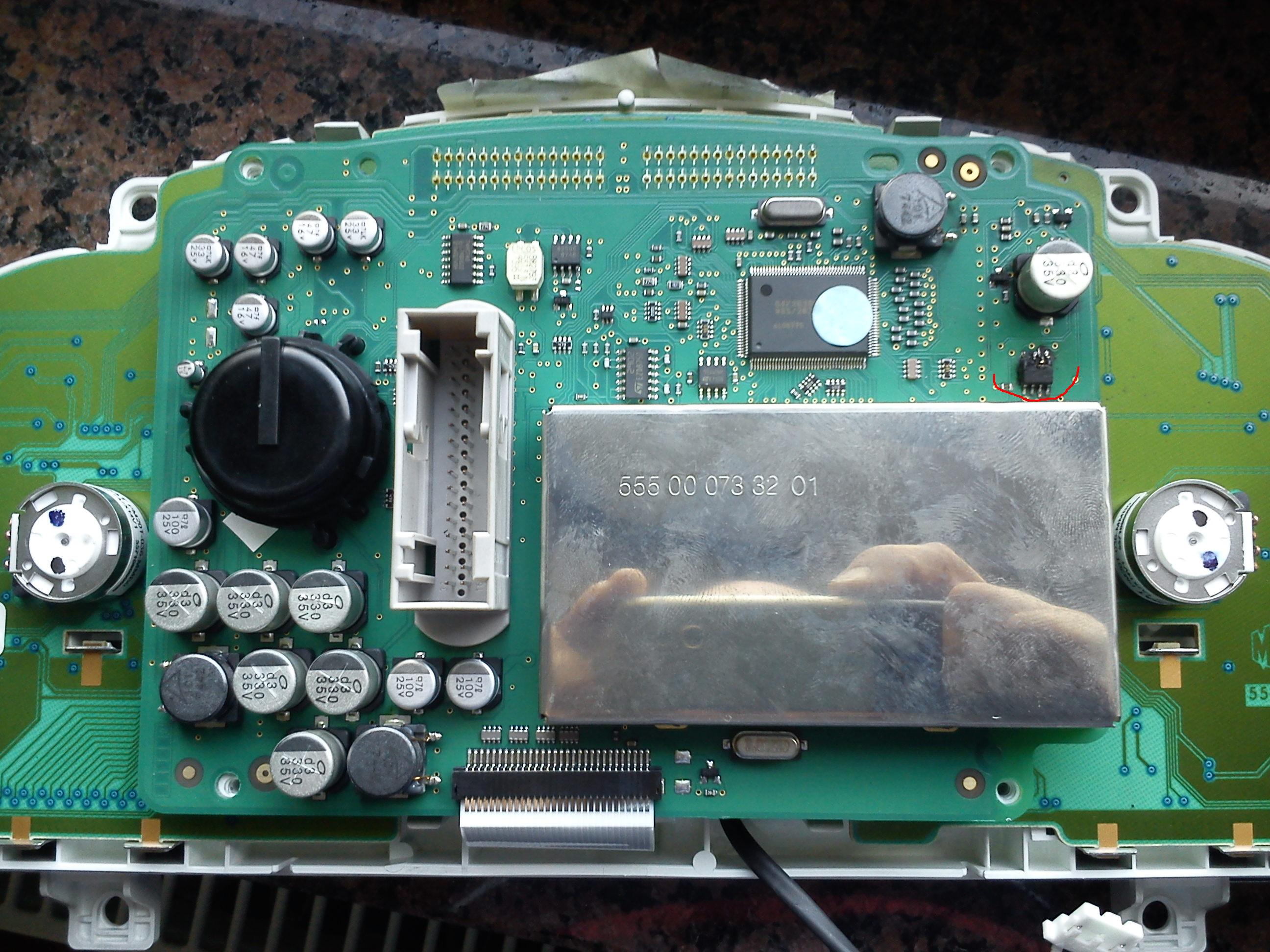

    Hello. Counter Magneti Marelli and defective FIS.
    I attach photos and request - what a bone - this one is marked in red. The system is burnt so that I have no chance to read the signs.
    Counter Audi A6 2007/2007: Magneti Marelli Defective FIS - Identifying Burnt System Component Counter Audi A6 2007/2007: Magneti Marelli Defective FIS - Identifying Burnt System Component

    I do not know this yearbook, but I was doing a similar counter and I am a integrated voltage stabilizer - two stabilization voltages.

    H57AB

    Do not count on the fact that if you put in a working / translate from another it will move. I've already tried, something is burdening him and he shoots.

    the system is 9945A (double mosfet). The damaged transformer releases it. Both elements work in the MFA backlight system.
