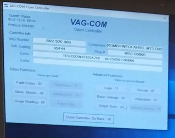

    I have a problem with the meter in the Audi TT 8N, Jaeger 8N2920980A.
    Unfortunately, I don't have him in front of me, my friend comes back to me tomorrow. The fault is that when driving, probably from shocks, the temperature and fuel level tips suddenly drop to zero and at the same time the LCD resets as if. I had it on my desk a few days ago, I replaced the engines, but that's not it. The fault occurs when I bend the entire disc, which is why I think it's a solder issue.
    I sold out most of the components in places where it seemed to be occurring but nothing helped.
    Tomorrow I will continue to search, but so that my friend does not wait too long, in the meantime I ordered another meter with the same designation 8N2920980A and if I do not find anything, I will try to reschedule the entire meter.
    I know you will need to rewrite the keys, although I don't know how / where. For now, I only have a cheap VAG-KKL cable and VAG-COM 409 soft cable. Can I handle this equipment? Apparently I also need PINs that I don't know where to get.
    Wouldn't it be easier to convert the percentage from the old meter to the other one so that you don't have to code anything?
    I will try to repay you accordingly.
    Regards
    edit:
    I have some old recording from connecting the meter, poor quality because it's just a fragment:
    Resolving Audi TT 8N Jaeger 8N2920980A Meter Resetting Issues and Key Recoding
    Do I think that the number in the "Soft coding" field is this PIN?

    vagem pin you can not read, soft coding is not a pin, find someone with carprog maybe it will help to repair the software in hc908 possibly replacement and programming

    there are two hanks hc912 and hc908 and both for shifting

    I put both Procks, 08 and 12 from the first one in the second counter. The engine started, everything seems to be playing but the yellow indicator from immo is still flashing. After about half an hour of driving, the buzzer turned on and still buzzing from what the friend said on the phone. I have to go to her tomorrow and fix it, I just don't know how. Is it all about coding keys or something more?
    I thought that if I translated both Procki, everything would be the old way.
  • #9 16595370
    seat21
    Posts: 901
    Help: 151
    Rate: 399
    check soldering maybe there is a jumper somewhere

    you disconnected the battery for 10 minutes
    Added after 9 [minutes]:
    vagdash can should read the pin
