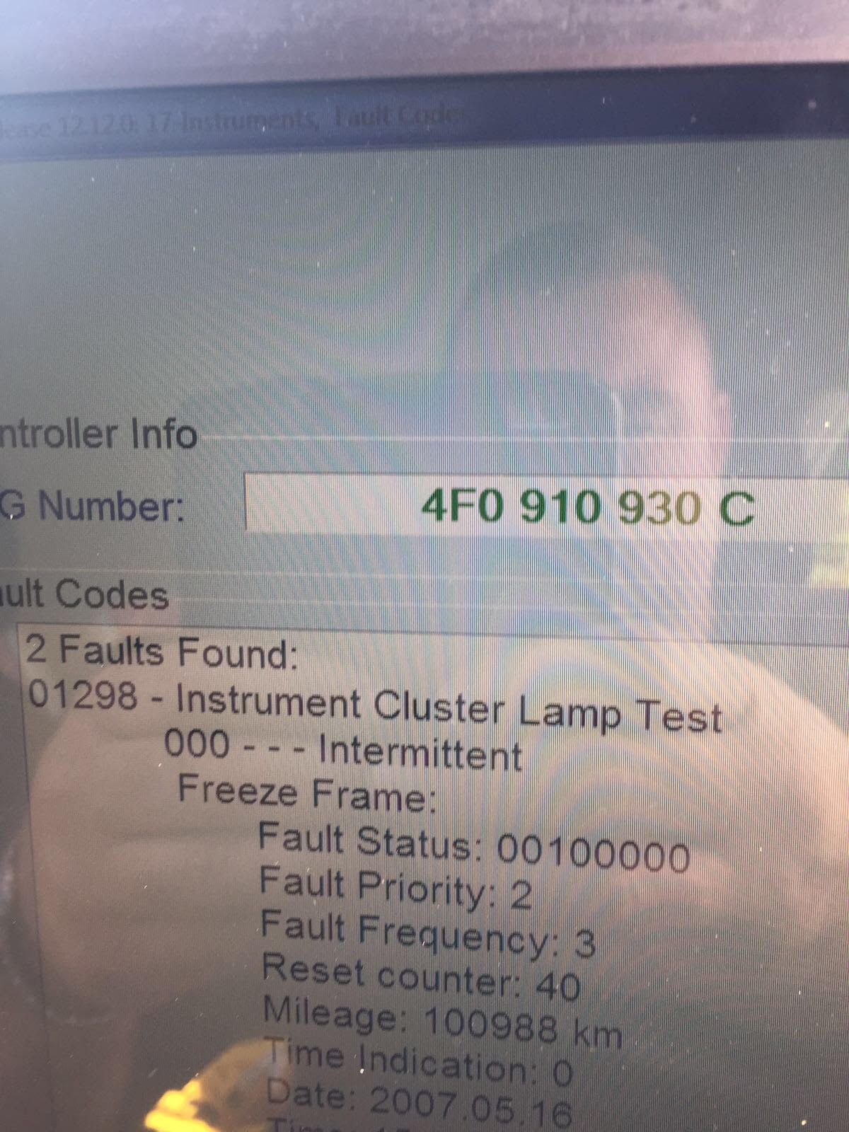

    He also sent me pictures of these bugs:
    Audi A6 C6 2008 - Error dEF after Odometer Repair: Replaced Inverter, 74HC08A & Si9945A MOSFET Audi A6 C6 2008 - Error dEF after Odometer Repair: Replaced Inverter, 74HC08A & Si9945A MOSFET
    unfortunately, I don't know if he deleted the errors before, as I told him. It's hard to get information from him, even though he's a car electrician.
    I rather doubt that these errors have anything to do with this situation.
    You write an EEPROM error, so I guess I think it has absolutely nothing to do with my replacement of the inverter, gate and MOSFET?
    The customer insisted on sending the meter back to me, because it was working before the repair (although it also worked for several hours after the repair).
    I hope I can recreate this state, "dEF" error on the desk without the car.
    Alternatively, if it's an EEPROM error, will I be able to do something with just an XPROG? I haven't had a chance to use it yet.

    Errors are the button on the panel to test the meter and controls, maybe he has too big fingers and he broke February.

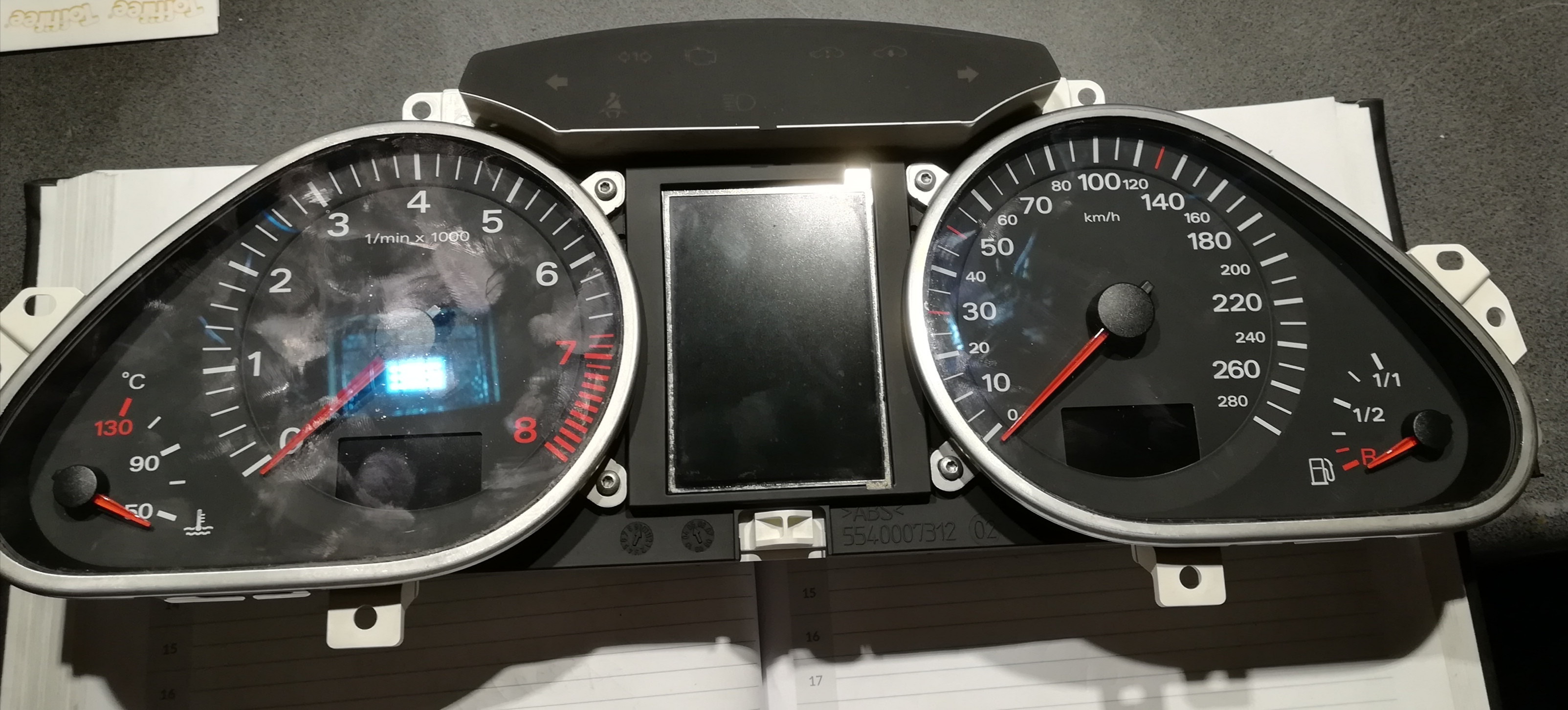

    I got the meter back, plugged it on the desk and it seems to be working.
    I didn't even open it.
    This is what it looks like:
    How do you think, I can assume that everything is ok, or that the client himself mixed up something with the course / adaptation?

    Perhaps the mileage is too small? How did you connect the meter / em.can /

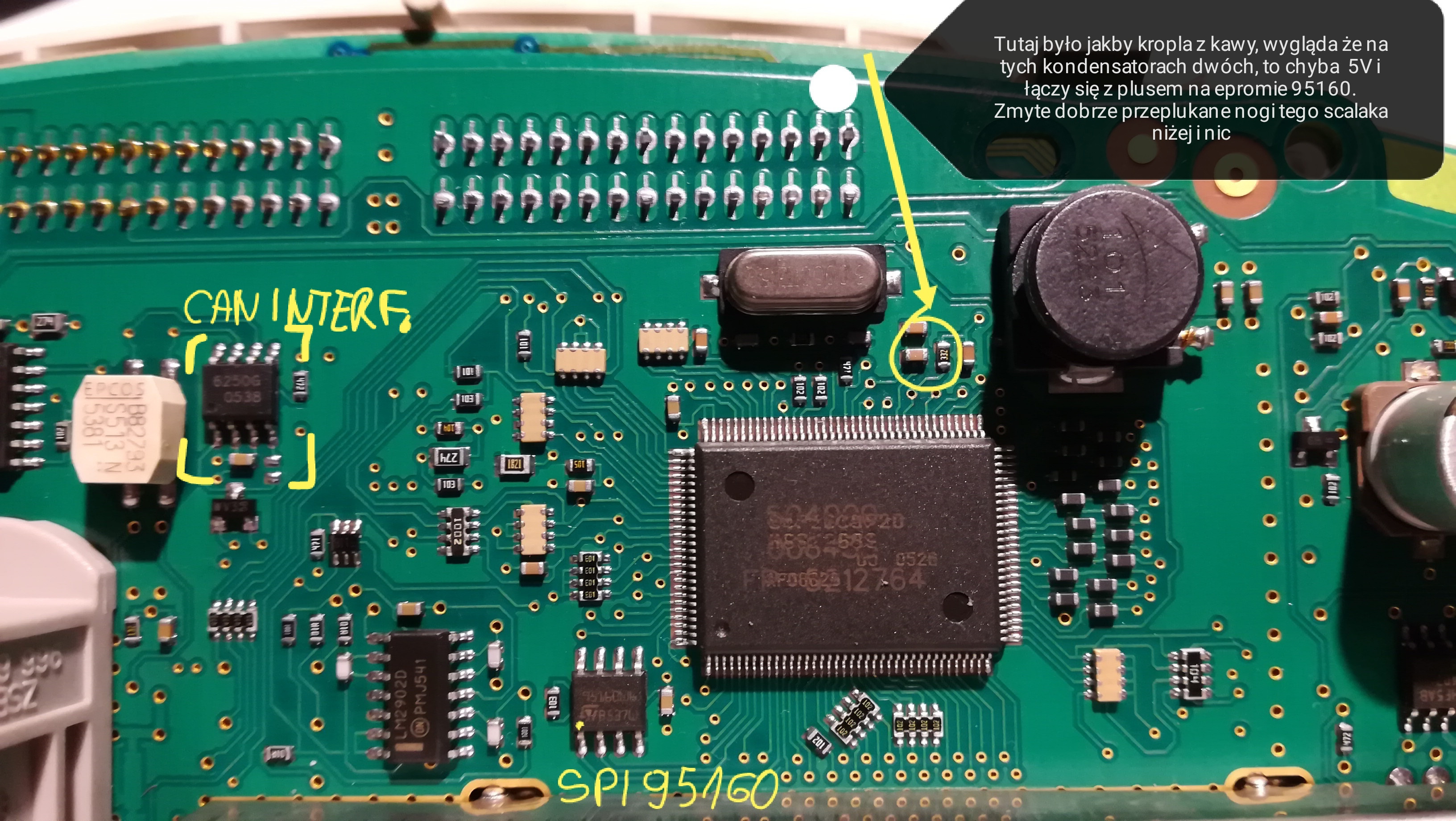

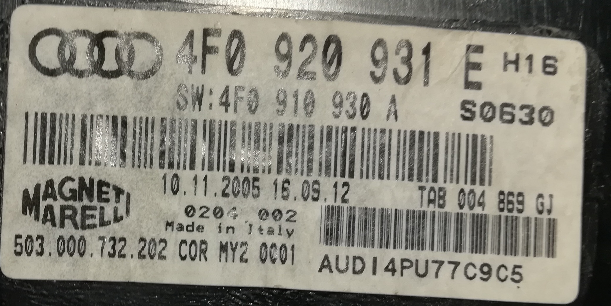

    THE METER OF THE A6C6 2005-3.2 PETROL ENGINE HAS DIED
    4F0920931E H16
    SW: 4F0910930A S0630
    METER PROD 10.11.2005
    Stood in the sun against a wall and so overheated. Ignition switched on and betka nothing works, no communication in diagnostics, I won't connect to #17. No readings displays all dead, including fis. Backlight under fis is there - white glow only. I bought new clocks identical, haven't fastened them yet.
    Does anyone know if there is already OC protection for the component and if I switch the eeprom alone if the org is not dead, should it work or will it be uphill? Pictures are attached
    Cheers Zbyszek K.

    #11 21215747
    rosak
    Car dashboards specialist
    Posts: 1789
    Help: 142
    Rate: 559
    >>21215330 .
    I'm not an expert on replacing anything because I'm always repairing, but I recall trying to replace it once because the hole under the MOSFET was so big that I didn't want to do it. I remember that flipping the EEP alone didn't work, the MCU had to be flipped as well. I suspect that with the right threshold you can easily add such a counter to the car, I don't have such tools though, because I don't need them.
