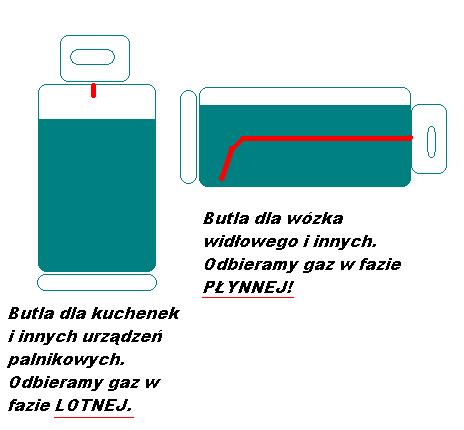

    Hello. I have been using a gas cooker powered by an LPG cylinder for a year. I have already changed the cylinders several times and each time it is necessary to replace the cylinder, I have the impression that there is still gas at the bottom.
    At work, I often replace similar cylinders in a forklift truck (specially adapted to them) and they are light and dry-cleaned. I have recently replaced the reducer and at the beginning the difference in the height of the flame was noticeable. Now, however, the flame is insufficient and there is still something floating at the bottom of the cylinder.
    I would like to add that the cylinder lasts on average for two or two and a half months. We don't cook dinners on it. The stove is used to boil water in the kettle (6-10 times a day), maybe some breakfast and that's it.
    I do not know if there is any way to extract these remnants or are cylinder users doomed to this type of loss? What do you think about it ?

    What is left at the bottom is definitely gas? The only thing that can block is the reducer. There are cylinders that turn it upside down when the gas runs out.

    To the author of the thread: The gas should last until the very end. If you unplug the cylinder and loosen the valve, the rest of the gas will disappear. If the cylinder no longer hisses and something is still splashing inside, it is not gas.
    It is exactly what is known as a fragrance to make you feel it when the gas is released.
    if you pour it out, the stench won't leave you for a long time!

    As for the remains in the cylinder, I think that the picture will explain a lot why there is always something left in the cylinder from the stove, and in those supplying vehicles, the cylinder is empty.
