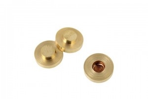

    I have such a cylinder and a wind-up cooker http://kuchenkigazowe.com.pl/kuchenki-nakreca...kuchenka-gazowa-nakrecana-21cmbutla-1-kg.html
    However, despite the fact that there is still a lot of gas in the cylinder, even after unscrewing the valve on the cylinder to max. the flame is too small. And it takes about 15 minutes to boil half a liter of water in kettles. I took this burner apart, there is some rubber inside and a metal insert. I washed the metal surfaces with a solvent, but it did not help. The gas outlets are not obstructed. It looks like the stove has something like a reducer that limits the gas pressure too much. Can you do something about it?

    This metal clasp is the nozzle. You have to pull it out and blow it against the current with compressed air. If it doesn't help, buy a new one.

    It turned out that the cause was prosaic. There was already a residual gas in the cylinder. After the loading, the pressure and the flame immediately increased. But just in case, I blown this nozzle - the hole in it is microscopic. :D

    because almost all butane is left in the cylinder, and it evaporates lazily in relation to propane. At low temperatures, the stove may not work even with an almost full bottle, as its content will be butane alone.
    I had a similar case with such a stove on a plot in winter. I thought there was only butane left in the cylinder, but the new cylinder was the same. Cleaning the nozzle with a wire helped, blowing it with compressed air did not do anything. The problem was finding such a thin wire. I don't know how now, in the past, the burner had wires for cleaning the nozzle.
