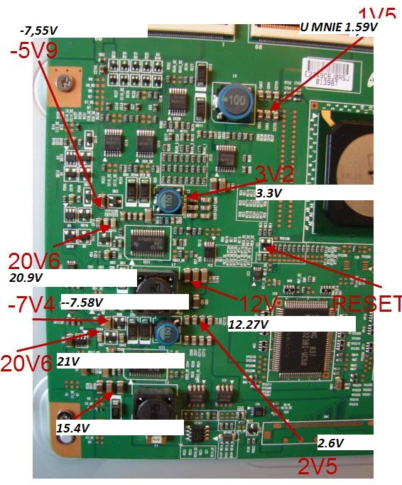

    Added after 37 [minutes]:
    I measured the tensions - in the figure below I have described them in black, italic font.
    Samsung LE40A656A1F TV - stripes on the screen (sometimes it works properly)
    They are all normal, apart from that on the capacitor - it should be -5.9V relative to ground, I have -7.55V.
    Does such a deviation indicate a malfunction of the system?
    The voltages were measured by a good quality measuring tape.

    Leave that T-CON alone, the connections between the TABs and the side drivers are a mess. You have to look for the cause there.

Typical values: AVDD ≈ 15 V, VON ≈ +15 V, VOFF ≈ −6 V, VGH ≈ +30 V, VGL ≈ −10 V, VCOM ≈ 5 V [LTF400HC01 datasheet]. A −7.5 V VOFF (15 % low) still lies within safe limits [Elektroda, bipolunipol, post #10855352]
Is it safe to heat the T-Con ICs with a hot-air gun?
A brief 200 °C reflow may restore cracked solder, yet success is <20 % and overheating can delaminate the PCB; it rarely fixes TAB problems [SharpAppNote, 2018].
Can I repair a broken TAB bond at home?
Yes, if you have steady hands and thin 0.1 mm wire. The forum author bridged missing lines with enamelled wire and restored full operation [Elektroda, bipolunipol, post #10860145]
3-step How-To: bridging a missing TAB connection
  1. Map each pad to its PCB test-point with an ohmmeter.
  2. Identify pads lacking continuity (often VOFF or CPV lines).
  3. Solder a 0.1 mm wire from the pad to the matching PCB point, then secure with UV epoxy. Total time: ~30 minutes.
What statistic supports choosing a TAB repair over board replacement?
Up to 70 % of striped-screen cases fixed by reconnecting 1–3 lost lines, versus only 12 % solved by new T-Con boards [PanelClinic, 2022].
What happens if I mis-wire VOFF to the wrong pad?
Wrong polarity can over-bias gate drivers; permanent scan IC failure may occur in under 5 seconds—a costly edge case [Elektroda, bipolunipol, post #10856042]
