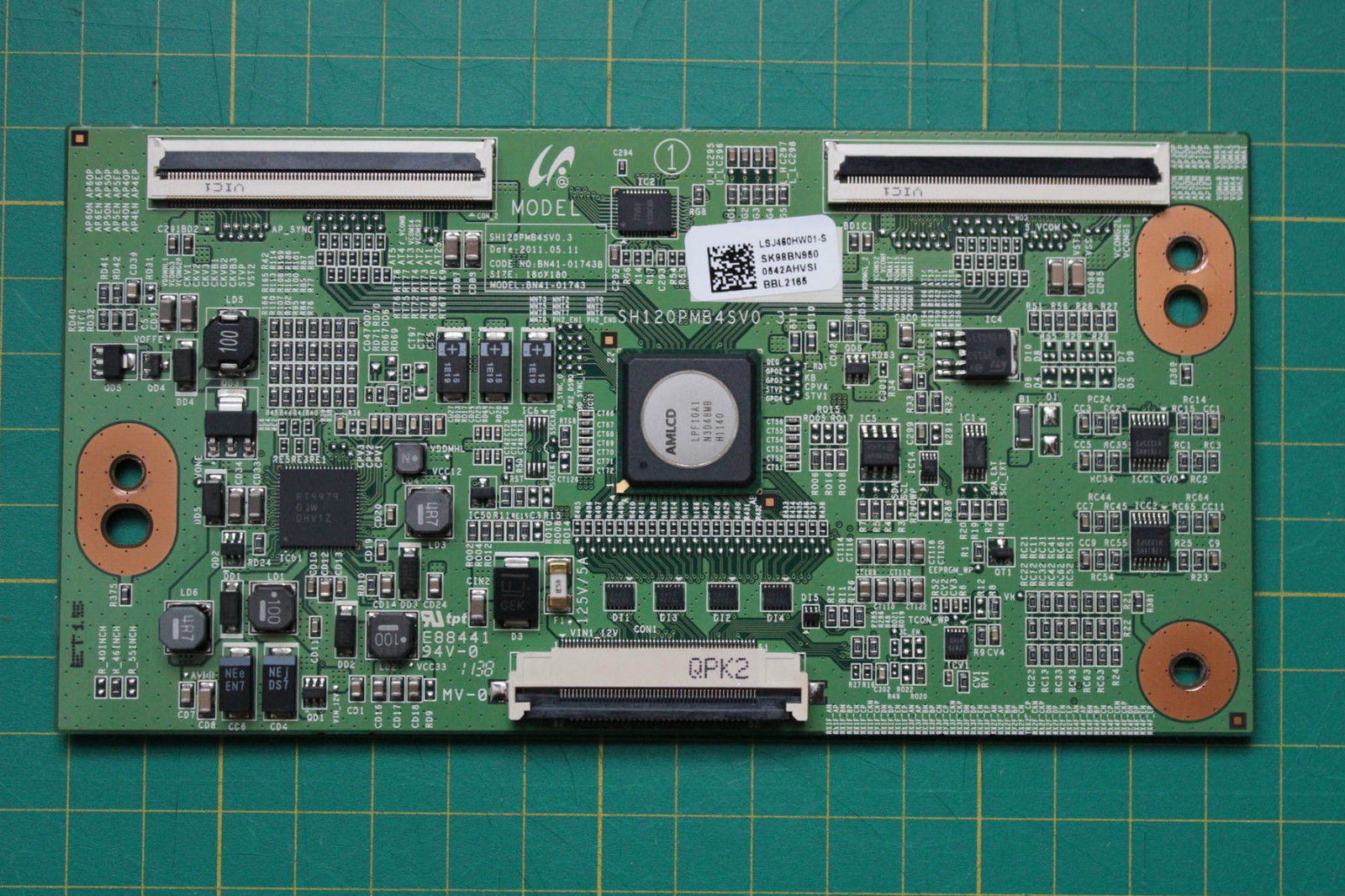

    Primo, we're talking about T-con
    T-con SH120PMB4SV0.3 (pcb: BN41-01743A) 40 "Samsung
    It would be nice to measure something, for this T-con were given in this forum values and tensions in the points described
    * clean it thoroughly on the T-con going to the matrix, as you have the symptom below

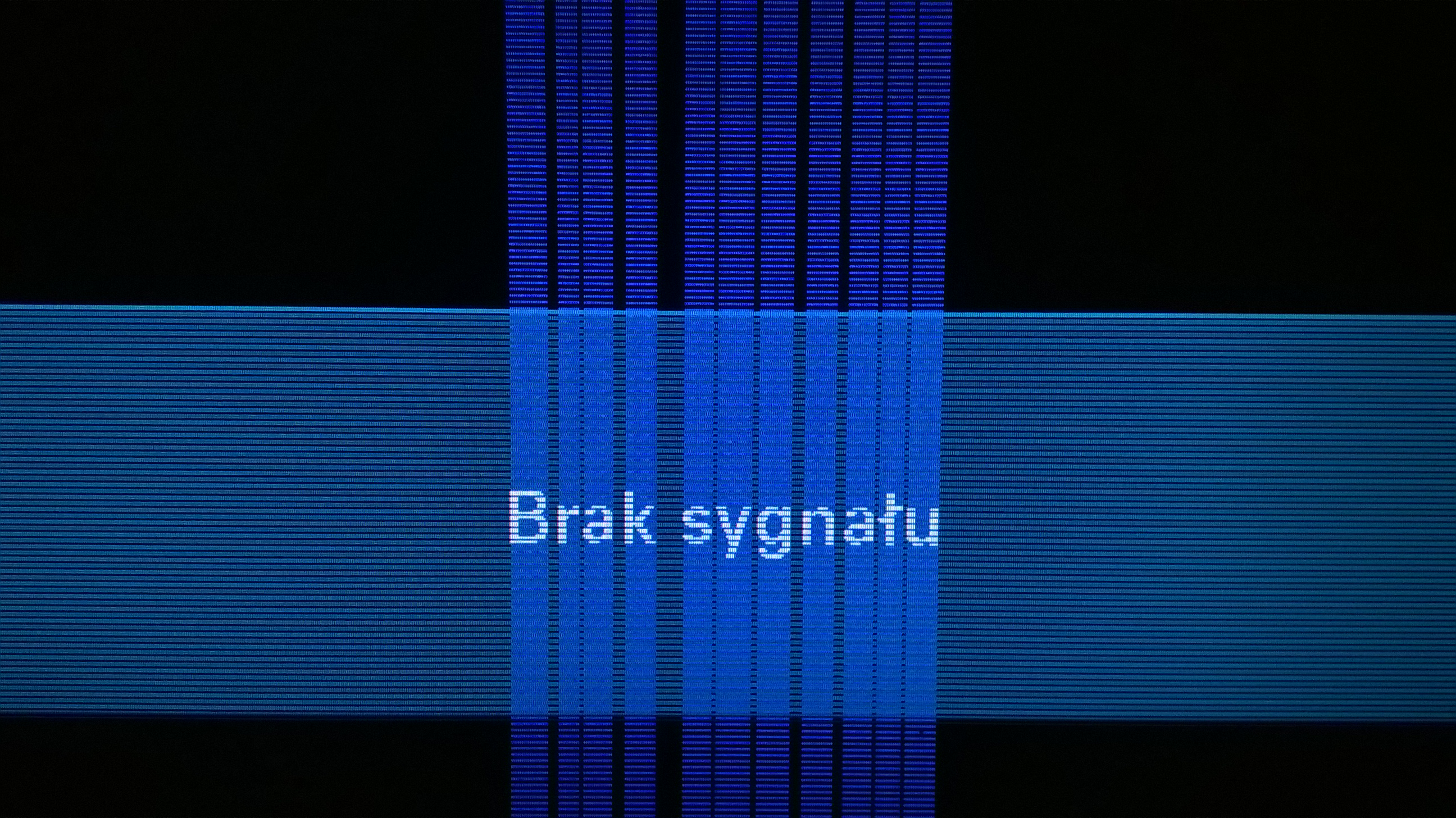

    #7 15048228
    marek07
    Level 20  
    Posts: 557
    Help: 24
    Rate: 75
    This is an obvious damage to the matrix itself. The matrix does not have side drivers and it is not possible to combine the damaged voltages that run between the green matrix bar and the glass itself.

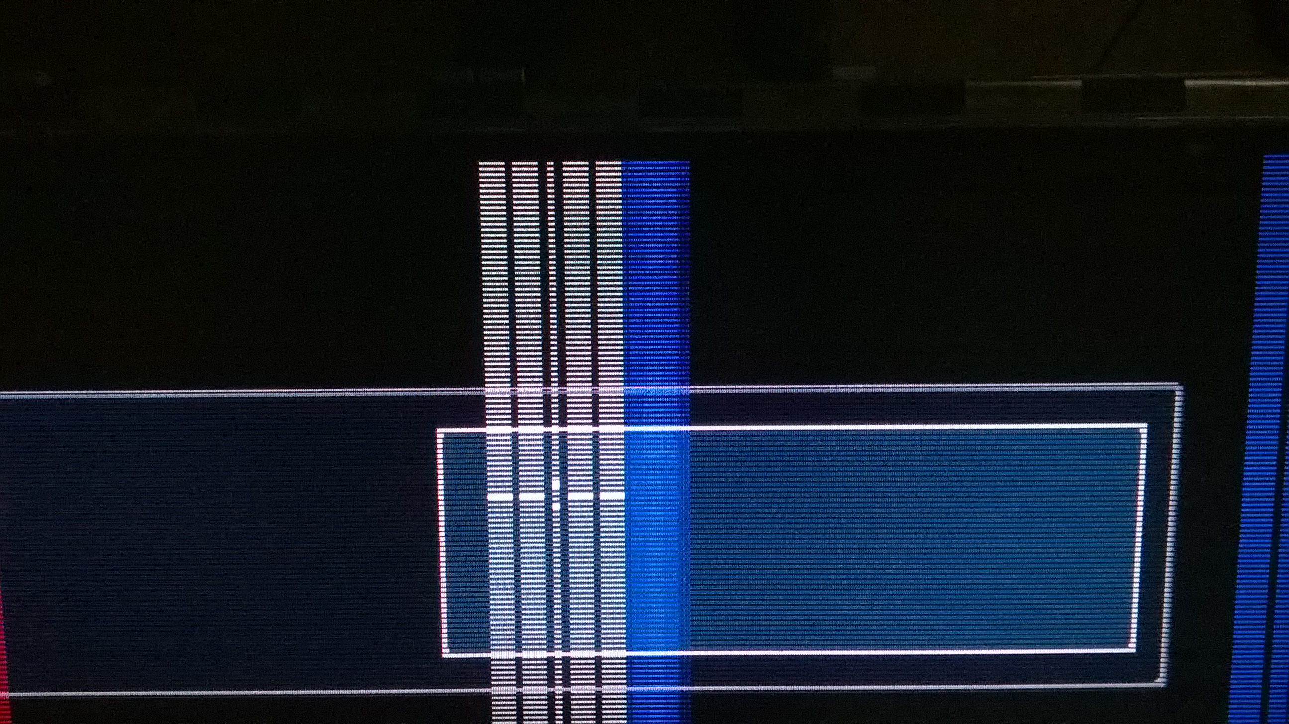

    Marek, what you see in my pictures is clearly a matrix.
    It is not entirely clear what exactly @janomo has, where it will not take good photos.

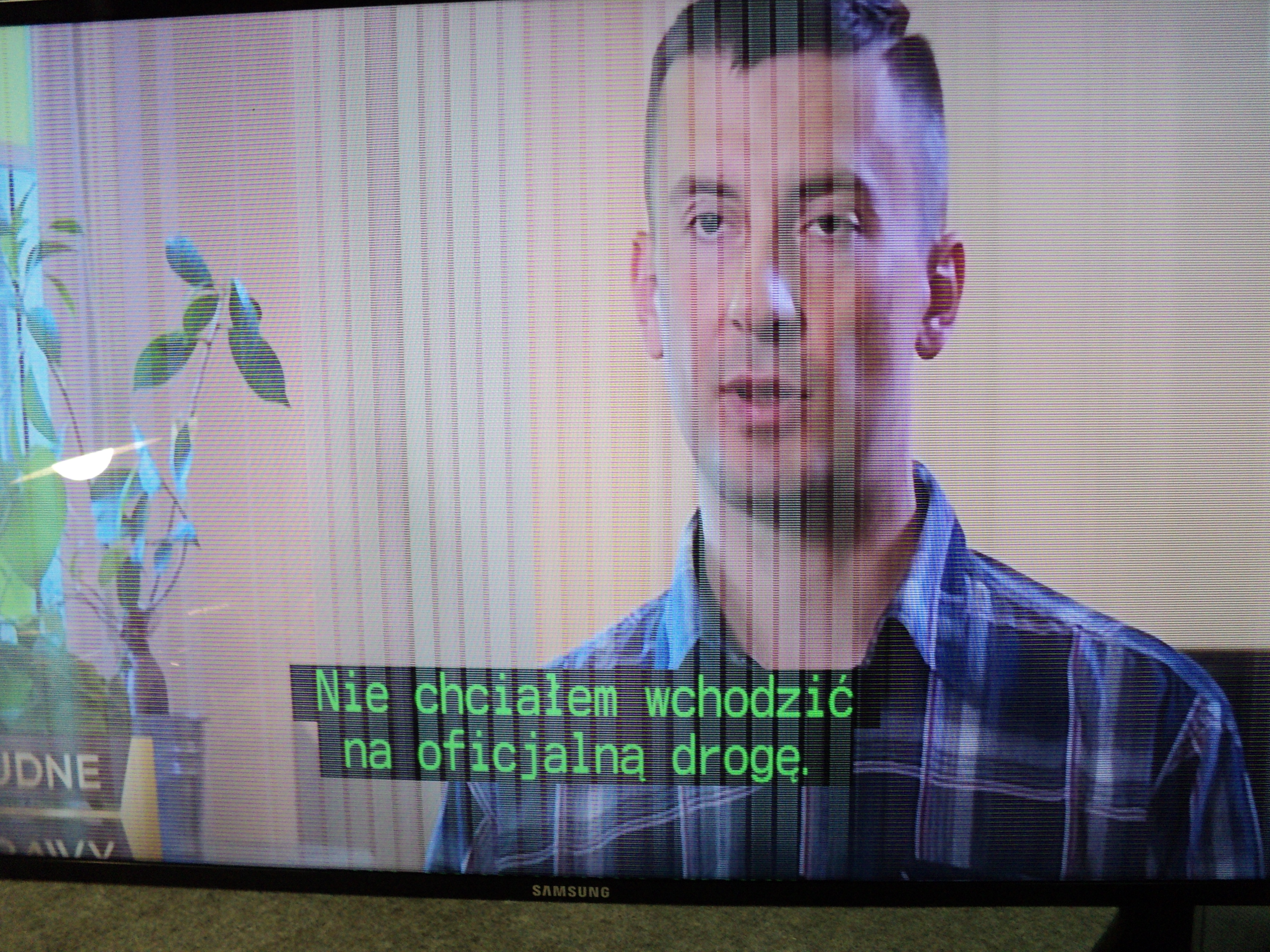

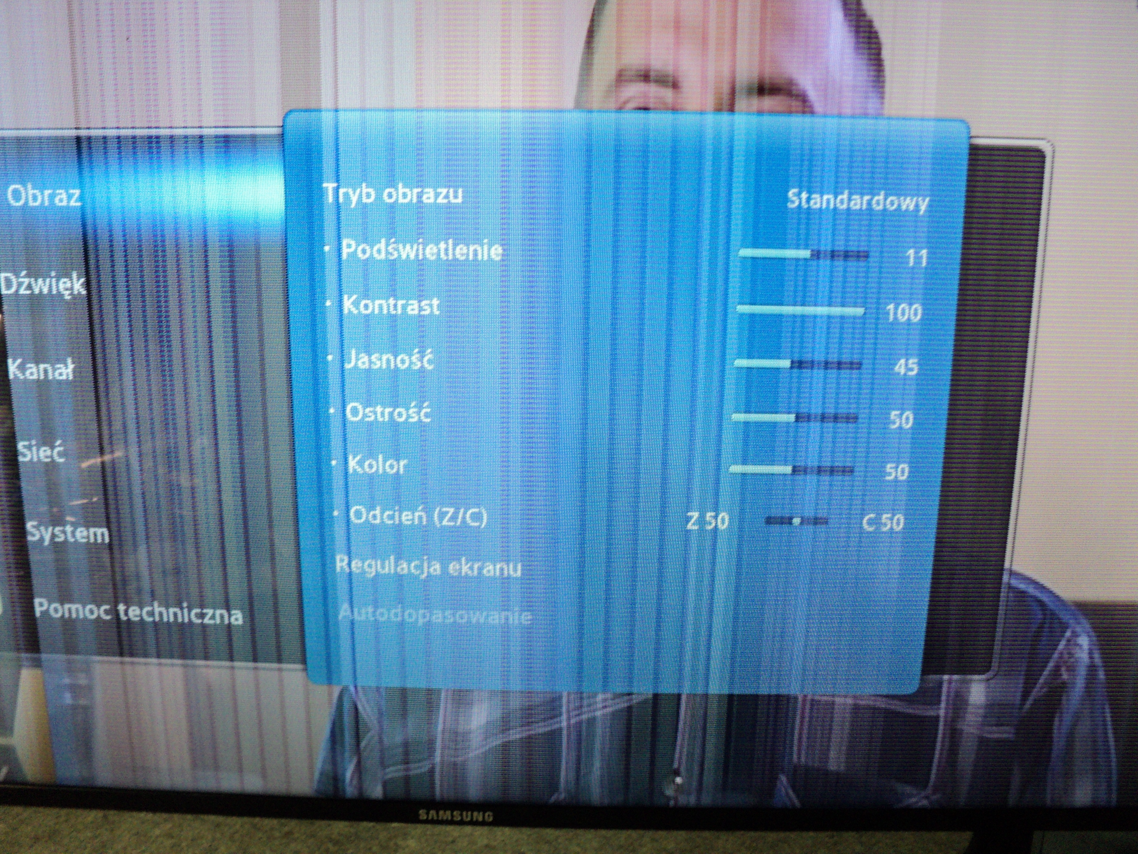

    By disconnecting the logic strips to the matrix, I get the picture on the right half in both cases, still with interference.
    I will try to take pictures.
    Here they are.
    I wonder one more thing, how to make matrix and logic tests without main. I connected the power supply to the logic, the TV turned on and the picture was black. I used to get a color test on a TV with this connection.
    And one more thing, why do I still have the same image on half of the matrix disconnecting the individual tapes from logic to the matrix with the same distortions?

    And one more thing, why do I still have the same image on half of the matrix detaching the individual tapes from logic to the matrix?
    Because this is a negative voltage problem Voff, and the visual effect appears only when the problem is on both sides of the controllers on the connection with the glass. Analogously to the matrixes with "ears".

    Rate: 6819
    Rather, an indication of damage to the matrix.
    Try to "blow on" this BGA ALMCD (LVDS controller AMLCD LPF10A1), see the effect. Link
    There is no point described on this T-con. for an RGB or similar test like in Samsung
    Samsung UE40D6750 LCD TV - Horizontal Lines & Vertical Stripes, Brightness Issues, BN94-05105F
    ___________
    VIN_12V 12.3V
    VCC33 3.24V
    VCC12 1.2V
    VCC18 (t_con) = VDD (ears) = 1.76V
    AVDD (t_con) 17.15V
    VDDMHL = VDDMHL1 = VDDMHL2 = 8.6V
    VONE 31.8V
    VOFFE -12.2V "with a downside
    VR 9.9V
    VSS -7.4V
    On the COG (left and right side) the voltage should be similar
    VDD 1.75V
    VCOMS 6.9V
    HAVDD 8.58V
    AVDD 17.14
    SVCOM 7.69

    On 80%, the poems on the left are working, looking at these pictures.
    Is there really no difference by disconnecting the individual tapes going to the matrix.
    With this damage, disconnecting the tape from the left side, the image on the other half should be good. The question is, do the disturbances change over time?
    On the left side of the picture, just as he would like to get haze, which would indicate the lack of any of the signals on these lines.
    Added after 8 [minutes]:
    90% damaged glass matrix.
