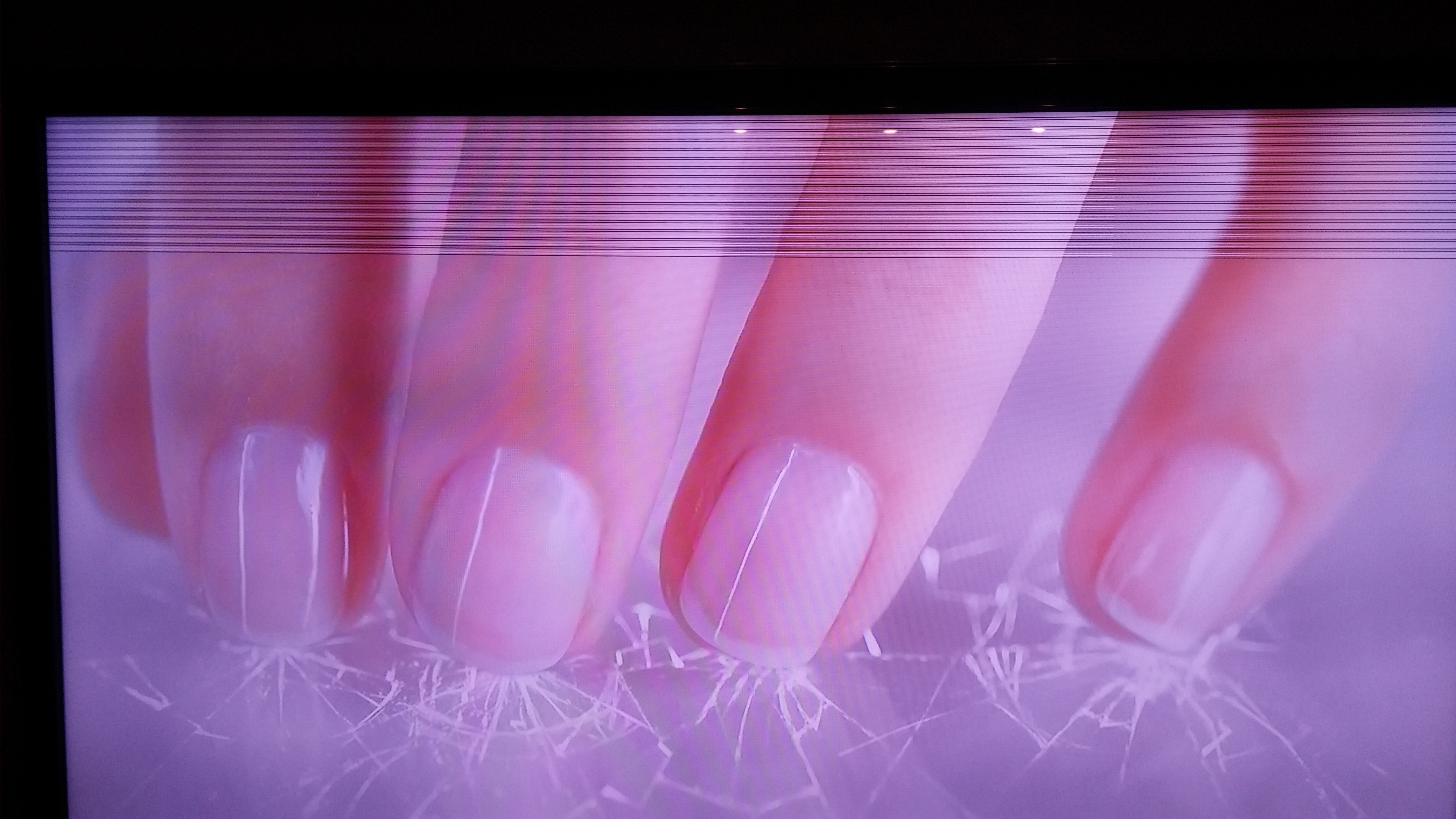

    What could be the cause of the tv glitch with the appearance of black horizontal stripes at the top of the screen about 10cm wide? Is it the matrix has fallen? Is there any chance that something repairable? I showed the straps in the photos.
    Best regards...
    • Samsung UE40D5000 - Black Horizontal Bars/Stripes at Top of Screen Issue: Matrix or Repairable? 20170816_204056.jpg (5.94 MB) You must be logged in to download this attachment.
    • Samsung UE40D5000 - Black Horizontal Bars/Stripes at Top of Screen Issue: Matrix or Repairable? 20170816_204052.jpg (2.45 MB) You must be logged in to download this attachment.
    • Samsung UE40D5000 - Black Horizontal Bars/Stripes at Top of Screen Issue: Matrix or Repairable? 20170816_203957.jpg (2.95 MB) You must be logged in to download this attachment.

    I can see these modules don't cost a fortune. I will order, replace and see. Thanks for the tip ...

    I had a similar situation and unfortunately a damaged panel (matrix)

    For clarification. I wasn't doing anything.
    One day the TV fixed itself but a few days later the problem came back. Such relapses lasted for some time, and finally everything returned to normal and it has remained so until today. So far, the problem has not appeared for well over half a year. We'll see ...
