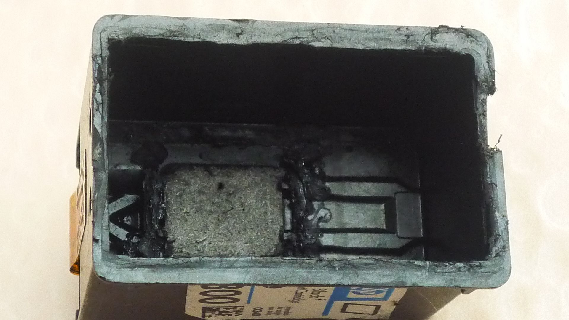

    Maybe you added too much ink, a regular 300 type cartridge is divided into two parts, one middle is a sponge into which 4 to 7 ml is poured and the other is empty. If you pour it full into the middle part or pour it into the other empty part, the weight of the ink causes it to flow automatically through the nozzles and that's why it pours. In older types of cartridges, there were special methods of maintaining a vacuum so that the ink would not spill out. Now the capacities of the cartridges are microscopic, so the sponge itself is enough. One more thing is the hole for equalizing the pressure which is under the sticker, it is to be partially exposed in half a square which can be seen in the enlargement.

    In the color cartridges of the 300 series, there are 3 chambers with sponges for colored inks and 3 empty chambers, so you can pour even less ink there than for black ones.
    In the black ink container, you can remove the plastic walls (with pliers, soldering iron, drill, etc.), insert a large sponge and there will be an XXL cartridge into which you can pour 20 ml of ink. I cut the walls and put 3 washed and dried sponges from the old colored HP49 cartridge next to each other and it works, but I don't fill the ink completely. You can also buy sponges to size, e.g. in the online store -agawa.pl.
    Color is more fun because you would have to cut 3 walls and insert 3 sponges.

    BOBBY1234 where did you rip the tank to cut the side walls or the top cover?. In my black cartridge, I noticed that there is a very "narrow" border between printing and ink pouring through the nozzles. When it doesn't print, I add half a ml of ink and pour some text printing - a few pages and then the end of printing again. The entire tank is heavy, so I'm assuming there's ink in it all the time. I have to try these sponges. I also noticed that inside the cartridge there are two small holes between the chamber with the sponge and the empty chamber and I think this is the problem, probably after the sponge tank is overfilled, the ink flows into the empty tank and through the holes it gets to the main channel and overflows under its own weight through the nozzle. I doubt that 20ml of Ink entered the tank because the capacity of the tank itself is about 15ml after cutting out the walls inside.

    I cut the lid from above, cut the middle walls with pliers and a soldering iron. I put 2 sponges from the colored hp 49, poured over 10 ml of ink at the beginning into the first one and pressed the second one.
    There is a mesh at the bottom of the tank - the filter must touch the sponge with the ink, if there is no direct connection, it will create an air cushion and it will get air.
    The dimensions of the container inside are 4.5x2.5x2.5, so theoretically it can contain even more than 20ml.
    After pouring the ink and sealing it, it is very important to extract some ink with a suction device or push it out from above by blowing hard if there is no suction device and leave a vent hole after sealing the lid.
    • hp300 rozcięty.jpg (256.95 KB) You must be logged in to download this attachment.

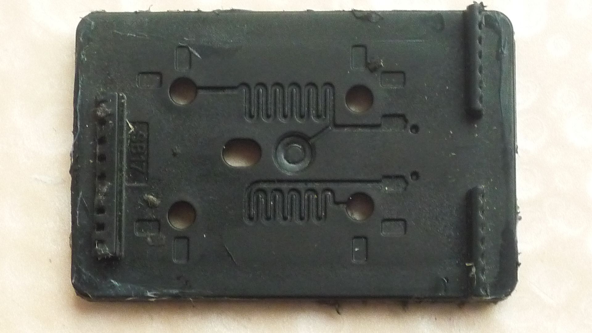

    Nice, but I think with a dremel I'll try to do the same from the side. I will cut out the side wall and remove the partitions. The top is needed because all these vents are there, but I would like to keep them. After inserting the sponge and gluing the wall, it should be OK. Thanks for the hint. I am also interested in the vent hole, whether you do it on the "OKO" or with some specific parameters, because in the original the air comes through some squiggles.

    Under the sticker, these squiggles are venting channels and end with a rectangular cutout in the lid, which is partially under the sticker and partially exposed to allow air access. The regular HP 300 cartridge has one channel exposed and the XXL model has two. I peeled off the sticker and glued it back and exposed the second tubule.
    • HP 301 Ink Cartridge Refilled but Still Shows Lack of Ink - Printing Solutions hp300dekiel.jpg (230.06 KB) You must be logged in to download this attachment.
