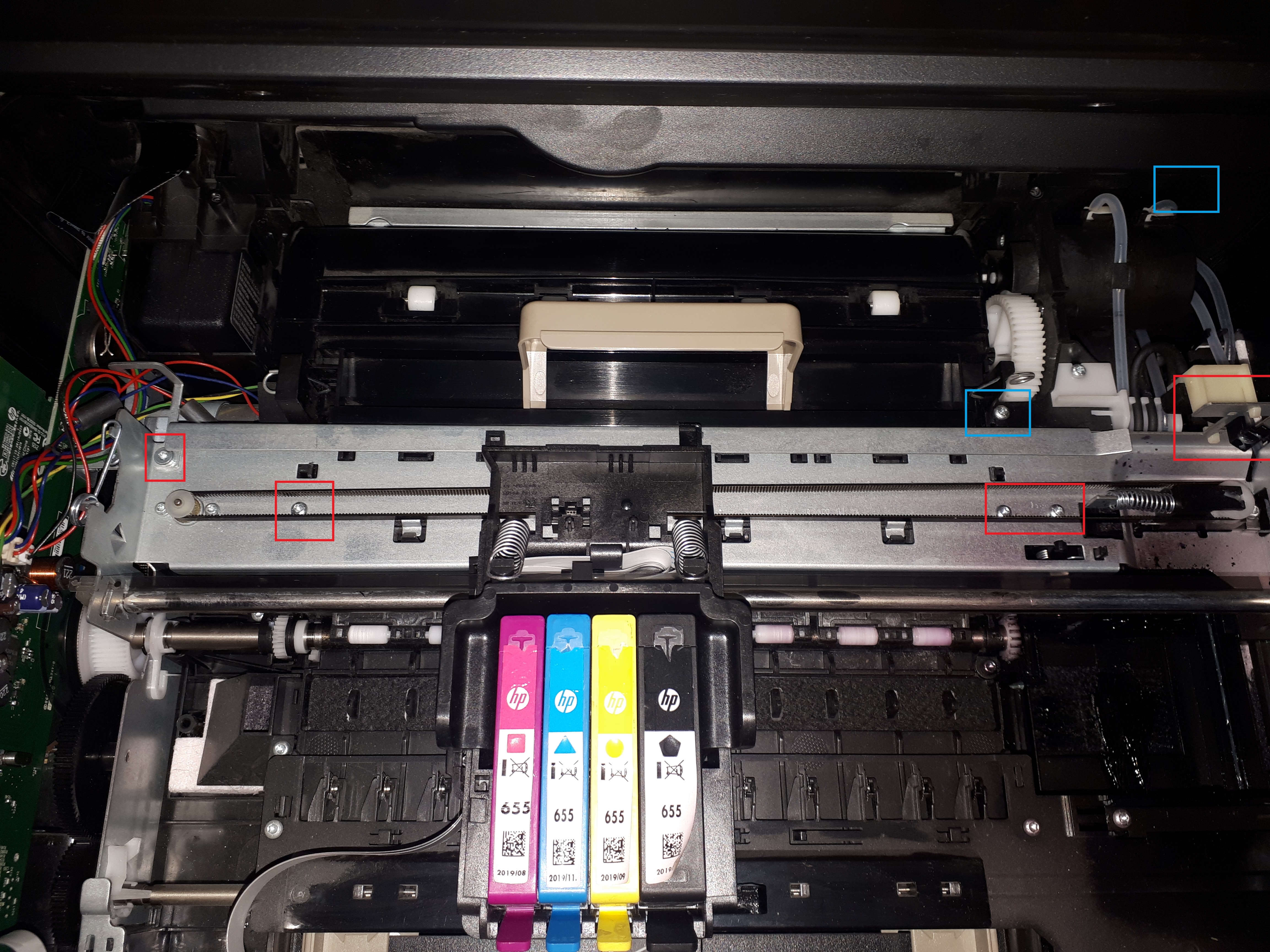

    Gentlemen, please.
    In 99% of cases, the problem is not the head but the ink suction station.
    To dismantle stations:
    1 remove the rail on which the ambulance rides (screws marked in red)
    2 disassemble the station (screws marked in blue, one is on the back in the very corner)
    When removing the station, watch out for the gears because if you tilt it to the left, 2 may fall off.

    rudy7kot
    Posts: 11
    xxl245 wrote:
    Janek_Obwarzanek wrote:
    xxl245 wrote:
    This is a standard problem in this printer, described many times on forums, and in this case, taking the head out and soaking it in cleaning chemicals is unlikely to help. It is normal for a drop of liquid to stand on top.
    Personally, I always put a syringe with a tube that fits into the ink slot in the head and inject a little under pressure. This procedure always helps me.
    However, if you want to pull out the heads, you must:
    -dismantle the plastic (in the photo it is brown, you probably have black)
    - detach the 2 springs at the back of the head
    - tilt the heads and unhook the 2 tapes that are on the back of the head (1 wide, 1 narrow)
    This video shows how to disassemble the head, it applies to a different model, but from 3min 45s it is the same as yours
    https://www.youtube.com/watch?v=C_TT1ztII94
    I confirm, it is best to unblock the head with a special liquid without removing it. Preferably a syringe with a tip that matches the strainer in the ambulance. Put a piece of folded paper towel under the head. After injecting the liquid (5-10ml), the ink will flow from the head onto the towel and it is best to let the head lie on the wet towel for a few hours. The fluid should enter the head without resistance. If you feel a lot of resistance, it means that the head is very seized. As after 2-3 such attempts to unblock it, it will still not give black on a piece of paper, you can remove the head and soak it in this liquid for several hours. Only before reinstalling, let the head dry, paying attention to the electronics so that it is not damp somewhere, because it is a small short-circuit and the head is over.
    Gentlemen, please.
    -dismantle the rail on which the ambulance rides (marked in red)
    - disassemble the station (marked in blue, one is at the back in the very corner)
    Thanks a lot for the advice. Tomorrow I will pick it up from the morning, as soon as I buy a syringe and liquid. What kind of liquid is it supposed to be? Earlier you wrote something about the liquid from the W5 lid to the windows. Such?
    Instructions for disassembling the station and colors apply to the video from the link or earlier photos?

    I already put a photo in a previous message.

    There were piles everywhere in the black ink absorber. They looked like black plasticine. The color hoses have been rinsed. The black tubing was so dry that the liquid could not be blocked. Stuffing with a straightened paperclip helped.
    It's good to take everything out of the printer and take it apart. Everything will be different. Rather, the hoses need to be removed from the pump.
    The felt on the right (ink scrap space) was packed. I didn't have a replacement, so I rinsed well, dried it and put it back in.
    Thanks for the tips :D
The discussion revolves around the HP Deskjet Ink Advantage 3525 printer, specifically addressing issues related to the removal of the print head and troubleshooting black ink printing problems. Users share their experiences with clogged print heads and ink suction stations, suggesting various methods for cleaning and disassembly. Common solutions include using syringes to inject cleaning solutions, disassembling the ink suction station, and checking for blockages in hoses and connectors. Several users emphasize that the problem often lies not with the print head itself but with the ink suction station, which can become clogged over time, especially if the printer is infrequently used. Instructions for disassembling the printer and cleaning components are provided, along with links to instructional videos.
