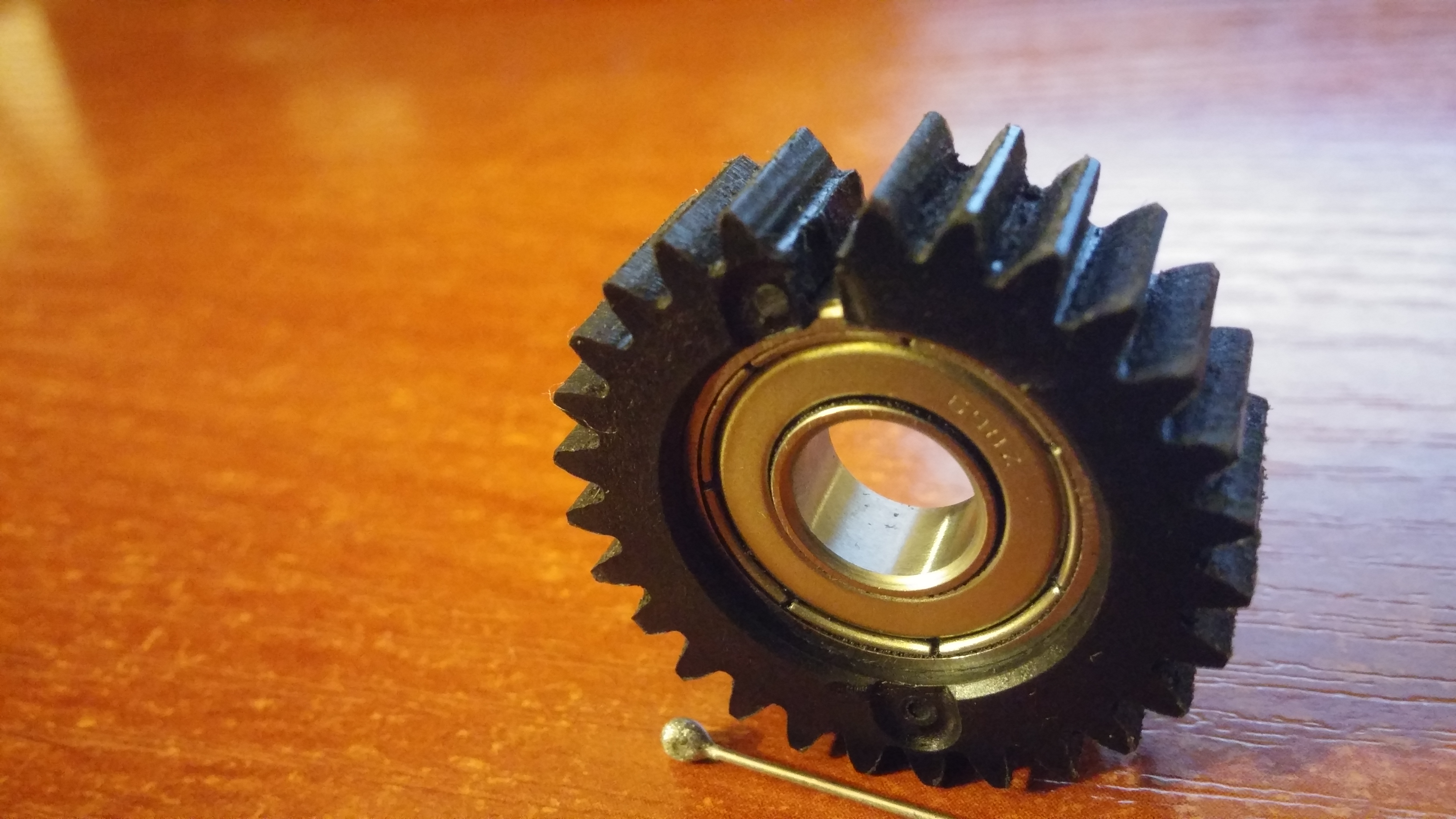

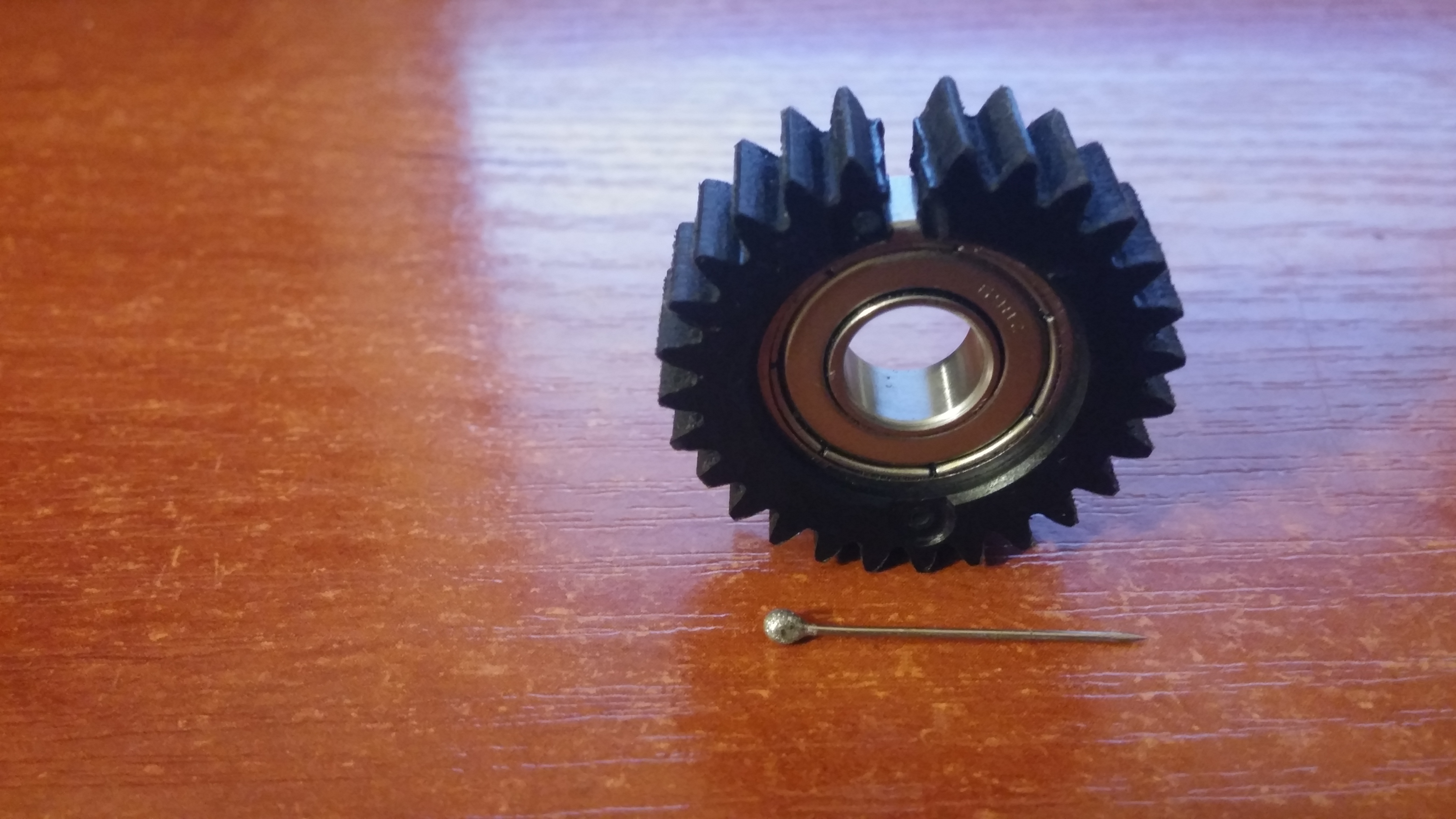

    Colleagues I am looking for some way to glue the rack from the printer.
    I need help to determine together with you what kind of material it is and what glue to use ???
    Plastic breakthrough - the crack is dull and rough
    It is a gear that works - it transfers the drive between two rollers in the printer, so the teeth are subjected to a ring force (stretching) the plastic ring with the teeth.
    In addition, there is a metal bearing inside which presses against the plastic ring, which increases the gap to 2-3mm. Even squeezing the plastic ring (rack) on the bearing will not ensure the gap will disappear (although originally there was no gap). If I remove the bearing, of course the ring gives up and after squeezing there is no gap.
    Initially, I planned to glue the ring without the bearing with epoxy glue, eg DISTAL. Later, after the adhesive has bonded, grind the ring with the teeth from the inside to freely insert the bearing previously smeared with glue from the outside so that it sticks to the plastic ring with teeth.
    However, it seems to me that DISTAL glue is average and I would prefer to use something better because it is known that the first glue is the best and I would not like to glue the same several times.
    • Best Adhesive for Small Plastic Parts: Cyanoacrylate Alternatives & Precise Gluing Techniques 20171025_234825.jpg (2.24 MB) You must be logged in to download this attachment.
    Looks like the ring is nylon. These fluff testify to this. Anyway, the strong plastic gears are only nylon.
    The only way is what I mentioned above, i.e. cyanoacrylate with activator for difficult plastics. You can also try a two-component one. See something from the Technicol offer.
    However, do not expect any miracles. Nylon is a difficult material to glue.
    Greetings!
