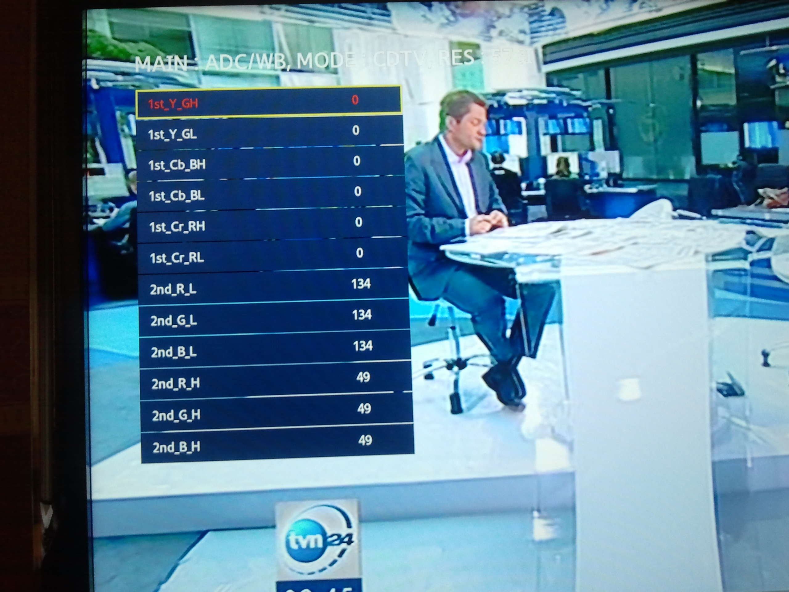

    Hello, of course I know that the better is the enemy of the good, but a wise Pole after the damage. Well, I rummaged in the service menu of my Samsung and the tuner entered the test image mode, it is very dark and tonally flattened. Adjusting the image settings does nothing. So to fix it, I was rummaging around again, as a result I have no channels at all, it scans but doesn't find it. Does anyone have the correct, standard settings of the service menu values written down one by one? (restore the factory settings does not give anything) ... Please just spare any remarks such as "it was not to fumble" because I already used to myself enough for stupidity). Maybe someone would give photos of individual menu screens? I would be very grateful.

    Thank you. My problem is that deregulation of the image can not be improved by simple options. The image is very contrasty and dark. He became so after running the test in service mode ADC / WB> ADC> AV Calibration which always ends without success.

    It is true that I have a UE32D5500 TV set, but apart from the size of the matrix, there is no difference between it and the UE40D5500. Here are the screens from MS (also the advanced ones - after entering via "ruSamsungTVCommunicator"):
    "Simple" Service Menu:
    Samsung UE40D5500: Service Menu Standard Settings, Tuner Test Image, Channel Scanning Issues Samsung UE40D5500: Service Menu Standard Settings, Tuner Test Image, Channel Scanning Issues Samsung UE40D5500: Service Menu Standard Settings, Tuner Test Image, Channel Scanning Issues Samsung UE40D5500: Service Menu Standard Settings, Tuner Test Image, Channel Scanning Issues Samsung UE40D5500: Service Menu Standard Settings, Tuner Test Image, Channel Scanning Issues Samsung UE40D5500: Service Menu Standard Settings, Tuner Test Image, Channel Scanning Issues Samsung UE40D5500: Service Menu Standard Settings, Tuner Test Image, Channel Scanning Issues
    Advanced:
    You must remember that you make any changes to the Service Menu at your own risk, and their incorrect setting may cause irreparable damage to the TV set.
    Regards
  • #5 11122935
    wojtek.sen
    Rate: 9
    Thank you very much, you worked hard :-) I have set it up for me exactly as for you, but unfortunately no changes. This means that the color from the tuner image is still tonally very flattened and very dark. It happened after the test: service mode ADC / WB> ADC> AV, the test failed and the image crashed ... I have no idea what to do next ...

    Hello, I would like to connect to this topic and confirm that Factory reset in the Samsung LED TV Service Menu does not restore the TV to operation in Poland. Thus, warn those who wish to perform this reset.
    From my experience I will write that after the first entry into the Service Menu and minor changes to the energy saving parameters, I lost the program guide and the ability to edit / search channels. The rest worked. After Factory Reset, only Smart TV (i.e. what we have available on the network) or via additional sources works. The TV tuner does not work at all. That is, it is not possible to set, search for channels. The parameters have probably been restored to the factory settings, which, unfortunately, I suppose does not mean that they are compatible with the Polish TV band and the parameters of the terrestrial signal.

    And yet it worked ...
    After long battles and reading the forums, analyzing the screenshots, it was possible to bring the TV back to life.
    Factory Reset in my copy (UE40D6510) almost worked. It turned out that one parameter after FR is set incorrectly. Namely, "Hospitality Mode" is set to "ON" and it should be "OFF". After this change, the Tuner started working. It was required to change the language to Polish and re-tuning the channels and setting the favorite order. There is also the normal channel list, program guide and the ability to select an antenna.
