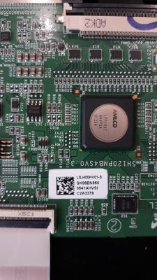

  • #6 16286170
    Stefan_25
    Posts: 30
    Rate: 8
    Thank you colleague "lotrabbartol" waiting for news and even have one more question.
    Well, one of the forum members told me to do "Factory Reset" in the "Service Menu" and it should help and unfortunately here
    nothing has changed but I noticed that this reset does not give anything except for the settings that the manufacturer has written somewhere there and are going back to its original state,
    Where are my observations from? Well, since the position in "Option - Type" is not changed there is probably a type of matrix?
    Now my question, where does this information come from? Because I changed it to a different type and it has changed that now switching the TV into 3D mode I have half the screen, ie from half to bottom and not as centimeter from below as before.
    And the matrix types 40 "in the menu are plenty, in total you could change and try but how to stop displaying the image
    that's what the gravedigger says "buried dog" unless someone knows where the settings are being held and to rip the memory contents so that the previous value can be restored.
    One more thing I am interested in is it possible to set the width and height of the displayed image on these TVs?
    As young as I learned in practice at the RTV plant, it could be changed but times have changed and TVs too :) and also man does not deal with what he has learned but nevertheless some knowledge has remained.
    You will probably ask why you want to change it, because the logo of the program n. Polsat is very close to the right edge and looking at the other, second-best TV, this stamp is much further. The same applies to the bottom of the screen, I have the impression that the picture is "wrapped up"? and whether sometimes it does not cause this confusion.
    Forgive for such a long elaborate but I deal with another part of electronics and I like how the owner will tell me as much information about the symptom as well as type, etc. then you can help and sometimes save a lot of money.

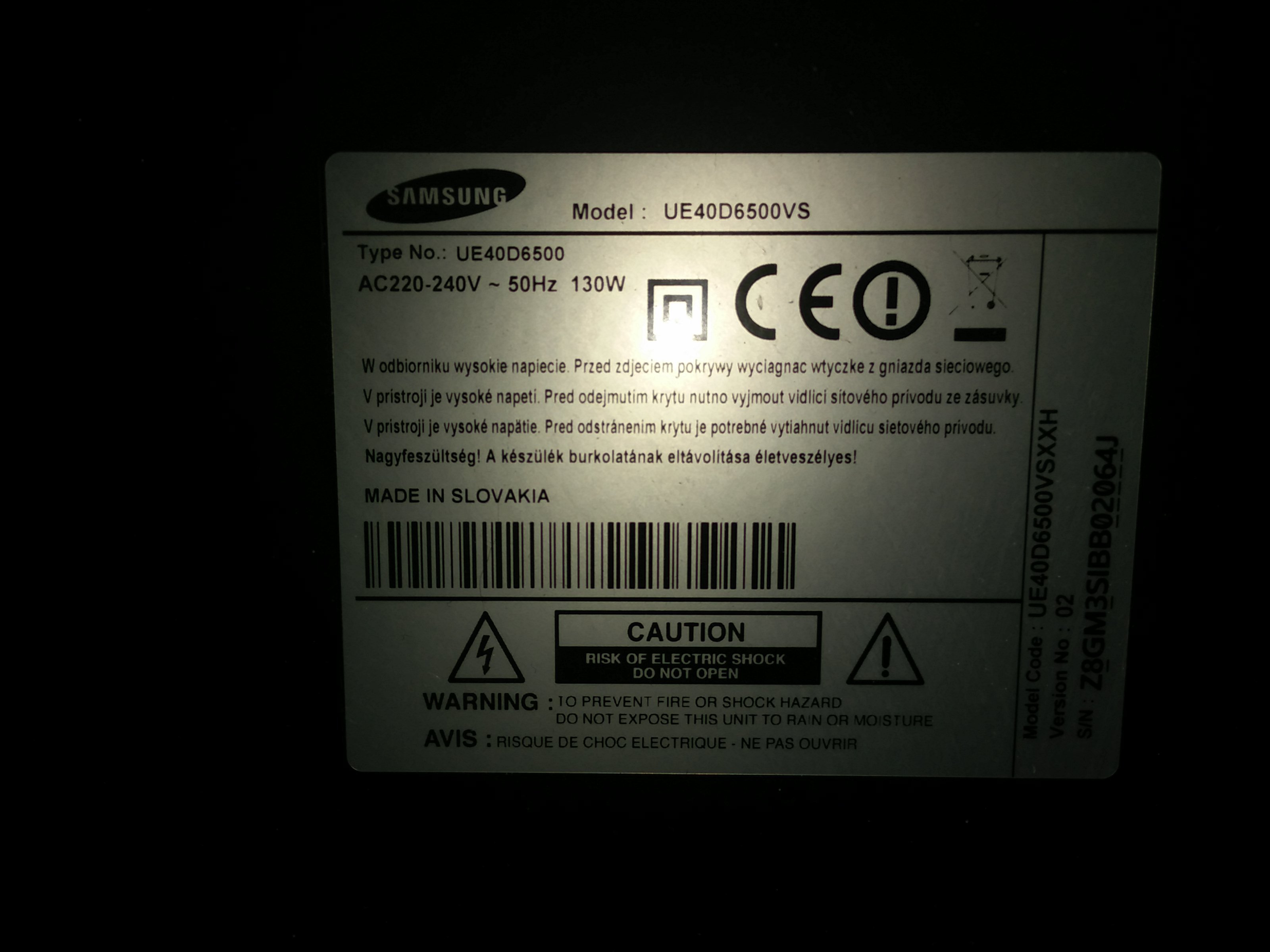

    TV data:
    TV model: UE40D6500 VS (Read from the back of the TV)
    Motherboard : UE40D6500 VSXXH (Read from the motherboard)
    Matrix: LTJ400HV01-J (Read from the matrix) Made in Slovakia
    Logic: SH120PMB4SV0.3 (Read from the module)

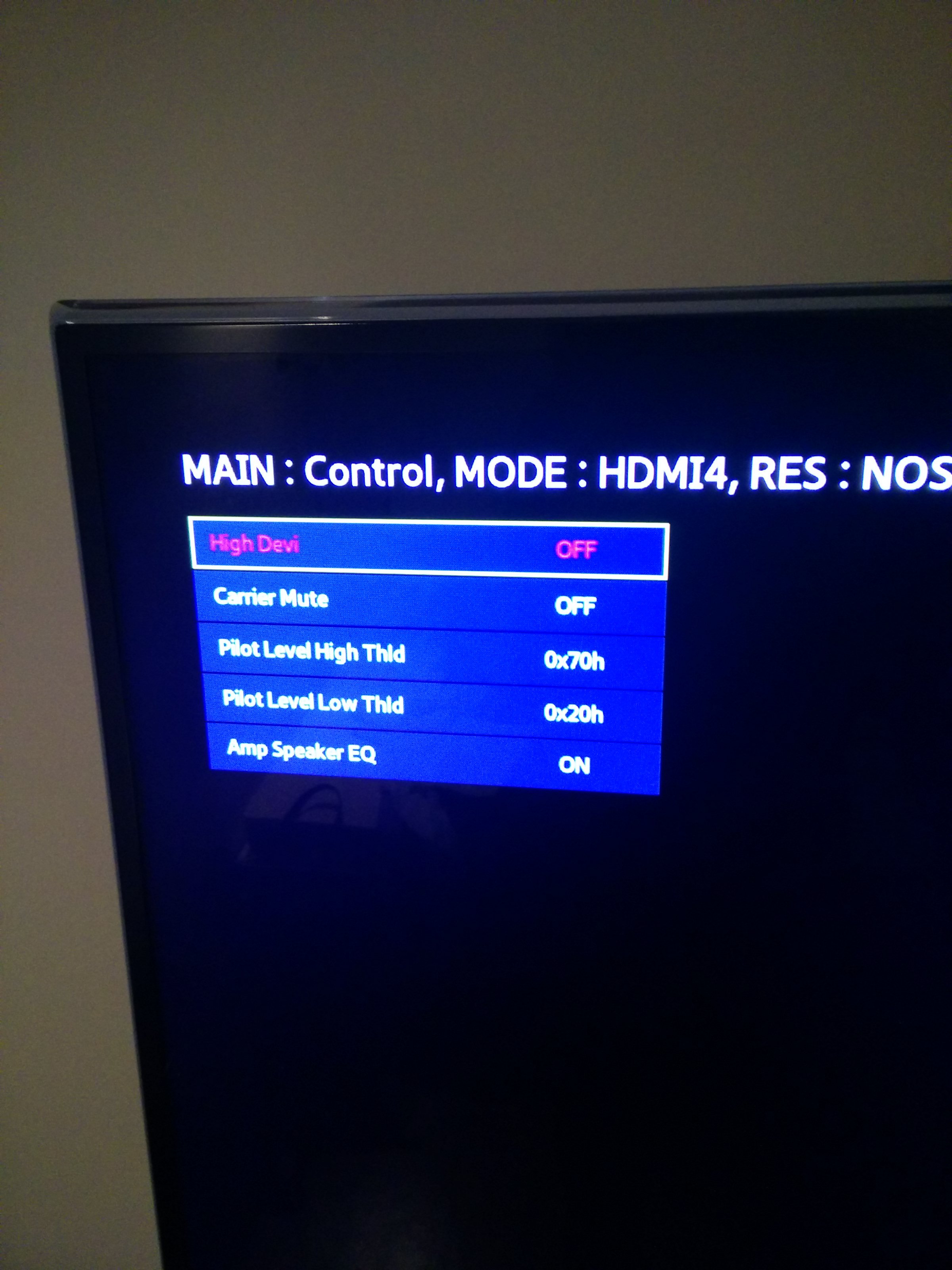

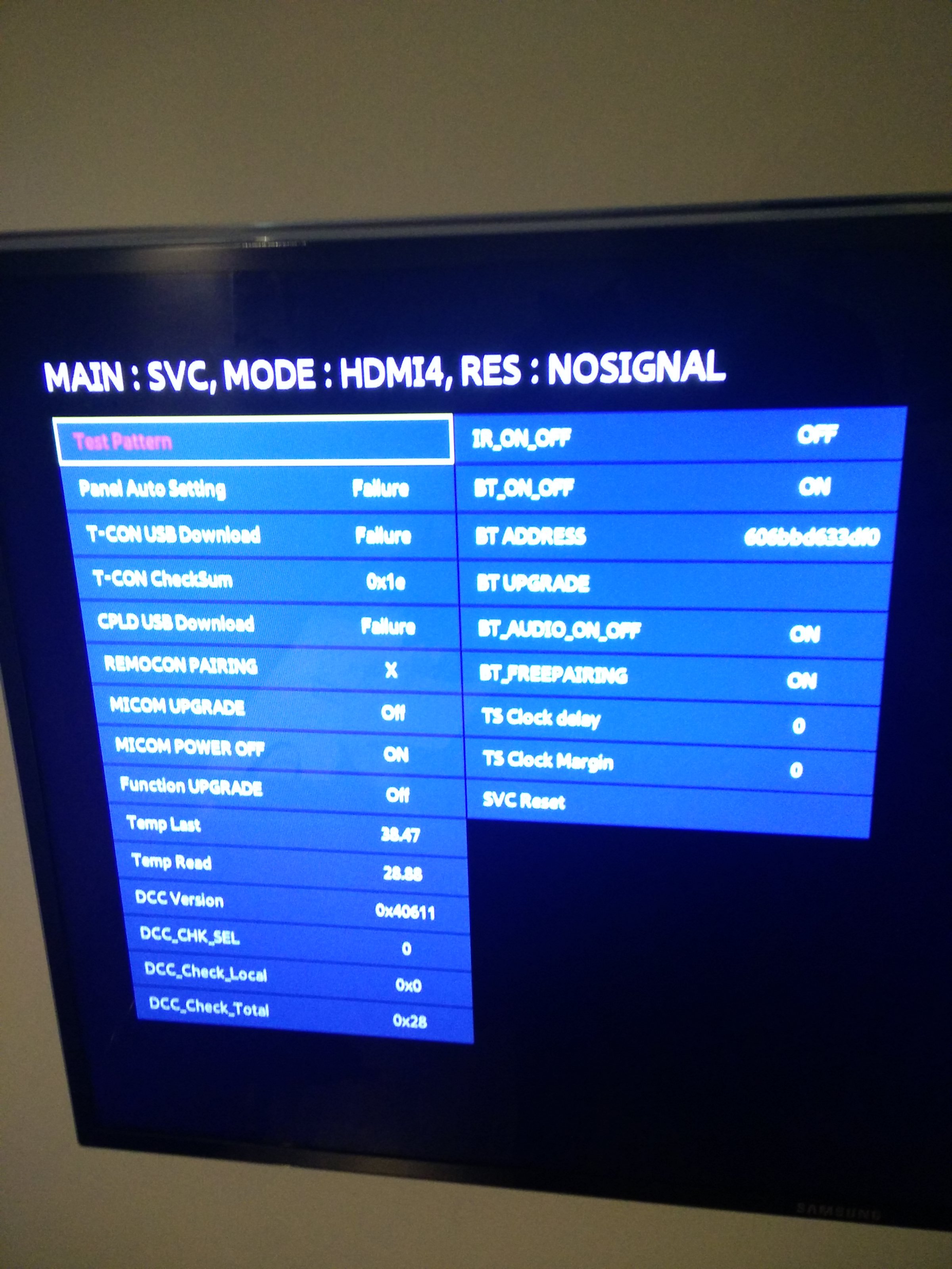

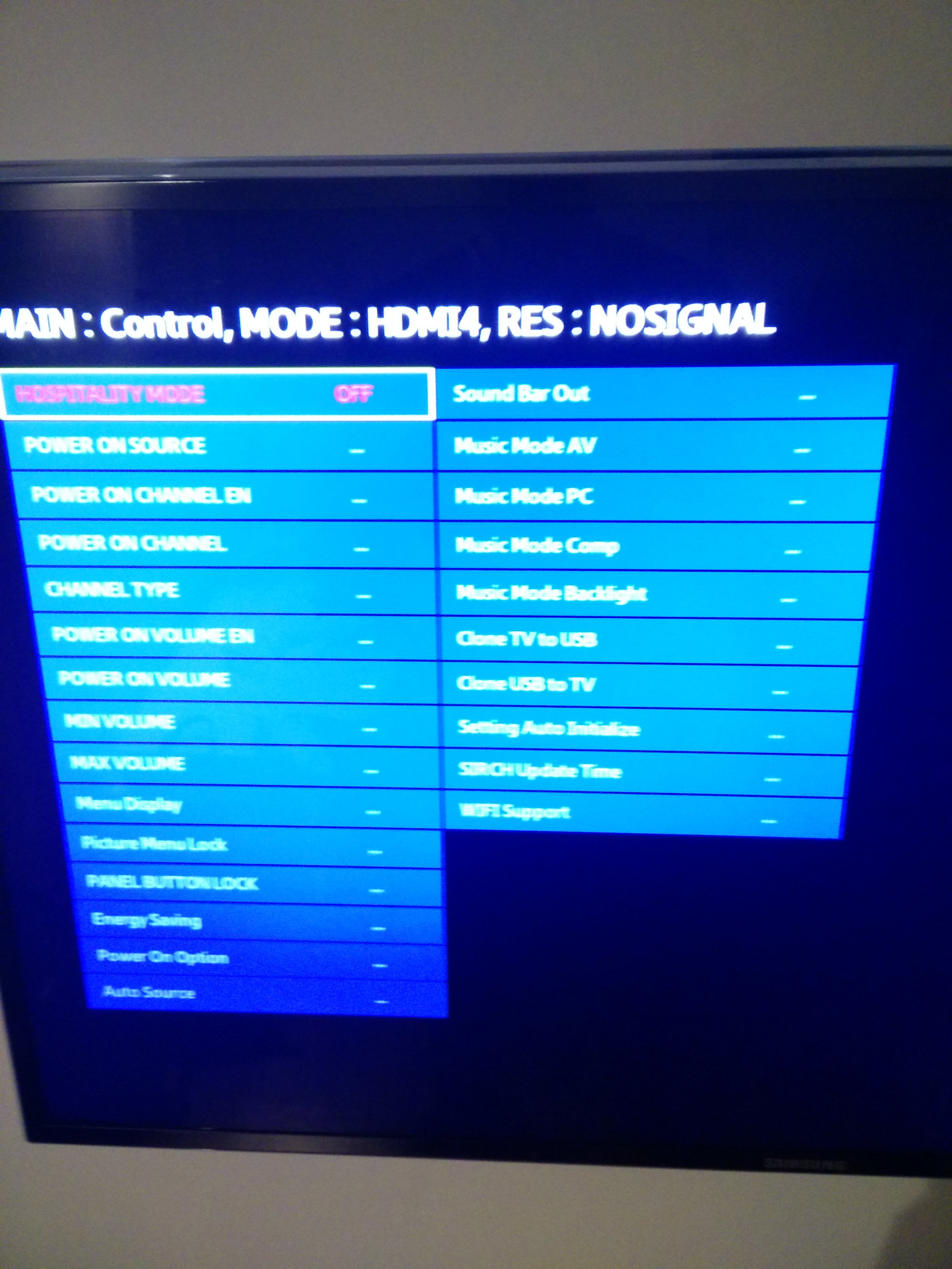

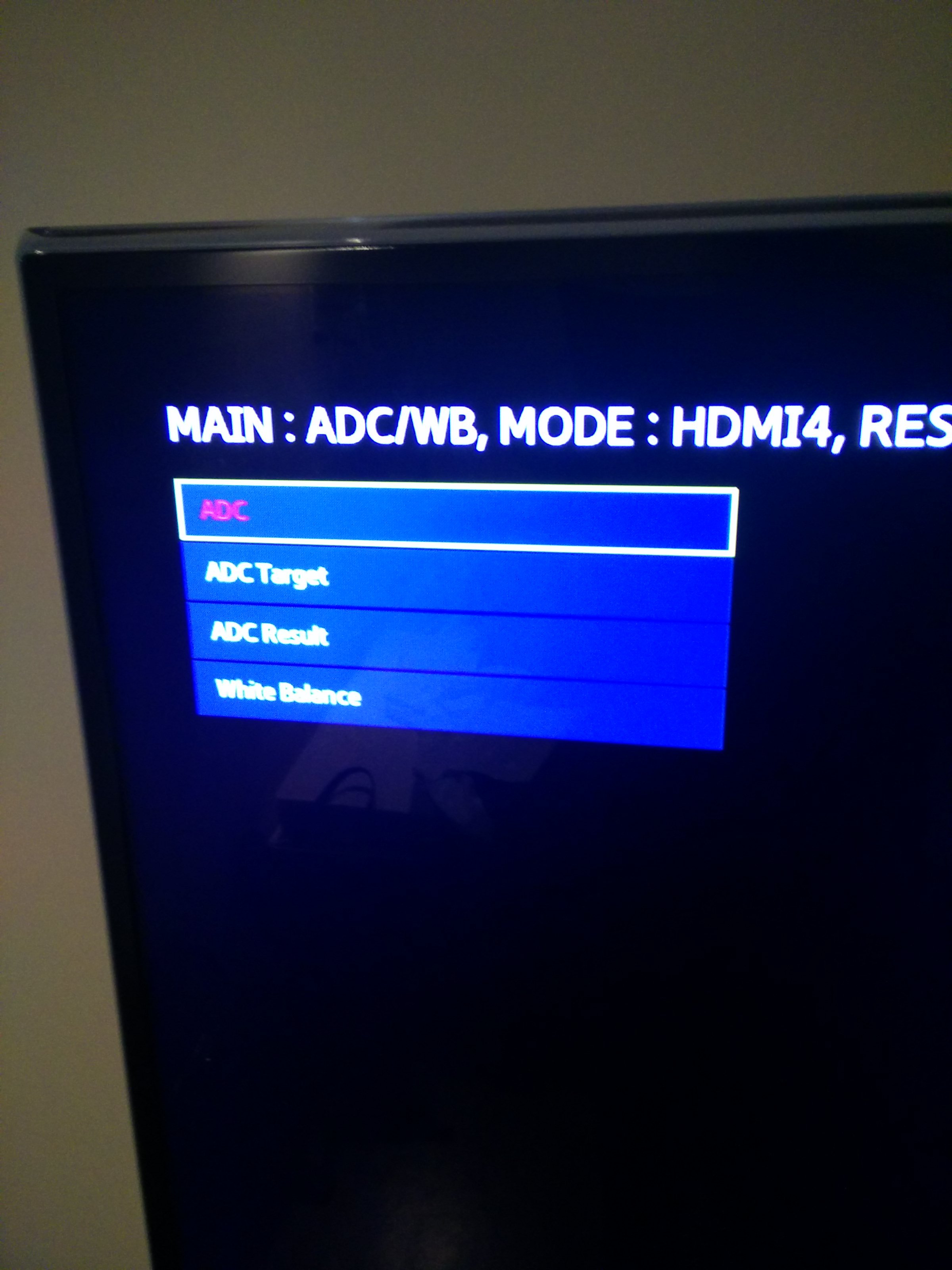

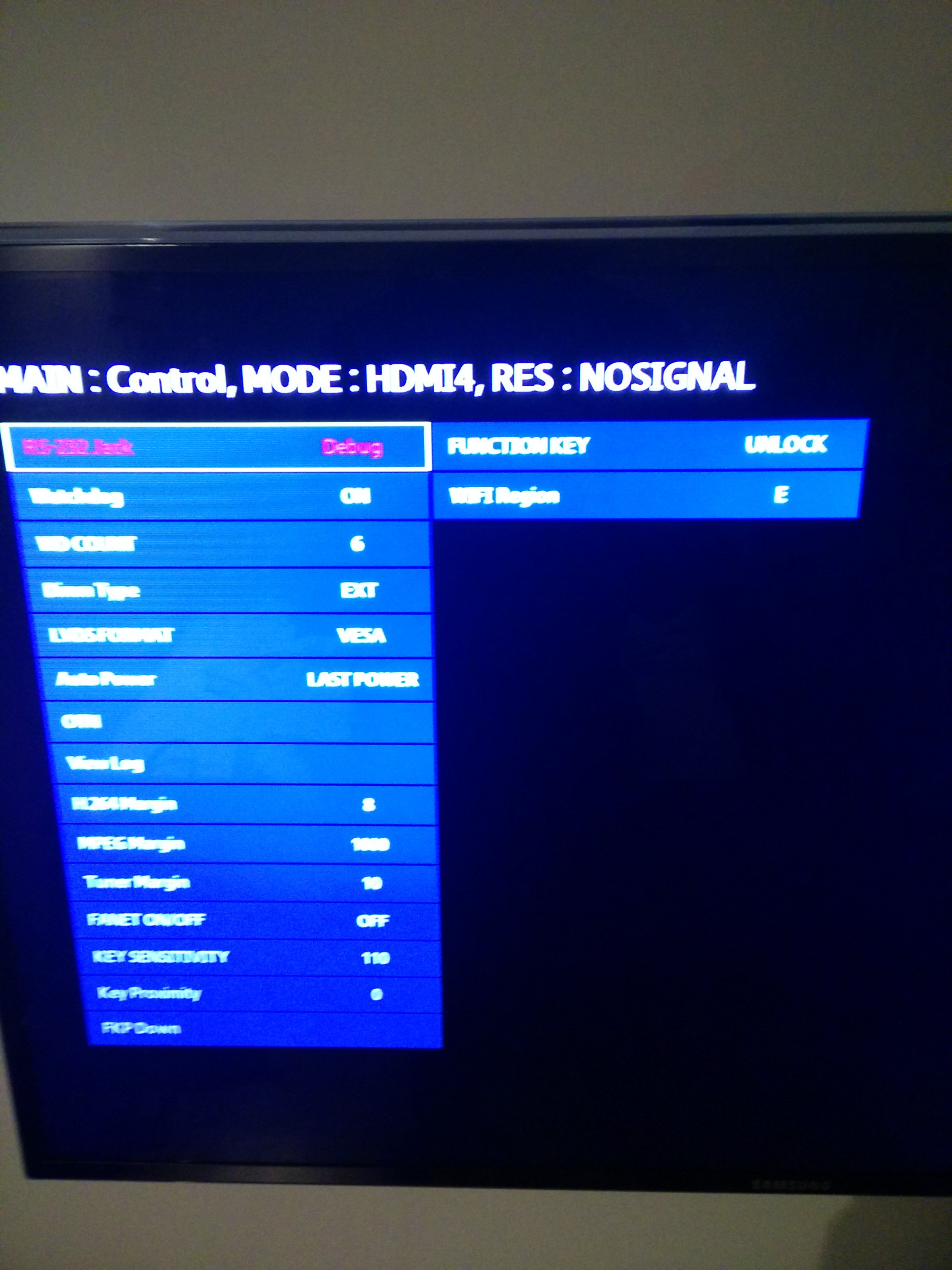

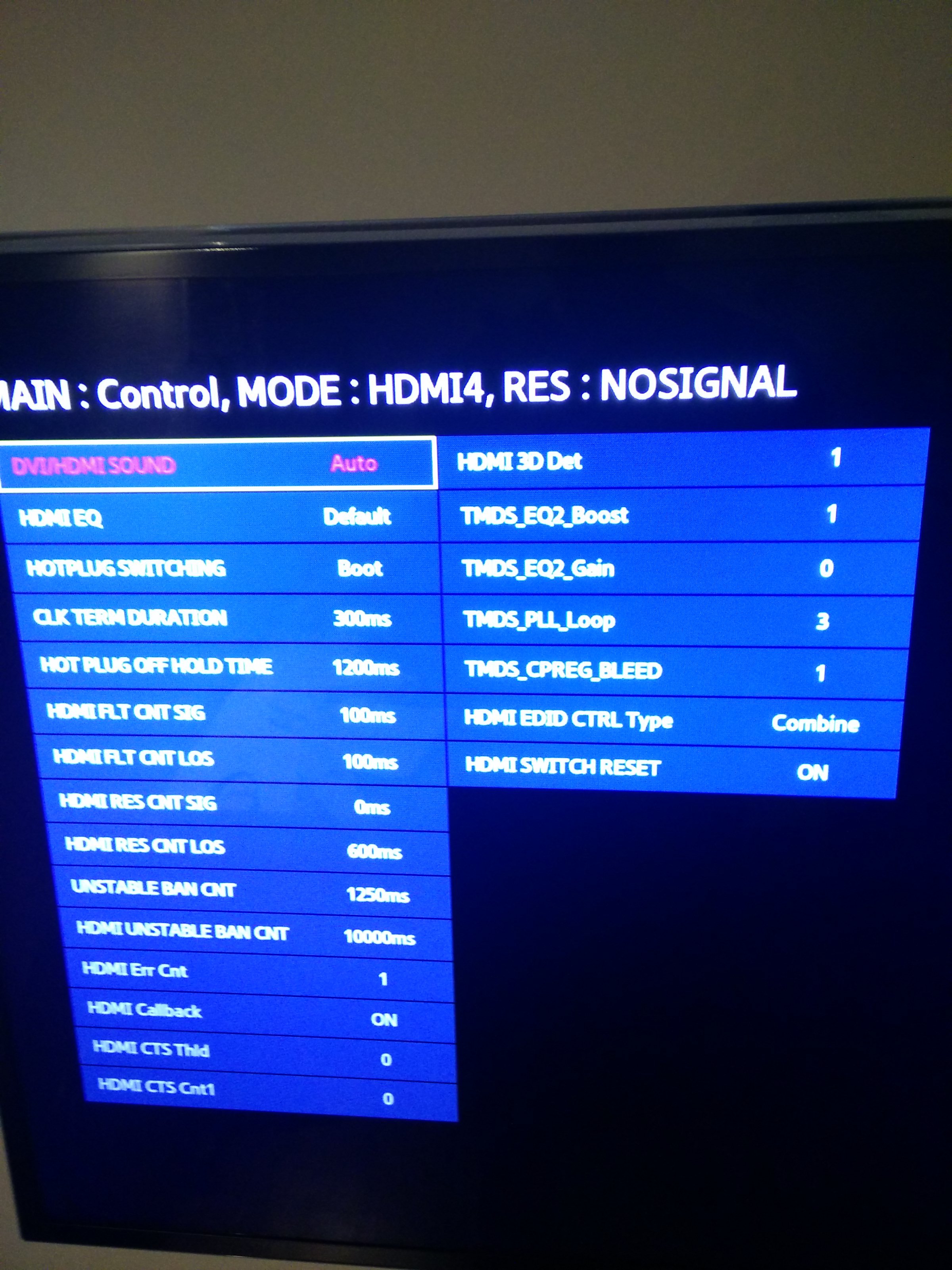

  • #7 16287050
    lotrabbartol
    Posts: 79
    Promised photos:
    Samsung UE40D6500VS TV: Horizontal Black Bars & Non-Functioning 3D Mode - T-Con or Motherboard? Samsung UE40D6500VS TV: Horizontal Black Bars & Non-Functioning 3D Mode - T-Con or Motherboard? Samsung UE40D6500VS TV: Horizontal Black Bars & Non-Functioning 3D Mode - T-Con or Motherboard? Samsung UE40D6500VS TV: Horizontal Black Bars & Non-Functioning 3D Mode - T-Con or Motherboard? Samsung UE40D6500VS TV: Horizontal Black Bars & Non-Functioning 3D Mode - T-Con or Motherboard? Samsung UE40D6500VS TV: Horizontal Black Bars & Non-Functioning 3D Mode - T-Con or Motherboard? Samsung UE40D6500VS TV: Horizontal Black Bars & Non-Functioning 3D Mode - T-Con or Motherboard? Samsung UE40D6500VS TV: Horizontal Black Bars & Non-Functioning 3D Mode - T-Con or Motherboard? Samsung UE40D6500VS TV: Horizontal Black Bars & Non-Functioning 3D Mode - T-Con or Motherboard? Samsung UE40D6500VS TV: Horizontal Black Bars & Non-Functioning 3D Mode - T-Con or Motherboard? Samsung UE40D6500VS TV: Horizontal Black Bars & Non-Functioning 3D Mode - T-Con or Motherboard? Samsung UE40D6500VS TV: Horizontal Black Bars & Non-Functioning 3D Mode - T-Con or Motherboard? Samsung UE40D6500VS TV: Horizontal Black Bars & Non-Functioning 3D Mode - T-Con or Motherboard?

    Budy "lotrabbartol" write what is the exact type of this TV set?
    I am asking because I have completely different settings, matrix, TV tuner, etc. and I will say that I have slight concerns about changing the settings to wake up later.
  • #9 16291354
    lotrabbartol
    Posts: 79
    I have one Samsung UE40D6500VS TV: Horizontal Black Bars & Non-Functioning 3D Mode - T-Con or Motherboard?
  • #10 16301726
    lisek
    Service technician RTV
    Posts: 39973
    Help: 6350
    Rate: 6880
    THIS is from this forum
    link
    ... matrix in the Samsung UE40D6500.
    From what I read on the forum, the matrices with the markings were inserted into them:
    40A1UF4E, 40A1UF6E, 40A1UF7E.
    I recommend the SamyGo forum
    link
    * or similar link
    40A1UF4E (D6000)
    40A1UF7E (D6500 D6530 D6755 D6510!)
    40A1UF6E (D6500)
    40P1UF6E (D6515 D6510! D6750 D6530)
    40P1UF3E (D6200 D6325 (D6000))
    40A2UF8E (D8005)
    UE40D6500vsXXH ver 02
    Slovakia
    matrix: 40A1UF7E
    UE40D6530WS - Slovakia - Version No: 02 - 40A1UF7E - Samsung Type-S-PVA
    UE40D6500WS - Slovakia - Version No: 02 - 40A1UF7E - Samsung Type-S-PVA
    UE40D6100SW - Russia-CN01-> Version No: 01 - LD400CGC-C2, CLL6CC5,10 BITS, 40-CHILIN (CMI) Type-S-MVA
    UE40D6100SW - Russia-HQ03-> Version No: 03 - 6K 40 3D_LTJ400HV03-V, LCD Ce-Samsung S-PVA
    UE40D6000- -> Version No: 01-40P1UE3E - CHILIN (CMI) -Type-S-MVA
    UE40D5500RW-Slovakia -> Version No: 03 - 40A6UFOE-Samsung S-PVA
    UE40D5000PW-Russia-CN01-> Version No: 01 - LD400BGC-C1, CLL6BC2,8 BITS, 40-CHILIN (CMI) -Type-S-MVA
    UE40D5000PW - Version No: - 40H6UF0E - LD400BGD-V1 or LD400BGD-V2,8biT-CHILIN (CMI) -Type-S-MVA
    UE40ES6200 -> type: 40A1AF6E

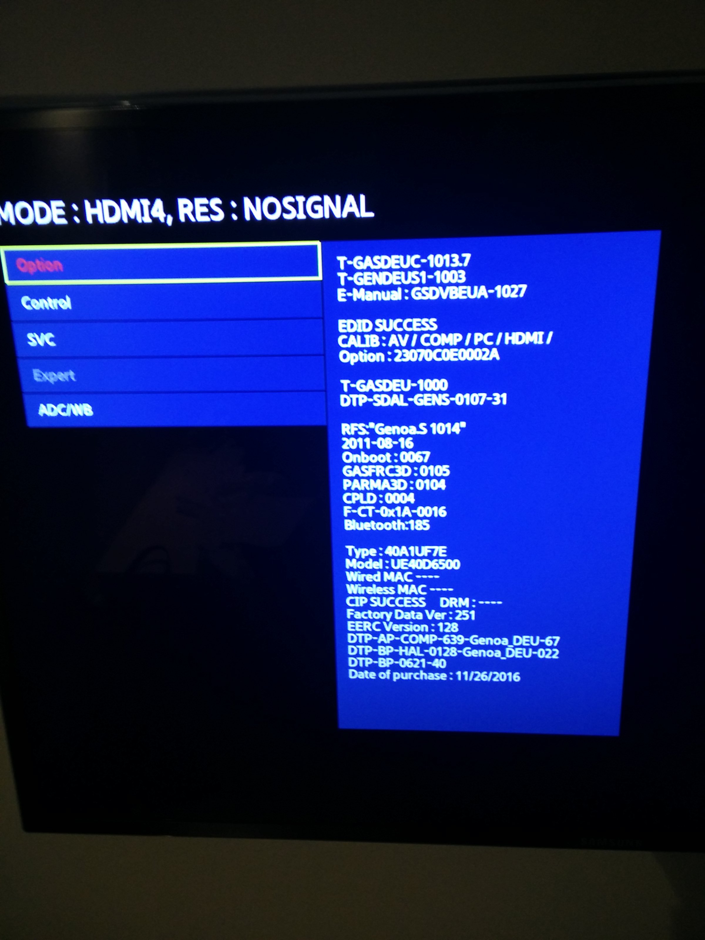

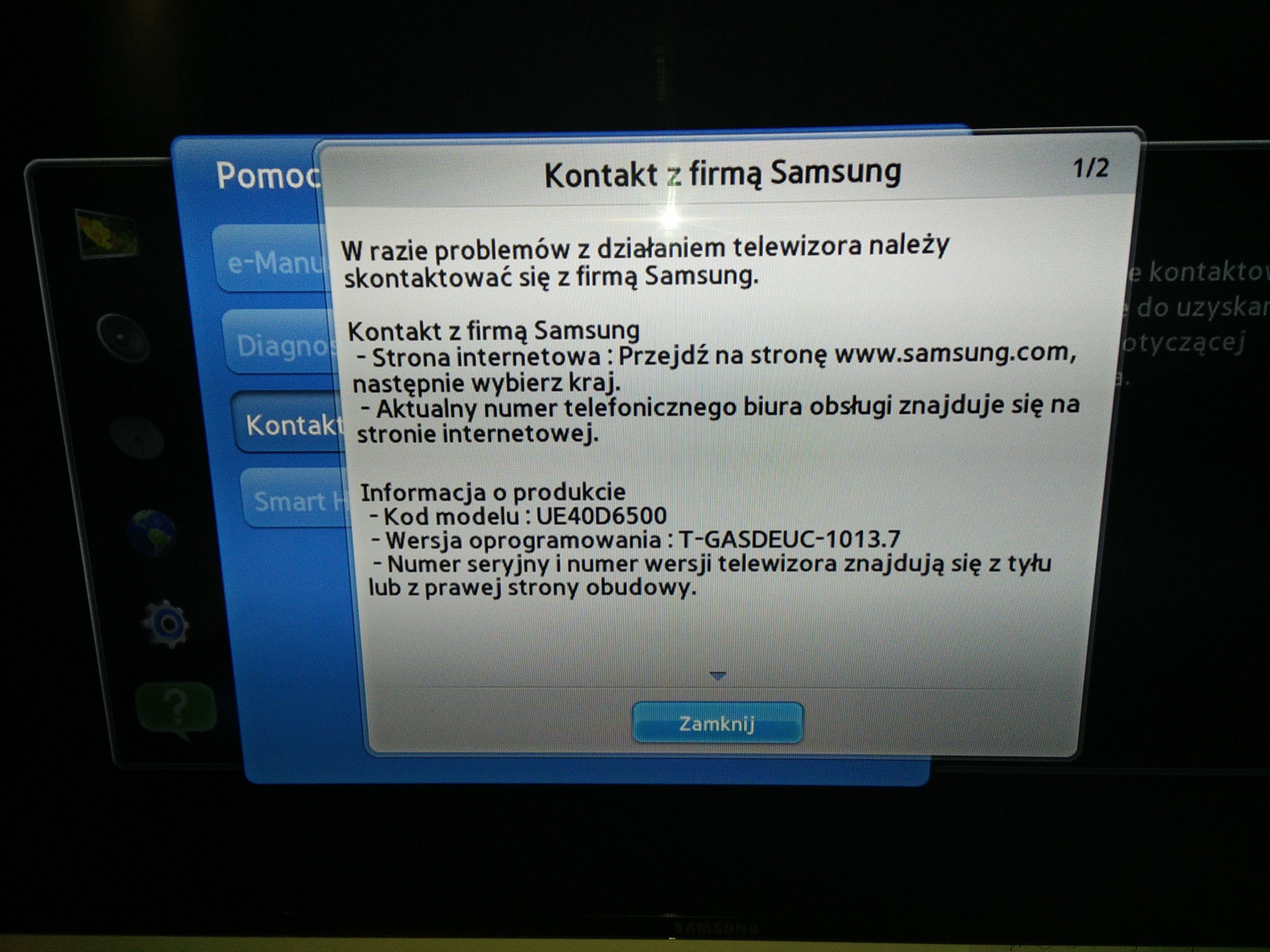

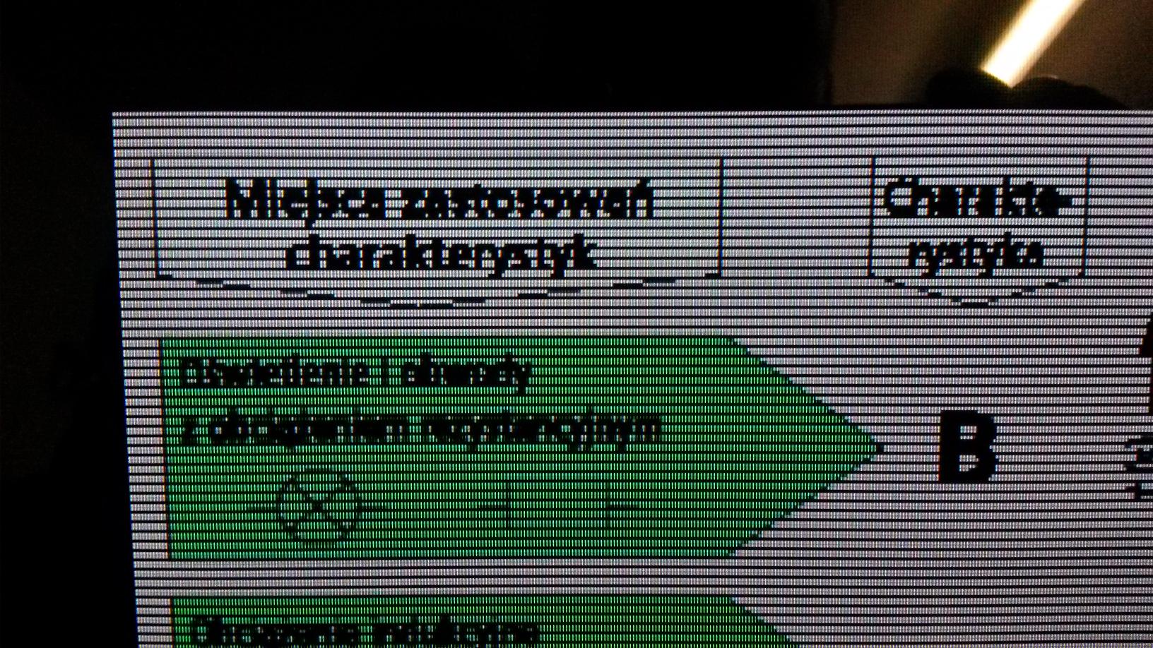

  • #11 17297970
    Rafi_bydgoszcz
    Posts: 41
    I have a similar problem with Samsung UE40D6500.
    The pictures below can suggest something.
    I exchanged T-Con, but it did not help.
    Under the LINK of the service https://pl.scribd.com/document/355891392/samsung-panel-repair-v1-7 is a description of the matrix error, but it's not what I have.
    After removing the left or right FFC tape, the image is the same.
    Thanks in advance for your suggestions.
