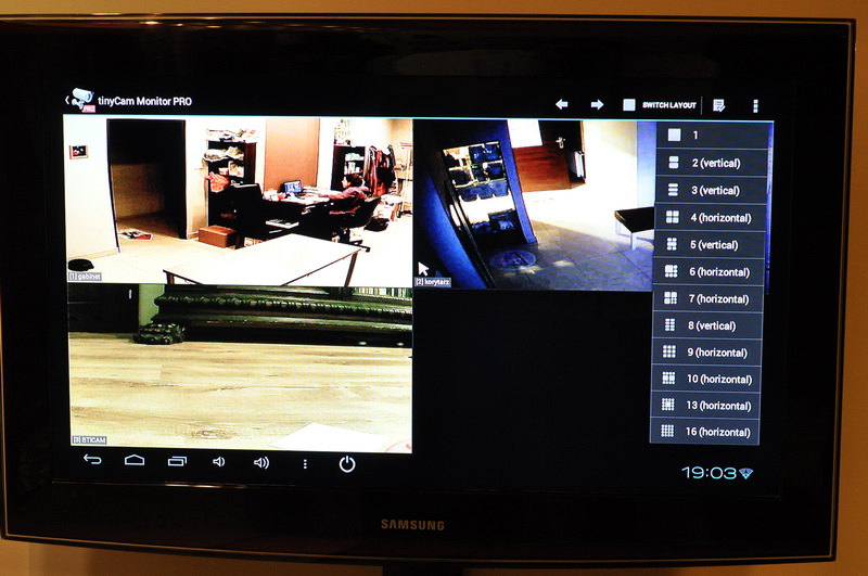

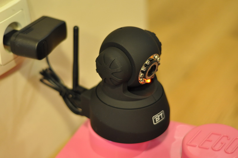

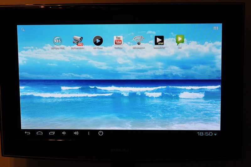

    I use BTICAM IP cameras, and for viewing on the TV I use the nanopc app http://nanopc.pl on Android.
    The TV doesn’t need to be a smart TV (it doesn’t need a LAN port); it just needs to have an HDMI input.

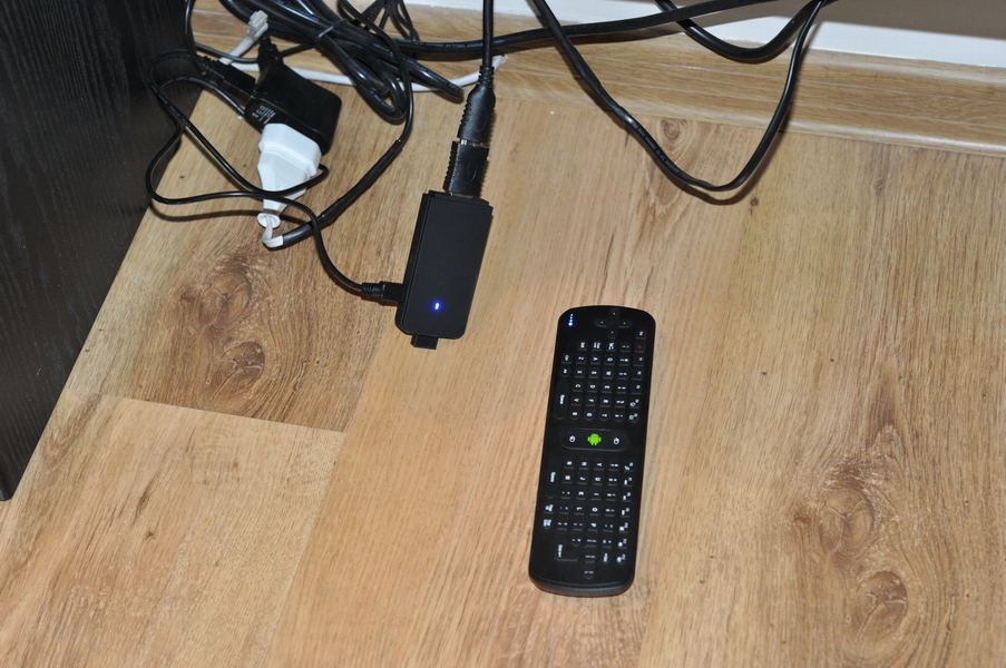

    You connect the nanopc (a micro Android computer the size of a USB stick) to the TV’s HDMI port; power is supplied via a 5V power supply, or if your TV has a USB port with at least 500mA, you can power the nanopc directly from the TV.

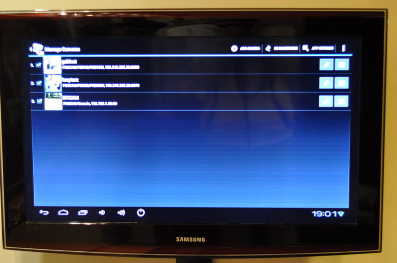

    Install http://www.tinycammonitor.com – the FREE option does not include recording.
    You control it normally using the remote control (the so-called ‘AIR mouse’); a cursor appears on the TV screen and moves in response to your hand movements. The nanopc can be hidden away, as the remote control operates via radio rather than infrared.

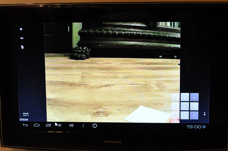

    You can view up to 16 cameras in a grid layout; you can even pan the BTICAM BT8W-IR-CUT camera directly from the TV.
    You can set the image to full screen and choose an option to cycle through the camera views.
