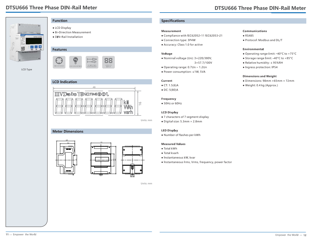

    The DTSU666 is an electronic, three-phase energy meter designed for mounting on a DIN rail within a switchboard. Thanks to its built-in RS485 interface and support for the Modbus RTU protocol, this meter is well suited to reading real-time data on voltages, currents and power, allowing for easy integration into your own projects. This is exactly what I’ll be demonstrating here, using a ready-made ESP32 board.
    The DTSU666 bidirectional, three-phase electricity meter and data retrieval via Modbus on the ESP32

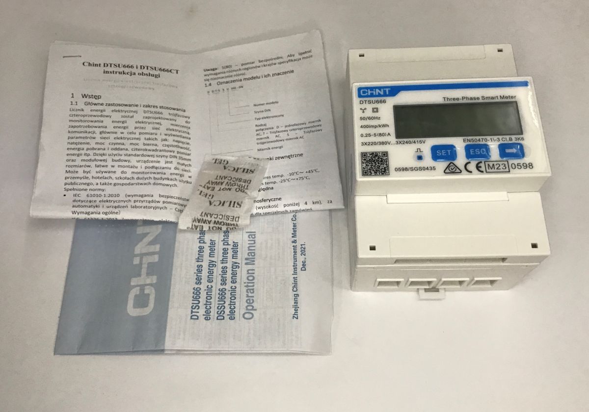

    I bought the DTSU666 from a Polish online shop for around 250 zł. The device occupies 4 standard DIN modules (72 mm wide) in a switchboard and weighs just under 400 grams. It is also fitted with a backlit LCD display, which allows you to conveniently view the current voltage, currents and energy metered on individual phases without the need for any additional apps, as well as to configure Modbus. The pack also included a Polish-language manual.
    The DTSU666 bidirectional, three-phase electricity meter and data retrieval via Modbus on the ESP32 The DTSU666 bidirectional, three-phase electricity meter and data retrieval via Modbus on the ESP32 The DTSU666 bidirectional, three-phase electricity meter and data retrieval via Modbus on the ESP32

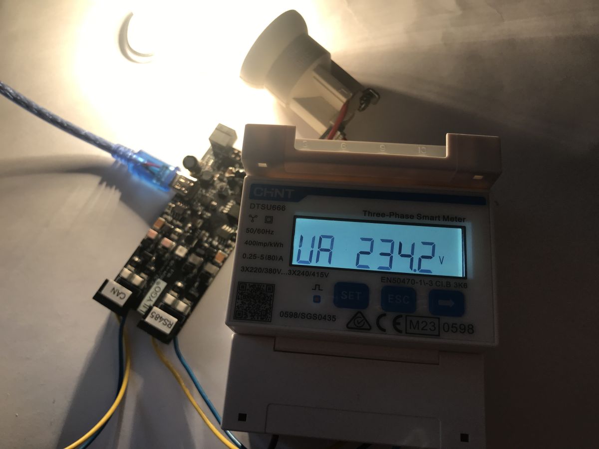

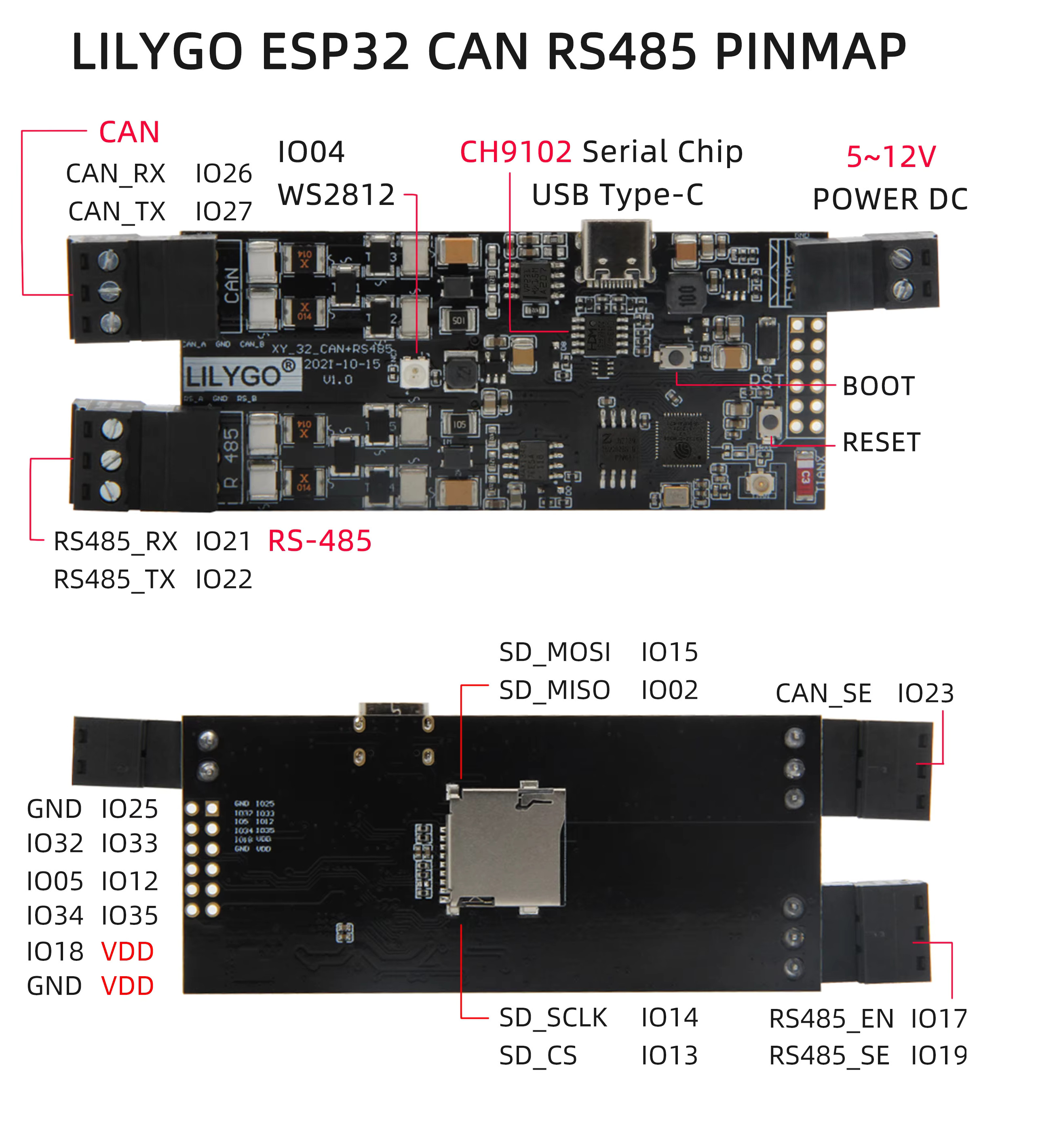

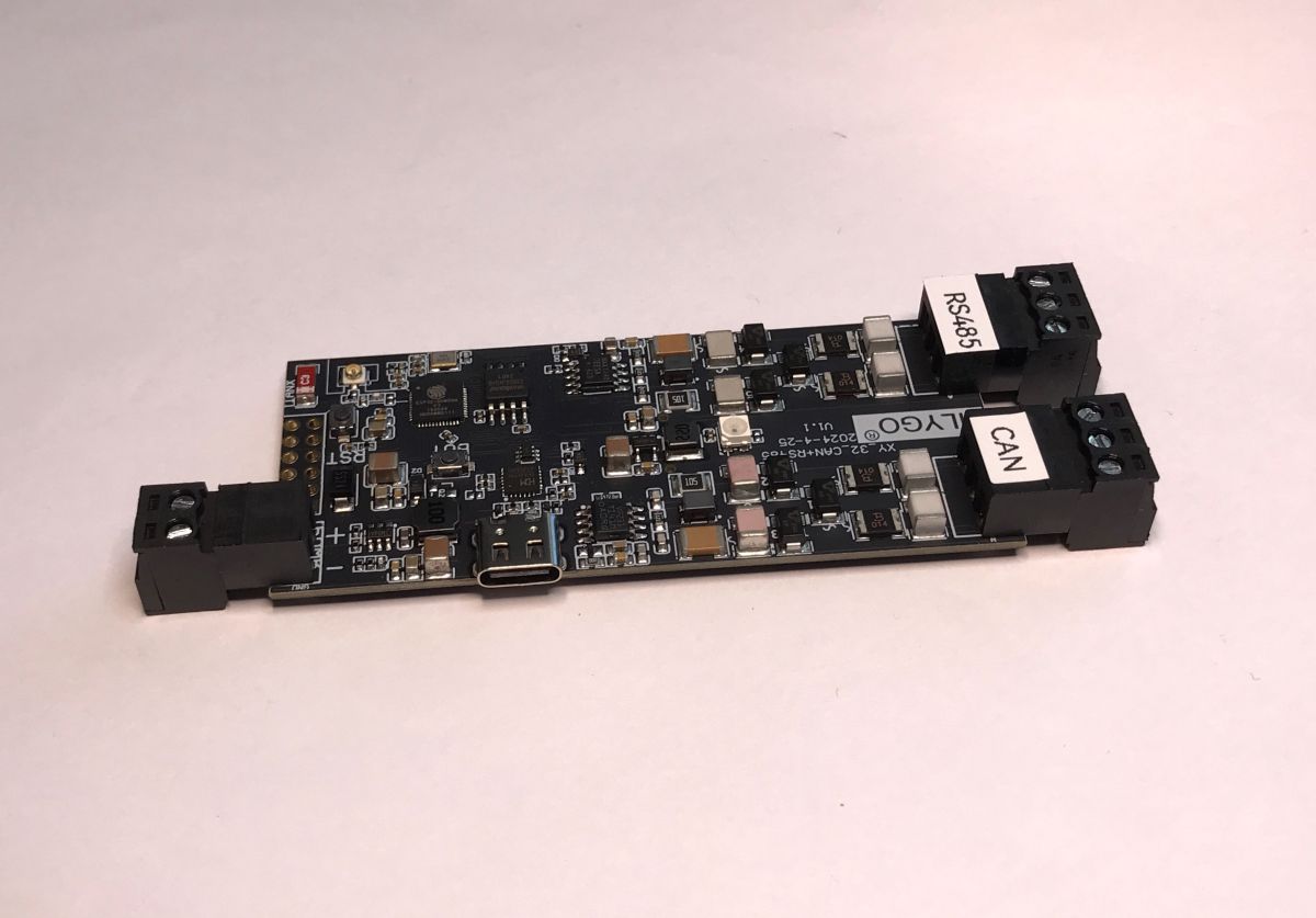

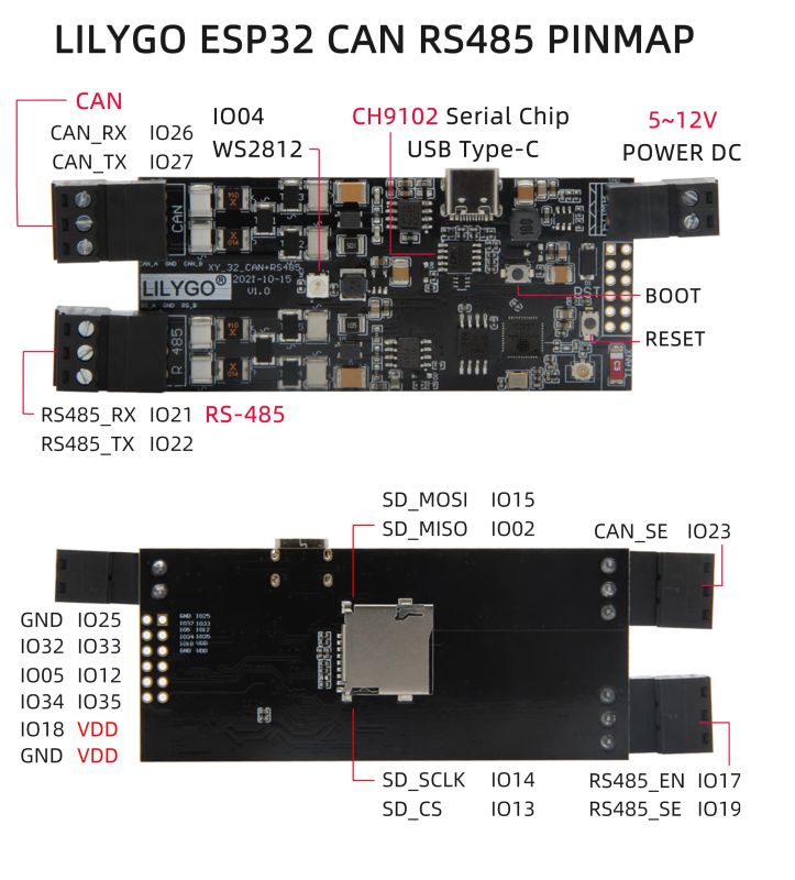

    Connecting the DTSU666 is fairly straightforward – even the sticker on the side lists the pins, including the RS485 port and the pulse output.
    The RS485 port is used here for communication via the Modbus RTU protocol, which is widely used in industry. RS485 itself is merely a physical layer based on a differential signal, providing high resistance to interference and ranges of hundreds of metres. From the microcontroller’s perspective, it is handled in exactly the same way as a standard UART serial port (RX and TX pins); however, the signal is not directly compatible. To bring it all together, you need a suitable hardware converter (e.g. based on the popular MAX485 chip) or a ready-made board that already has such a transceiver built in. Here, I decided to use the previously featured LilyGO T-CAN485 – an ESP32 for learning industrial communication, RS485 and CAN buses .
    LilyGO T-CAN485 board with ESP32 and RS485, CAN connectors, USB-C port
    We simply connect pin A to A and pin B to B. We do not ‘cross-connect’ (from RX to TX) as with UART, because RS485 is a bus to which we can connect multiple devices in parallel. Communication is managed by a single master device – in this case, our ESP32, which polls the rest of the network. The other devices are known as slaves (in this case, the DTSU666 meter), which simply listen and respond to commands from the master. For longer cables, it is also worth remembering to connect a terminating resistor (usually 120 Ω) at both ends of the bus, which will prevent signal reflections.

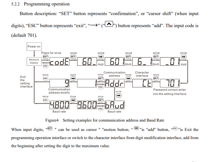

    RS485 can operate with various port and baud rate settings, whilst Modbus supports various slave IDs. These settings must match between the meter and the firmware. On the meter, they can be changed via the UI:

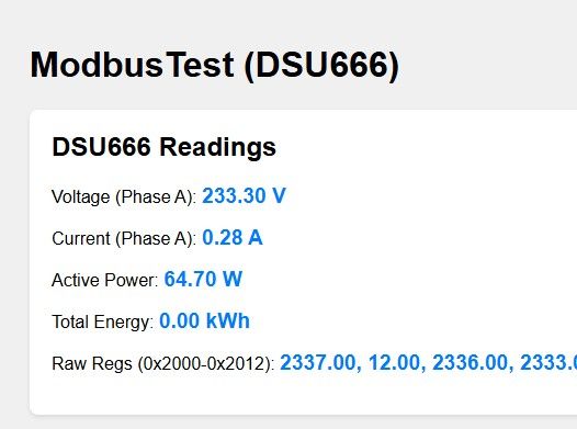

    With the library now added to the project, querying the meter is essentially just a matter of calling a single function. Below is a short code snippet showing how to read the 32-bit voltage value for phase L1 (address 0x2006). Please note that after a successful read, we need to combine two 16-bit registers into a single
    float
    and divide the result by 10 – exactly as required by the manufacturer’s documentation.
    Code: C / C++
    The whole process during testing:
    Results on the web:

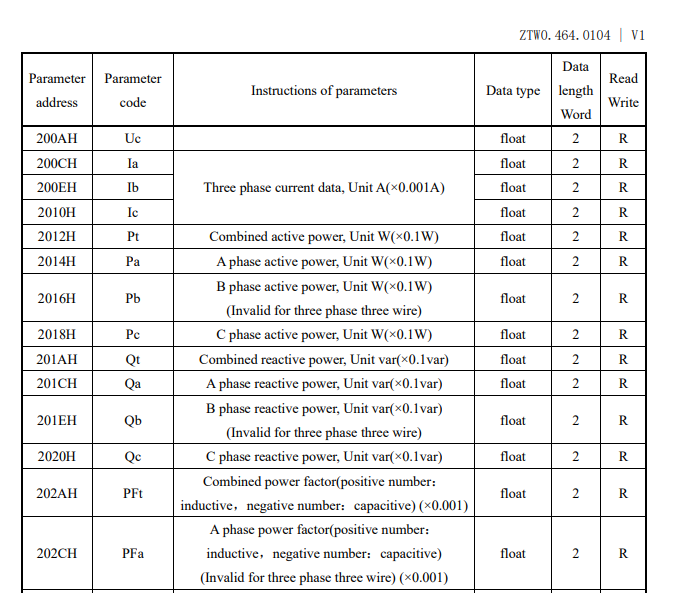

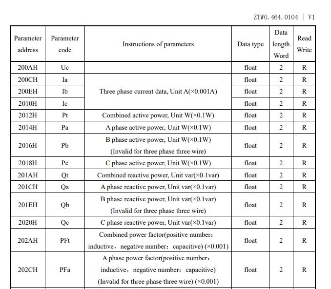

    In the same way, you can access other values from the documentation, such as phase current (from 0x200C), total active power (0x2012), power factor (0x202A), total energy consumed and supplied (from 0x101E) or even the mains frequency (0x2044).
    Full register table:

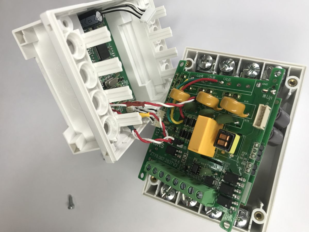

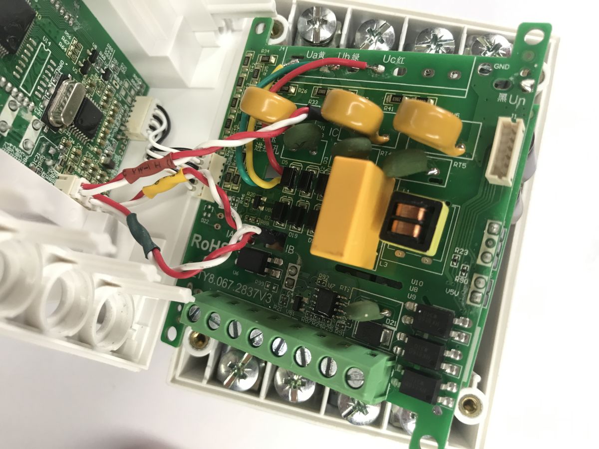

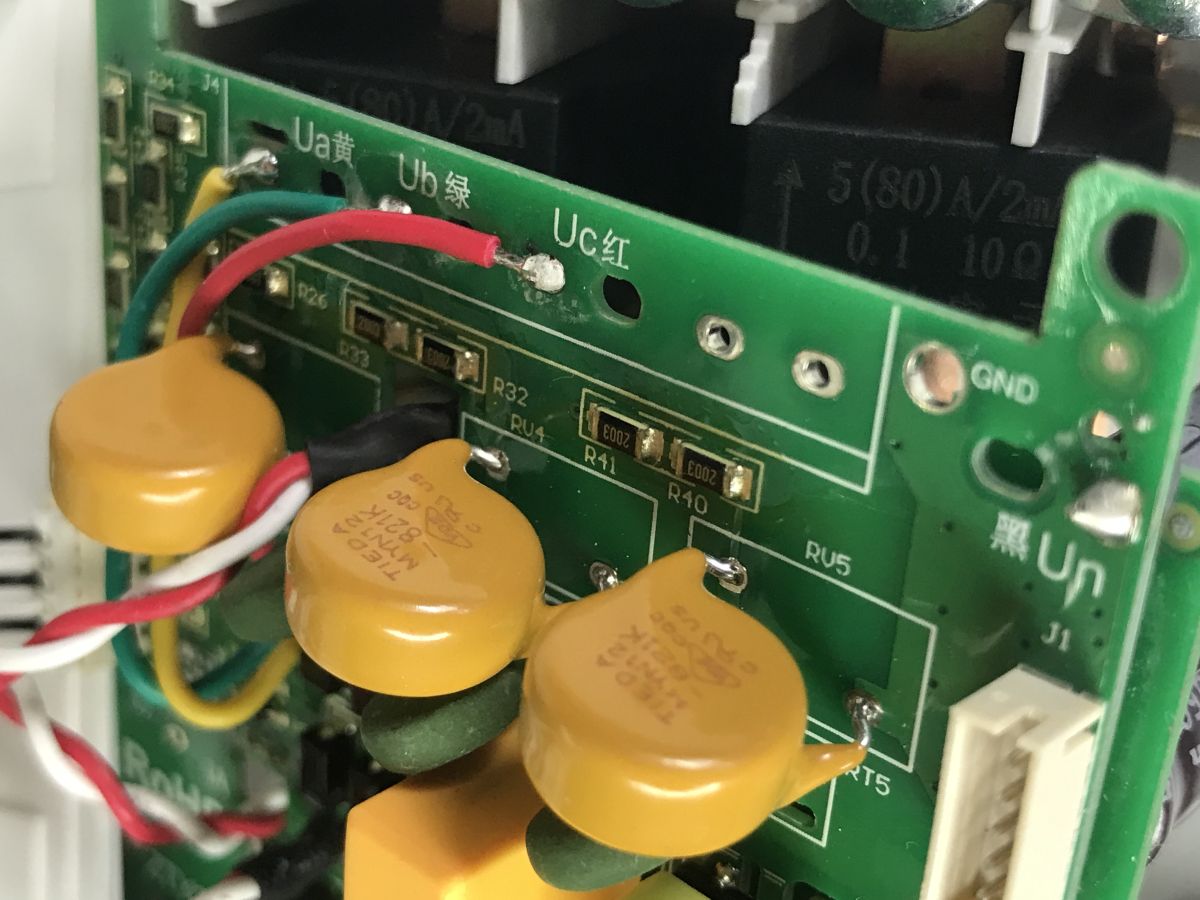

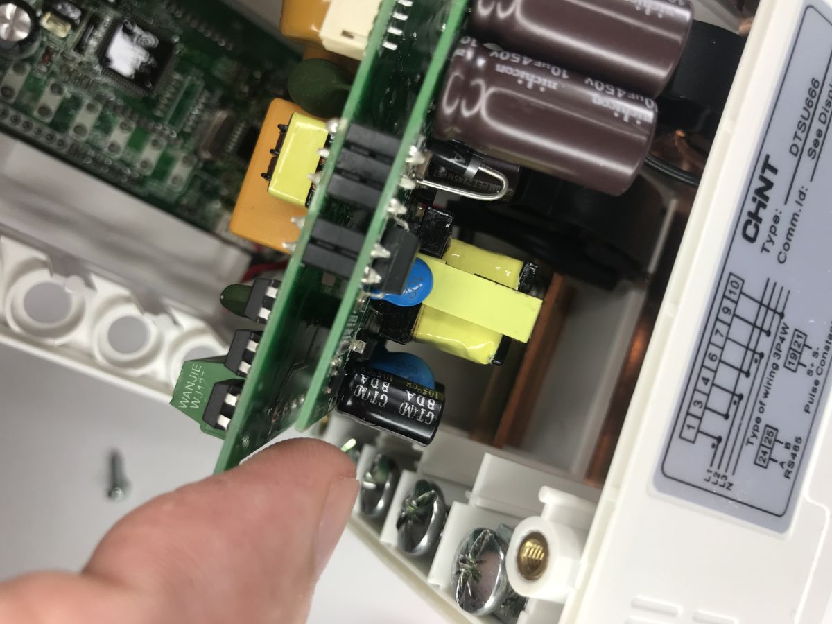

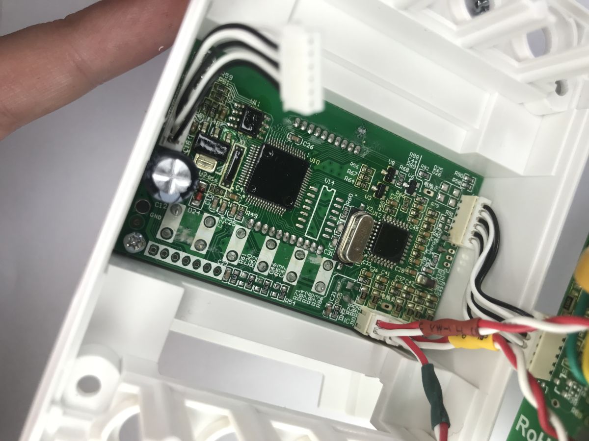

    You can also take a look inside the meter:
    The DTSU666 bidirectional, three-phase electricity meter and data retrieval via Modbus on the ESP32 The DTSU666 bidirectional, three-phase electricity meter and data retrieval via Modbus on the ESP32 The DTSU666 bidirectional, three-phase electricity meter and data retrieval via Modbus on the ESP32 The DTSU666 bidirectional, three-phase electricity meter and data retrieval via Modbus on the ESP32 The DTSU666 bidirectional, three-phase electricity meter and data retrieval via Modbus on the ESP32
    The integrated circuits are unmarked; the board is coated with a layer of varnish for protection. The internal layout appears to be quite elaborate; MYN12-821K varistors can be seen, used for surge protection, along with 5(80)A\2mA current transformers.
