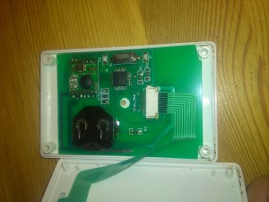

    Two years ago, I built a lighting control system – and more besides – for my own use, but I never had the time to take the project any further. To ensure the project didn’t fade away – or rather, so that it could be of greater use to others than just to me at home – I decided to share it.
    I think the greatest achievement was not just the on/off function, but the implementation of scenes in a small remote control that allows me to switch off all the equipment in the house with a single button.
    The project was developed in a flat, so all communication between the devices takes place via radio.
    I’m making the circuit boards, components and software available. I’ve added a forum to the website so that anyone interested can continue to develop and modify the solution.
    I’ve also quickly posted a video showing how the two-channel dimmer control works.
    The documentation is available on the website ciachbabkewpiach.it.pl
    It’s a bit of a funny domain name, but it’s my own.
    If you have any questions, I’m happy to help.
    Good luck, Piotr

    We now have a complete project; the lighting can be controlled from a computer or the ever-popular Raspberry Pi
    The following converter was used for the project: USB to RS232 AVT1595 B chip MINIATURE USB<->UART (RS232) CONVERTER
    How to build a Smart Home wireless lighting control system with scenes and radio? How to build a Smart Home wireless lighting control system with scenes and radio?
    RS232 ground pin – Remote control ground
    RS232 +5V pin – Remote control + Battery
    RS232 RX pin – 330 Ω resistor – PIN D.0, right next to the RESET pin
    The entire circuit is powered via USB.
    Upload the code from the website:
    http://ciachbabkewpiach.it.pl/wordpress/kod-urzadzen/
    and you can control your entire home. If you programme your computer, you can link your home automation system to a mobile app. Good luck!
