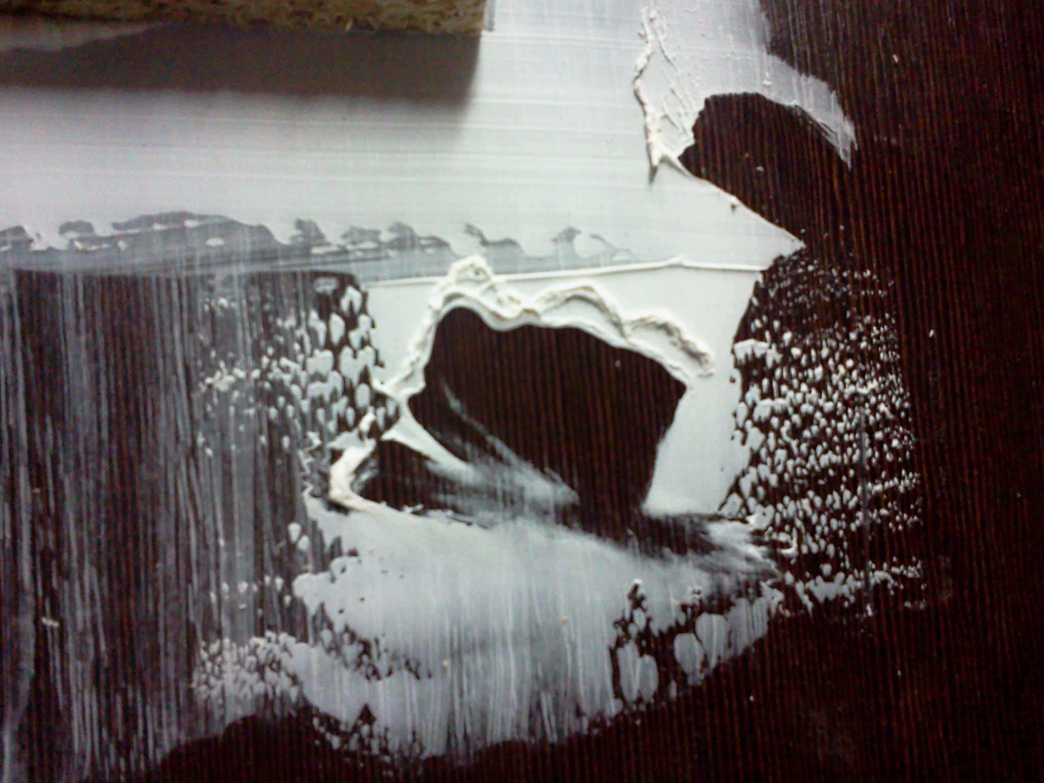

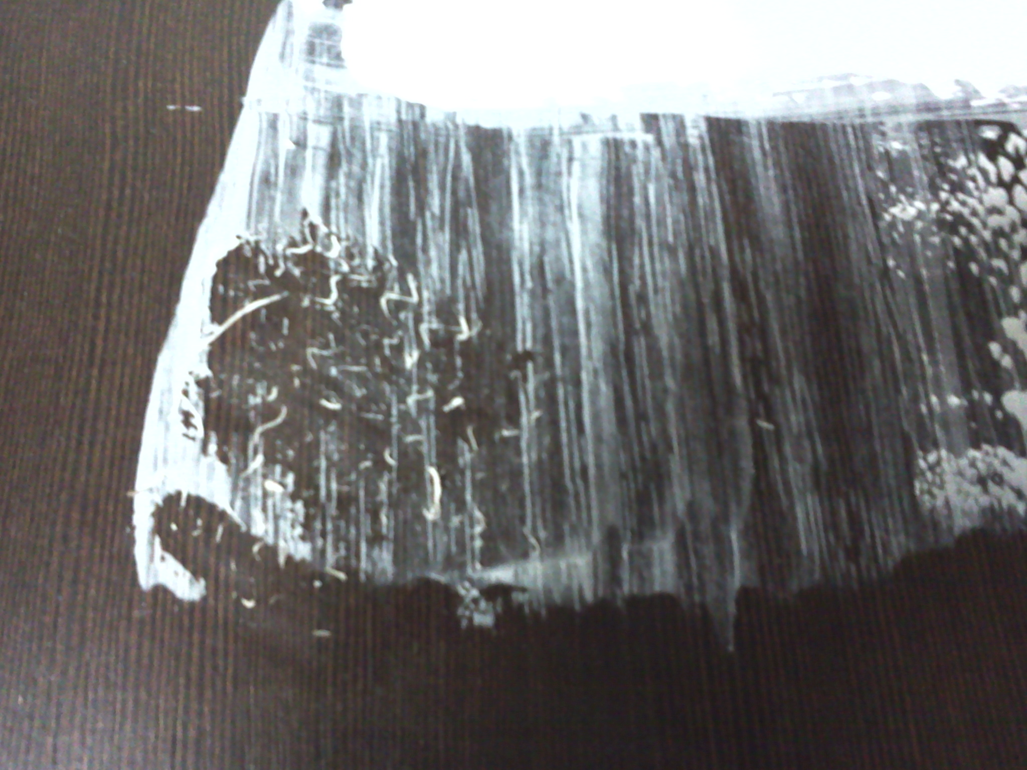

    I did an acrylic test for you so that you don't have to get your hands dirty at home.
    The first picture shows pressed acrylic, the second is smeared, the third and fourth acrylic after finger drying after 8.5 hours of drying.
    Professional Techniques for Silicone Application When Embedding a Conglomerate Sink Professional Techniques for Silicone Application When Embedding a Conglomerate Sink Professional Techniques for Silicone Application When Embedding a Conglomerate Sink Professional Techniques for Silicone Application When Embedding a Conglomerate Sink
    A thin layer represents the residue on the porous laminate, then you take a damp cloth and wipe the residue off. Next to it, you have a thicker layer, as if the thick one was wiping off, you can see the effect for yourself. The temperature in which the described element was located was within 19 - 23 degrees C.
