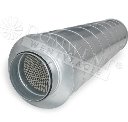

    Could you tell us how to silence the ventilation ducts in which the air flows from the fans?
    Ducts are a kind of horizontal fiberboard eaves, gray pvc pipes, white pvc channels, and the plastered walls in the corner of the room that make up the two walls of the channel (the other two sides are plastic panels.
    Someone told me that it is worth lining the canals with felt, someone else - with foam or polystyrene. That's true?

    The flowing air whistles on all kinds of "burrs", protruding elements inside the tunnel, narrowings and sharp bends.
    The noise intensity increases squarely to the speed of the flowing air.
    First of all, make sure that the plow does not get caught on anything, has a good "slip", the felt inside would create additional air flow resistance, while being a perfect habitat for microorganisms.
    On the other hand, from the outside, you can additionally cover the tunnel with noise-dampening material, e.g. mineral wool

    Insert a silencer between the fan and the duct on the discharge side, on the supply side, on the exhaust side, on the suction side, of course.

    Thanks for the hint. And what is this noise suppressor?
    Google offers various information, but mainly in the fields of automotive (for exhaust pipes) and medicine (earplugs :-) so I guess that's not it.

    The noise silencer is a structural element of the AHU or air conditioning / ventilation system. It is designed to filter out the noise coming from the engine and fan. Additionally, the so-called "aprons" between the AHU / fan and the installation for separating vibrations. However, we use shock absorbers between the air handling unit / fan and the building structure.
    Noise silencer e.g. such Link
    The design depends on the cross-section of the installation, rectangular / round chambers have chambers probably lined with mineral wool or other noise-absorbing material. After the silencer in the air supply direction, the so-called a "steering wheel" that will unify the flow disturbed by the muffler.
    Here, "apron" is called a flexible connection, e.g. like this Link it is used to isolate the installation from vibrations of the drive,
    and a shock absorber to isolate the building from vibrations of the drive, e.g. Link

    Damper for ventilation:
    Metal ventilation silencer with protective mesh. .

    But you can give this attenuator anywhere in the duct - in the loft, in the false ceiling, or wherever you have them distributed.
