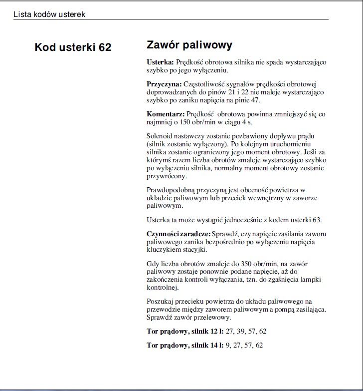

    This generates the 62-speed code. The motor speed must be reduced by at least 150 rpm within 4 seconds. The setting coil has no power (the motor is off). At the next engine start, the torque is limited. Normal torque is restored when the engine speed drops at the right pace after the engine has been switched off ..... there may be many reasons, for example, an air-fuel system, a faulty valve, installation.

    You have a picture for the fuel valve
    SCANIA 144 530 Opticruise: Large Burning Error EDC 62, Needle Protrusion Sensor, Gas Pedal Sensor
    Also change the fuel filters ... clogged causing electronics damage.
    I had a similar action in the actros ... the aluminum casing of the engine control module (computer) corroded from the inside and miracles worked, after cleaning (white sludge) and rubbing with alcohol, everything like a hand took away
