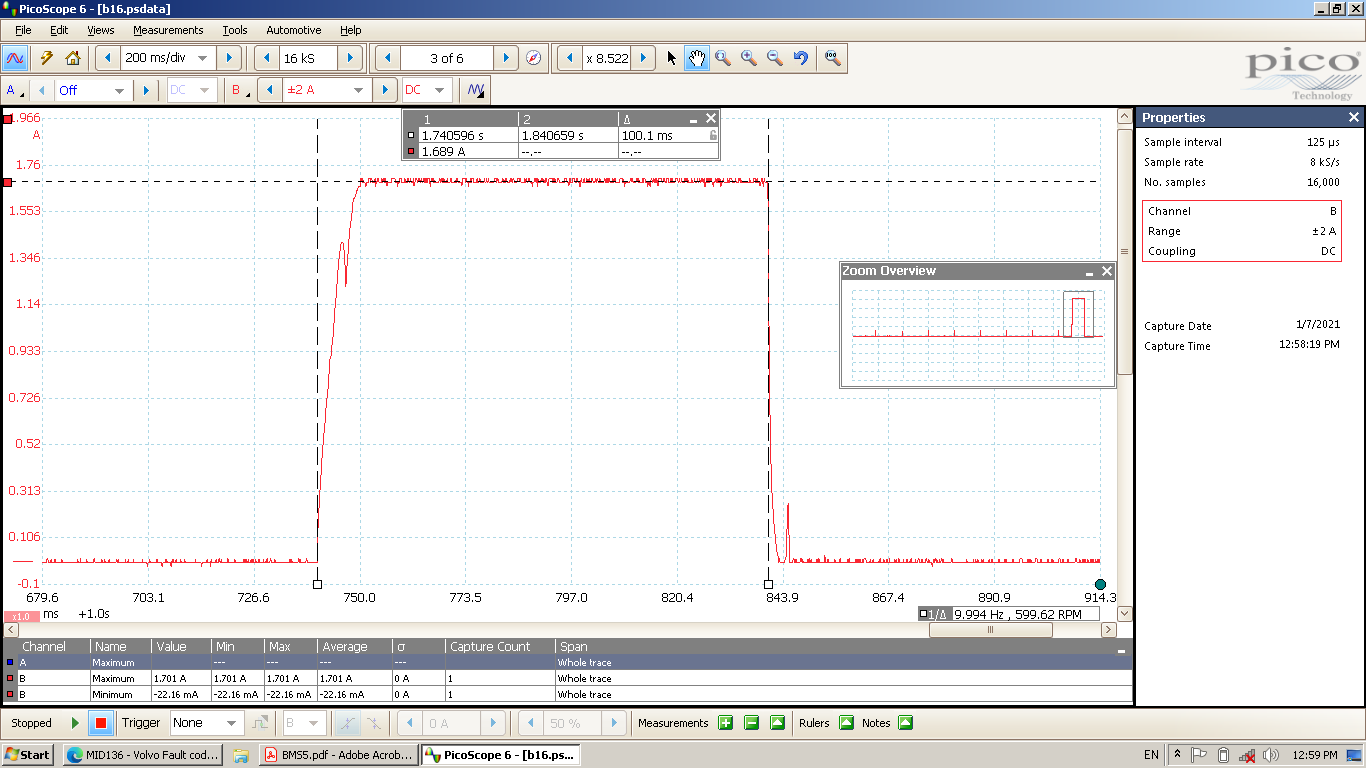

    #13 19165429
    mdfkmw
    Hello. Great value in this topic! I cant speak polish but I've used Google Translate. I want to tank you for the diagram amd to say what I've discovered in my Scania EBS 5 - 8993 fault code (Delphi diagnose code).
    I've checked the valves on the front side with the ohmmeter and the result were good and consistent. Also no shorts to ground. Managed to identify the ECU wirings pins with the schematic diagram and I've managed to take a Amp measure on the front valves. here are the results on all 4 front actuators:
    B10 pin Decoding Scania R Error Code BMS 1882984 8993: Assistance Needed
    B13 pin
    B14 pin
    B16 pin
    From what I see i think the 1st actuator in V3 valve (front left) is bad. Great.
    Update: Replaced the front left valve and problem is solved.
