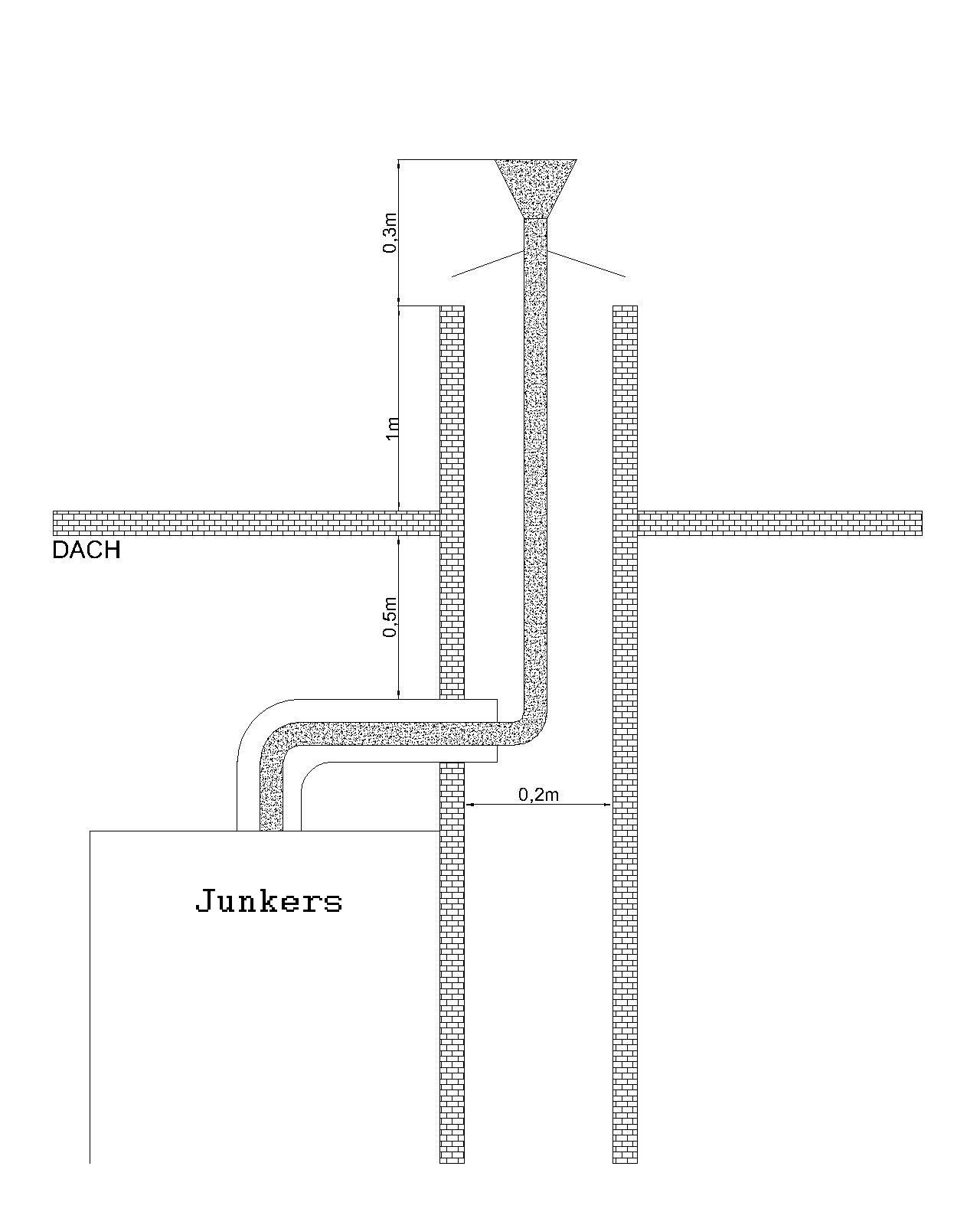

    Hello, this heating season I have a problem with error C6 (turbo stove). I know it's a pressure switch, it doesn't draw enough air. There is no rule for this error, one day everything is ok, another crashes every now and then on CW and CO. Once in the morning there are problems, and in the afternoon ok.
    I sketched what my chimney duct looks like
    JUNKERS C6 Error: Pressure Switch Issues & Chimney Duct Influence on Turbo Stove Performance
    I'm afraid that the suction pipe unnecessarily ends right in the brick chimney. Now I thought that maybe I could try to raise the protective roof over the chimney a little, but I'm away from home so I won't do it for now.
    There was a service technician (unfortunately there is only one in the area), he removed the furnace casing, blew into the hose and that's it, the problem repeated. He advised me to unscrew the caps on the top of the stove, but I think the guy talks nonsense. Of course, it would probably help, but the stove would no longer be with a closed combustion chamber, that's not the point.
    Press him to replace the pressure switch, or look for the cause in something else?
    Last winter it was ok.

    The fact that the boiler is unsealed does not have a closed combustion chamber. But even so, it stays safe because the fan will still throw exhaust fumes up the chimney. For an experiment, I would depressurize the boiler and wait for some time. If the error persists, you can think about replacing the pressure switch.

    If it is under warranty, ask the service technician to replace the pressure switch. It is also worth cleaning the venturi tube in the fan, possibly replacing it from plastic with aluminum. Measure the negative pressure according to the instructions supplied with the device, then check the chimney with a flue gas analyzer. After the warranty, replace the pressure switch with a lower activation threshold....

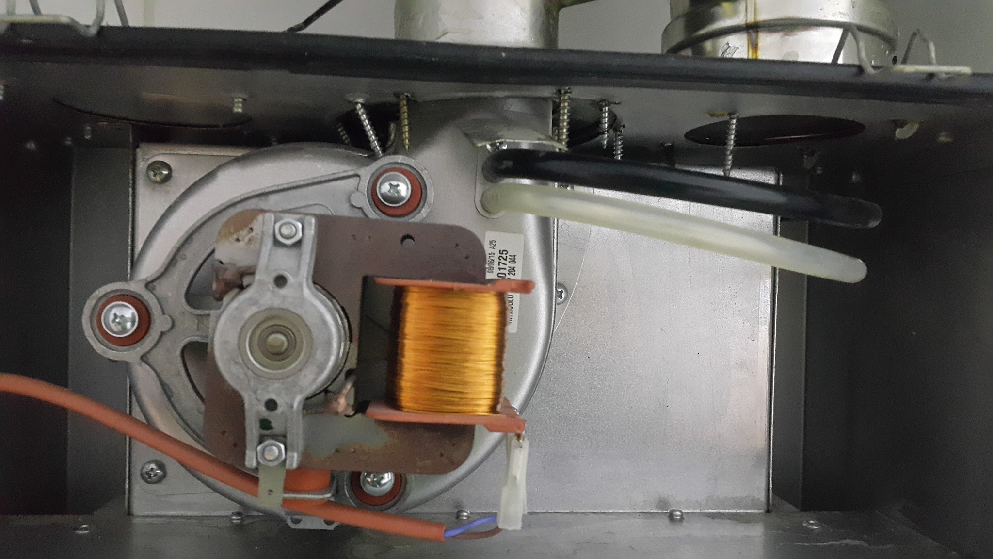

    I don't want to start a new thread. I have a junkers turbo stove. I once had problems with the C6 error, a service technician came and did something and it does not appear anymore. I feel fumes in the bathroom, something is not tight, I look inside and there are two hoses. One black is loose, not connected to the stud. When I connect it, it's C6. What did the service guy disconnect it from?
    What could be causing the smell of exhaust fumes? can it fly through these screws securing the exhaust outlet to the stove? (professionally screwed)
    Earlier, the furnace outlet was leaky, I sealed it. I'd rather not see these professionals again. Do it yourself or know what to worry about...
    Maybe he just disconnected my pressure switch? what is it actually used for?
