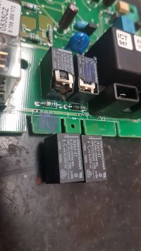

    I have a seven-year combi oven with a closed combustion chamber. This morning he let me down for the first time :) Error C6 has appeared. After the reset, only the circulation pump started and after a few dozen seconds C6 again.
    I read a few topics in the forum and started checking according to other users' suggestions.
    I started by dismantling and checking the pressure switch - functional. I noticed that the fan does not start - no supply voltage at its terminals and at the output from the motherboard. Disassembly and measurement of the 24VDC relay, described on the board as RY1 (functional coil, damaged working contacts) - replacement for a new one - the furnace works :)
    I used the replacement because I don't have the original yet. I enclose a photo, maybe someone will need it:
    Junkers ZW 14-2DVAE23S5300 - C6 error, relay replacement + error codes20171029_1..636.jpg (4.4 MB)You must be logged in to download this attachment. Junkers ZW 14-2DVAE23S5300 - C6 error, relay replacement + error codes20171029_2..844.jpg (1.85 MB)You must be logged in to download this attachment. Junkers ZW 14-2DVAE23S5300 - C6 error, relay replacement + error codes20171029_2..134.jpg (2.23 MB)You must be logged in to download this attachment.

    This is not a replacement for this relay!
    Your reasoning even a 30kW motor contactor would be a replacement for this relay.

    Maybe I spoke wrongly, but without exaggeration buddy. The substituted relay is for the same supply voltage and has the same load capacity of the working contacts.
    Despite the search, I haven't been able to buy the original yet.
    For me, the most important thing is that the stove works correctly :)

    For other leg insertions. Do you recommend making spiders on the disc? Universal relay available in most electronics stores. Even on the website.

    I do not recommend creating cobwebs on the disc and I gave photo info on a different leg spacing. When I have the opportunity, I will probably buy relays and mount the original.
    Writing on the forum, I wanted to share the details of the failure of my furnace rather than promote the fancy assembly of replacements. The topic was created rather for people who will find themselves in a similar situation as me, i.e. the failure of the stove on a cold Sunday.
    I would like to draw your attention to the fact that a common reason for the C6 error may be a faulty relay. Perhaps someone will encounter a similar failure, so they will be able to start the diagnosis by checking this device.
    I informed you that I am providing an ad hoc solution to the problem. You have misread the idea of adding a topic to this topic.

    As I read your post, I remembered the disc after being repaired by one car electronics.
    Sorry.
    But gas control elements if it's only 1: 1
    Relay link that you should use
    Junkers ZW 14-2DVAE23S5300 - C6 error, relay replacement + error codes Junkers ZW 14-2DVAE23S5300 - C6 error, relay replacement + error codes Junkers ZW 14-2DVAE23S5300 - C6 error, relay replacement + error codes
