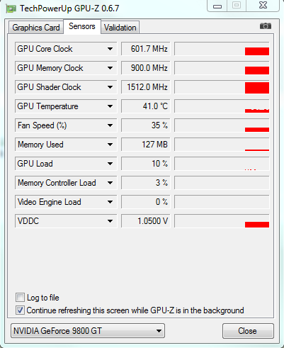

  • #4 11864346
    Kasek21
    Posts: 45661
    Help: 4981
    Rate: 3548
    Give a screen from GPU-Z -> GPU and Sensors tab
    Give a screen from CPU-Z -> CPU and Maniboard tab.

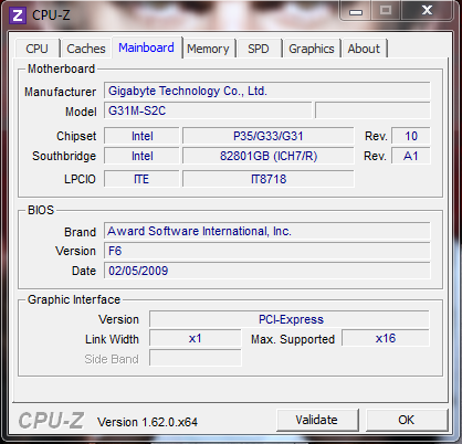

  • #5 11864404
    oskar556
    Posts: 105
    Rate: 31
    Kasek21 wrote:
    Deliver screen from GPU-Z -> GPU and Sensors tab. Deliver screen from CPU-Z -> CPU and Maniboard tab.
    Experiencing Blue Screen Error 0x00000116 with nvlddmkm.sys on Windows 7 Pro 64-bit Experiencing Blue Screen Error 0x00000116 with nvlddmkm.sys on Windows 7 Pro 64-bit .
    #6 11864433
    Kasek21
    Posts: 45661
    Help: 4981
    Rate: 3548
    Set PCI-E in the bios to x16, if it is so set now then probably the card is defective - check on another computer.
    You can still reinstall the drivers to some earlier version e.g.: 301 earlier by cleaning the system from old drivers with Driver Sweeper.
  • #7 11864765
    oskar556
    Posts: 105
    Rate: 31
    One question, how to change in bios PCI-Express to x16 ?
    My bios: Award software international F6

  • #11 11869187
    swiercm
    Moderator on vacation ...
    Posts: 18308
    Help: 1216

  • #17 11870778
    Piotr160292
    Posts: 5137
    Help: 374
    Rate: 282
    And, I didn't read it apparently, because I didn't see it mentioned anywhere. Since the driver is uploaded, surely the card is banged up.
