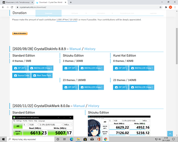

    which edition to download? Bluescreen z info "kmode exception not handled"

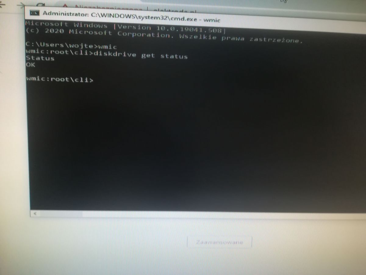

    W0j734
    Posts: 25
    Okay, I'll take care of it tomorrow.
    Added after 3 [minutes]:
    And could I, instead of checking this bone, take one from my brother's computer and see if blue screens pop up with it?

    W0j734
    Posts: 25
    will send in a moment, download the program
    Added after 4 [minutes]:
    screen:

    After removing and inserting the battery, something like this is displayed to me. What to do? Bluescreen z info "kmode exception not handled"
    Set BIOS date and boot from the Memtest USB
