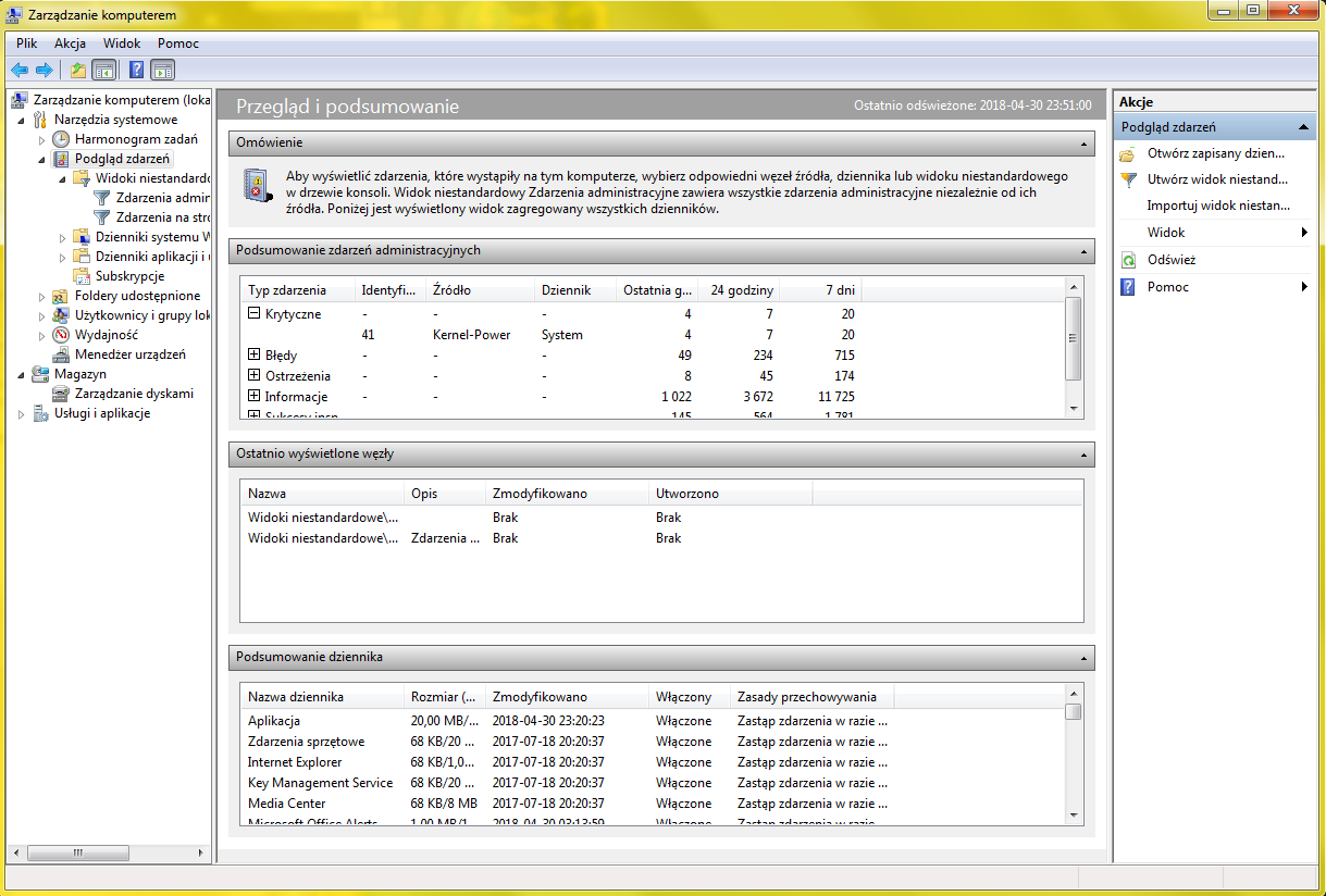

    adds attachments from BlueScreenView
    • Bluescreen "Page fault in nonpaged area" i "Bad pool caller" podgląd zdarzeń.png (116.8 KB) You must be logged in to download this attachment.
    • PAGE_FAULT_IN_NONPAGED_AREA.txt (1.89 KB) You must be logged in to download this attachment.
    • BAD_POOL_CALLER.txt (1.86 KB) You must be logged in to download this attachment.

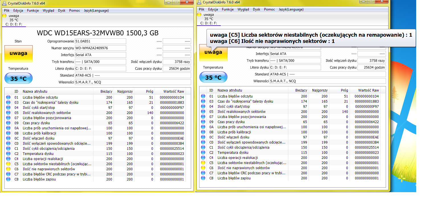

    i checked discinfo64 disk and it was in good status but thought i put it in here and deleted it, then i ran memtest and after done i had disk check when done i went back to discinfo and now i have status note: /.

    SLU06 wrote:
    I checked discinfo64 disk and it was in good status
    It's not good at all.
    When interpreting SMART:
    - for WD disks, parameter (01) and (C8) should be zero. The disk has mechanical or surface problems.
    To analyze it in more detail, you would need a surface scan with visible MHDD sector access times.
    - due to (C5) and (C6) it would be necessary to protect the data on a different medium and perform a repair procedure in the form of remap + reset =>
    https://www.elektroda.pl/rtvforum/topic1550200.html
    After performing the repair procedure, re-insert SMART and the surface scan from the MHDD.

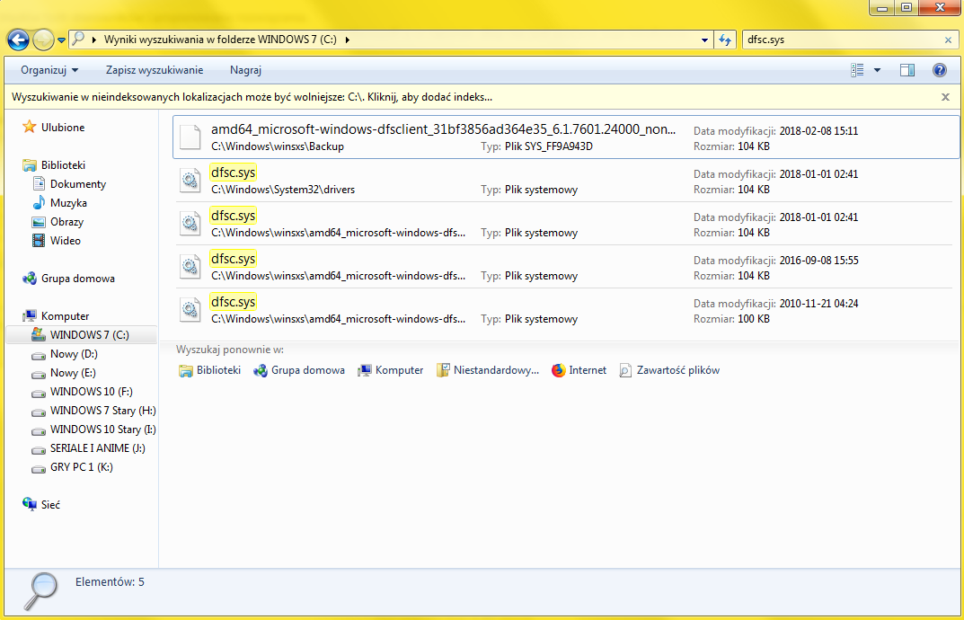

    I found it.

  • #29 17311054
    Robert B
    Posts: 22594
    Help: 2027
    Rate: 1412
    From the sizes and dates you can see that you have at least 3 different versions of the same file and this is the main possible cause of errors.
    Just leave the one in the folder Windows \ System32 \ Drivers and remove the rest from other locations.
    Do the same for the other file rdbss.sys because it can also sit in several places and in different versions.
    Generally, you should leave the latest and signed version in the default location.
