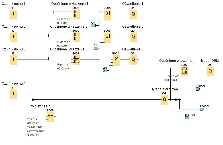

i am designing a simple lighting system connected to an alarm.
When motion is registered by sensor 4 (input: I4), lights are switched on (outputs: Q1, Q2, Q3) and a siren is activated (output: Q4). After two minutes (delayed activation: B007), it activates the GSM communication module.
I would like the user to be able to turn off the alarm after entering a code (combination of buttons: e.g. 1, 2, 3, 4) on the control panel (LOGO! TD), but I don't know how to implement it. I am counting on help.
