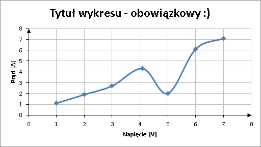

    I would like to present a step-by-step instruction for students on how to properly format a graph for the needs of a laboratory report (e.g. physics) so that the tutor does not get stuck. :D The purpose of this guide can be illustrated by the following two graphs:
    A properly formatted chart:
    Excel Chart Formatting for Lab Reports: Step-by-Step Guide on Creating Clear & Effective Graphs
    A chart that shows nothing:

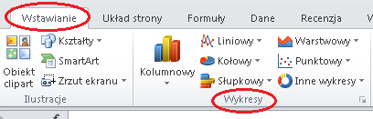

    In order to create a graph from the presented data, it is necessary to:
    1. Mark the area of Table 1.
    2. Go to the "Inserting" section
    3. Select one of the types of charts there, which can be found in the "Charts" section

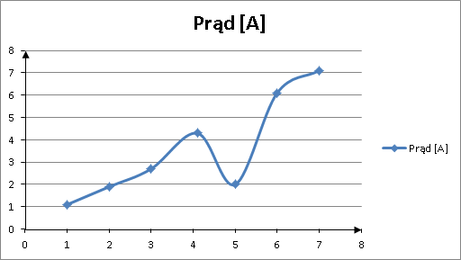

    Most Excel manuals and tutorials contain line charts. It is a mistake to use them to solve this problem! A sample line chart is shown below:
    As you can see, the chart presented above DOES NOT reflect the actual relationship between the measurement data. It is worth paying attention to the X axis, on which the values are between some intervals. Avoid line charts in your reports! They are used in other situations, never in the report.

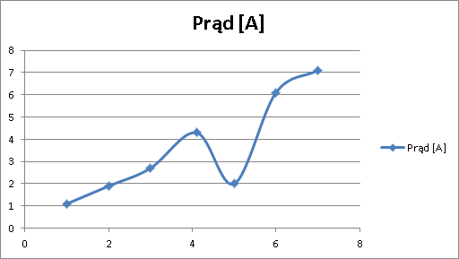

    After selecting the mentioned option, Excel will create the following chart:

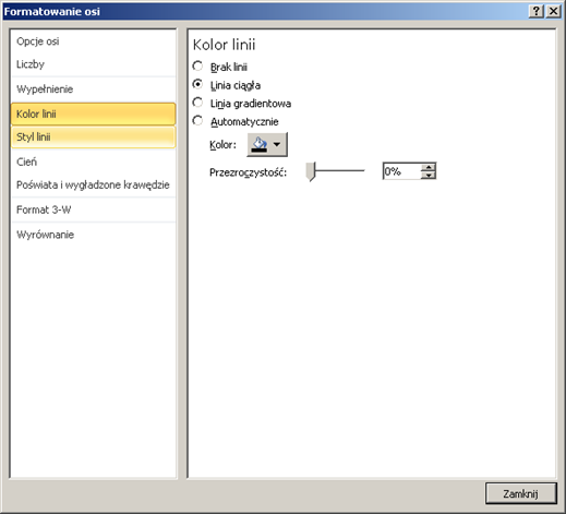

    Now the presented dependency is consistent with the table. However, the chart itself still shows nothing. First, the axes of the coordinate system should be marked, along with their sense. To do this, right-click on the axis and select "Format Axis".
    Then, modify the Line color (solid line, black color), and the Line style (End type - arrow).

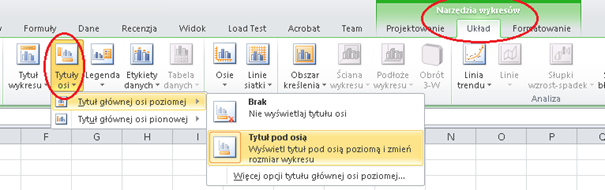

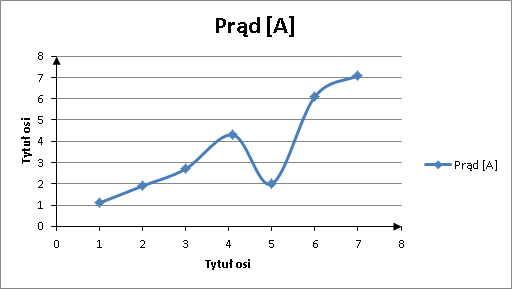

    However, it is still unknown what values are presented on the individual axes. To change this, describe each axis. To do this, left-click on the graph to select it. The "Chart Tools" option will appear. There, select "Layout", and from the "Labels" section, select "Axis titles".
    Axis titles will appear:
    When describing each axis, give the UNIT in which the data are presented. The chart legend is needed when there is more than one curve. In this example, there is only one curve, so the legend has been removed.

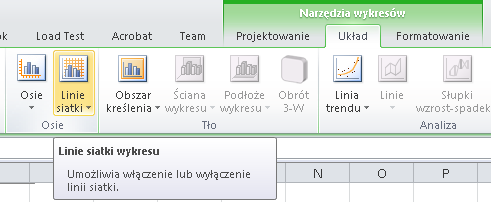

    Then add grid lines.
    When the gridlines appear, you can right-click them and then select "Format Gridlines".

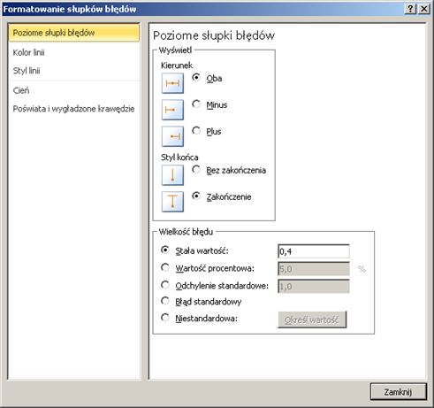

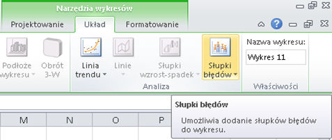

    The chart is almost ready. In physics classes, however, error bars are also often required. The value represented by the error bar is equal to the measurement error value for a given point. The official instructions for error bars can be found here: Link
    However, it is worth knowing that to add error bars, first select the chart area with the left mouse button, and then select: Layout -> Error bars
    Excel Chart Formatting for Lab Reports: Step-by-Step Guide on Creating Clear & Effective Graphs Excel Chart Formatting for Lab Reports: Step-by-Step Guide on Creating Clear & Effective Graphs

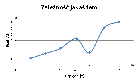

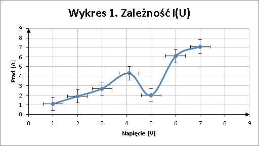

    IMPORTANT! Each chart must have a TITLE!
    If there are more charts, each chart must have its number
    Now, in addition to the graph, a trend line should be added that reflects the ideal course of the function under study. In order to add a trend line, right-click on the data series and then select "add trend line"
    In this example, a linear trendline has been selected because it is assumed that the relationship is linear. Always select a trend line that is compatible with the type of ideal function describing the phenomenon under study.
    Interpretation:
    If the trend line (it can be understood here as the ideal course of the tested function) crosses all the measurement points on the graph, or passes through all the error bars, the measurements have been made correctly (all values are within the measurement error range).
    In the given example, the value of 2A, at 5V, differs significantly from the trend line (now you can see what the descriptions next to the axes are for - so that you know what you are talking about). This means that in this place the so-called "gross error" (the measured value differs from the expected value by far more than the value of the measurement error predicted). Such a measurement (point) MUST NOT be taken into account during calculations!

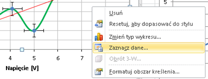

    Going the easy way: To avoid the hassle of formatting 20 charts for each report, you only need to create one and then copy it. After copying, right-click on it, and then select "Select data"
    Then, select the table with the measurement results and adjust the details of the graph, such as:
    Axis min / max values (if set manually),
    Error bar values,
    Trend line type
    Axis descriptions
    Chart title
    Units
