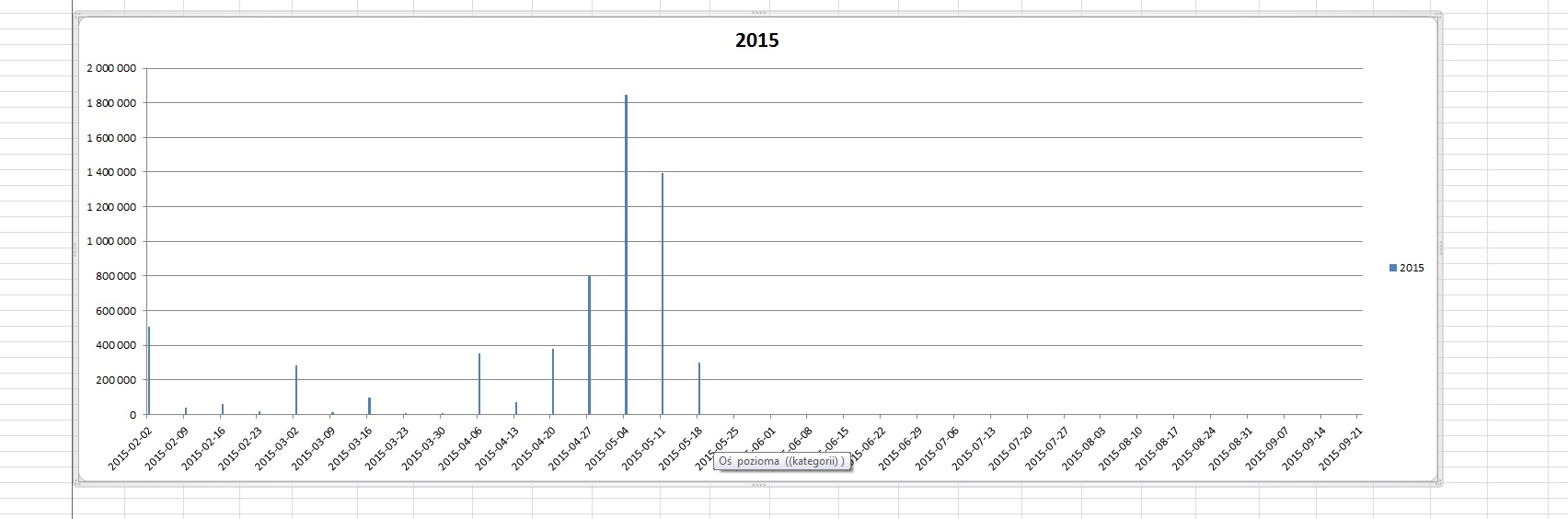

    I inserted an excel chart and it made me very narrow bars. I can't find where to set the graph to normal. I don't know if the data range or the formatting settings?

    Double-click on the "bar" and set the gap width to 0%.
    But it can also be related to the amount of data in the source table.

    I found what needs to be improved. You need to enter the axis formatting and change the axis type to the text axis. It only helped.
