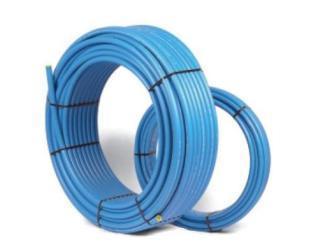

    Put the conduit in the ground and bring it home. At home, let go wherever you want, making sure that the turning radius is as large as possible. Of course, it can go the same way as the current media.
    If you decide to use a conduit - put a string / line in it so that you can easily pass the optical fiber through it. You can pull the conduit (but this is at your own risk) to the pole, leaving a spare for connection at the pole, so that you can wrap it so that no water will drip into it ... But here the question arises - where will they pull the optical fiber from ...
    On the other hand, the conduit at / on the house is always useful - precisely because you can replace / release another cable in it (whether it is a twisted pair or a new optical fiber)

    The drawback is that when entering the ground from the pole - anyone will be able to damage your link (consciously or not)

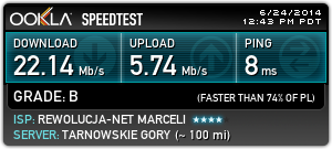

    So far there has been no failure. (repairs on the link were planned several times, during the night)
    The speed I have is 20 / 5Mbit, in fact it is 22 / 5.5
    Current speedtest: Optical Fiber Internet Installation: House Connection, Converter, Router, Power Pole & Regulations
    At the beginning of the network launch, I managed to reach 370 / 48Mbit, but these were only temporary problems with limiting the transfer.
