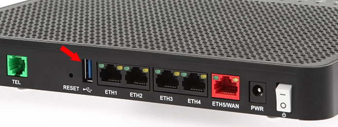

    Orange brings the light to the premises itself and then gives a so-called optical terminal:

    Well, but this terminal is probably quite necessary, it has to establish some sessions.
    You won't fasten it to a fiber optic switch
