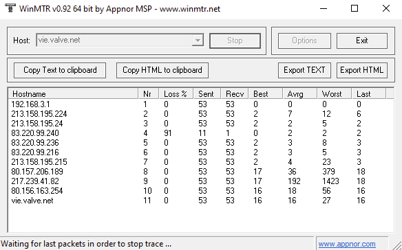

    In T-Mobile you can get an offer "from under the counter", not the one on the website. I got 3 months for PLN 1 and from the 4th month for PLN 70.
    T-Mobile has its own routing, examples below:
    Orange:
    Optical fiber, or concentration and internet quality (T-Mobile, Orange, UPC)
    T-Mobile:
    Orange:
    T-Mobile:
    Orange:
    T-Mobile:
    Orange:
    T-Mobile:
    Orange:
    T-Mobile:
    I do not want to do more, but you can see immediately what has a better ping .. ;)
