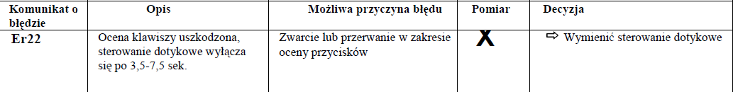

    Hello !!! Maybe one of my colleagues will tell you. After starting the disc, the panel flashes and after a while an Er 22 error pops up. I was looking for information, but I found nothing in the network.

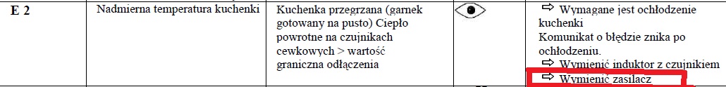

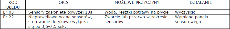

    I have corrected the subject and did not find what you sent me. I was looking after and after the error code. The only thing I found was the codes for Amici and Elektrolux, but I was not sure if they were even close to Teka. After disassembling the plate and more thorough inspection, I found a swollen capacitor 470uF / 25V. There were two. I replaced the damaged one and the plate moved.

    Well you see, I do not know what results from the documentation because I do not have it. And I do not know if this is a pure coincidence because: I will write exactly once again!
    After switching on the kitchen, the whole control panel display flashed at different intervals, after which the Er 22 error occurred after several seconds. During the flickering of the panel there was a ticking at a frequency such as flashing. In the network I found that it is a control panel power failure so I turned my attention to the power supply.
