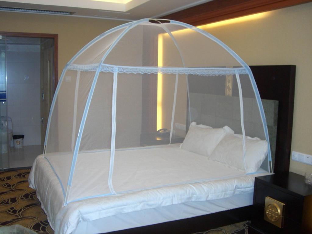

    I just came up with a cheaper way:
    It would be cheaper than wallpapering to create a mosquito net that blocks Wifi and GSM waves
    Blocking Wifi and mobile waves
    The question is, what would it have to be made of, because it would have to be made of a mesh permeable to air and light.

    Kpc21 wrote:
    Another point is that in order to eliminate all electromagnetic waves from the room, not only would it have to be fully shielded, but there could be no electrical appliances or live wires inside.
    And this is where the above-mentioned idea comes in handy with the creation of a mosquito net that blocks GSM and Wifi waves. Then we would have the problem of eliminating all appliances and wiring in the bedroom from the head.

    Copper wire mesh (or rope) - "fabric" with "eyelets" about a centimeter (you can smaller so that it does not let flies and mosquitoes pass), soldered at the wire junctions; on the edges taped with a ribbon of copper (or even better: copper-bonded iron) 15 cm wide, soldered to the wires - these ribbons are used to connect individual elements, you need to arrange them evenly so that there is no gap; on the floor, a sheet of metal, walls and a "ceiling" made of such mesh - are to create a "closed" surface; in the middle, antennas (tuned to popular bands) catching waves that hit there so that they do not fly inside ...

How much would a DIY copper mesh sleeping canopy cost?
Covering a 3×3 m bed area needs ~12 m² mesh, tape, and ground braid—about $150 in materials at $10 m² plus hardware [MeshSupplier, 2023].
