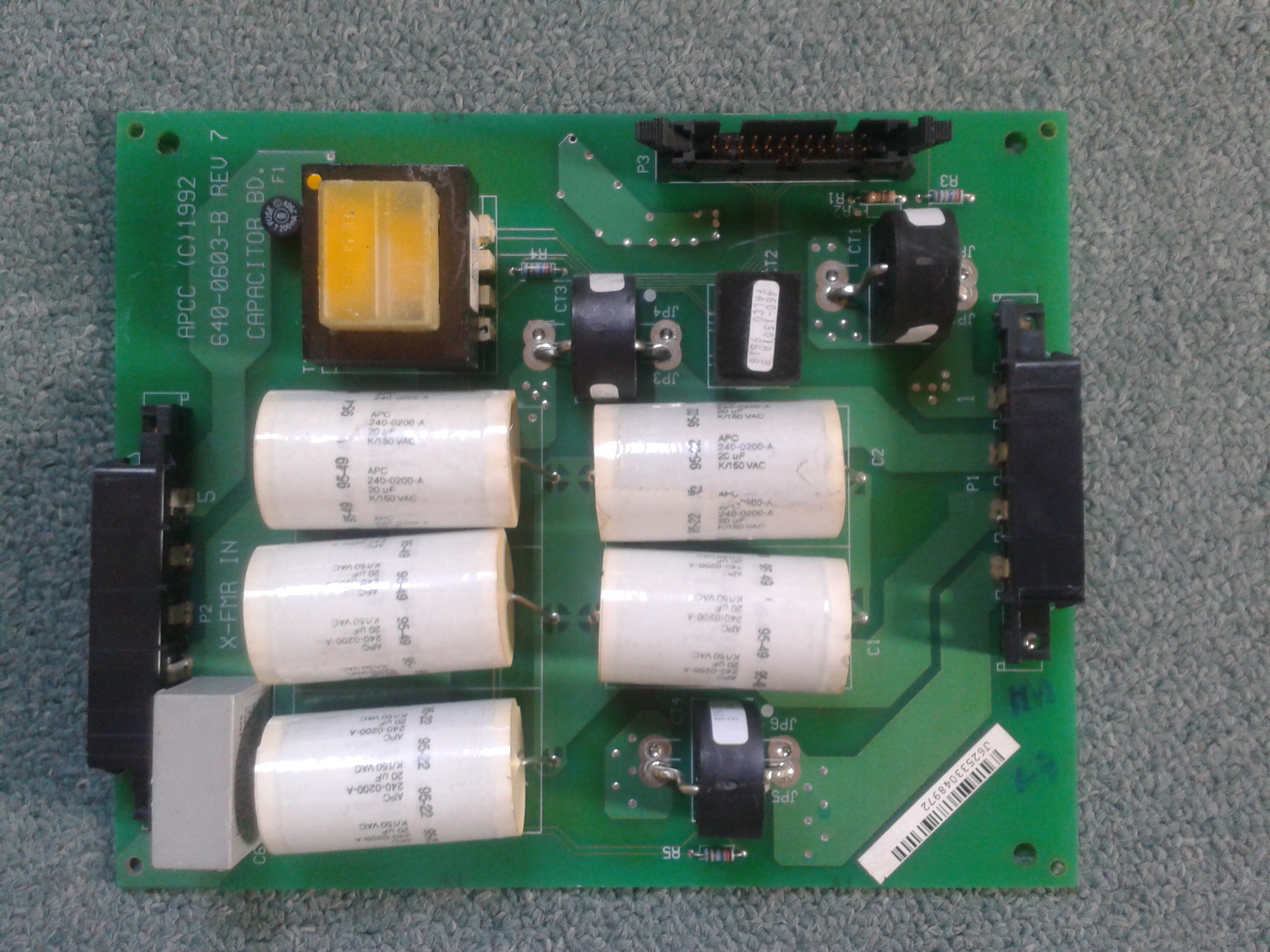

    Thanks for your help the ups is a 2 piece APC 5000 watts. the control box is the top box model# mx5000eu , serial# wm0121006175 it is OK .. The bottom box is the main power transformer model # mx5000iu serial# wmo121005965.. the small output control transformer -430-0025a.7-, "that I need" is on a capacitor board-#640-0603-b-rev7. inside the bottom box. I hope these numbers help to locate a crossover or even an output schematic for the 430-0025a.7 transformer, I have not been successful finding anything... the transformer is an 8 pin through board mount. thanks a whole lot rick

    we have 110 volts here in Canada the isolation box is model mx5000pe and the pn is mx 5000IU it has no letter W or D at the end of the number . . inside the unit is a capacitor board PN 640-0603-B-rev7. and the transformer I need, is mounted on that board. The transformer PN is 430-0025a.7 , class 130 ,LEI-4 , R 152d , E154515. I hope that these numbers help identify if you have the transformer or the capacitor board with the trans mounted on it (the cap board is a quick connect easy to remove component) thanks again rick

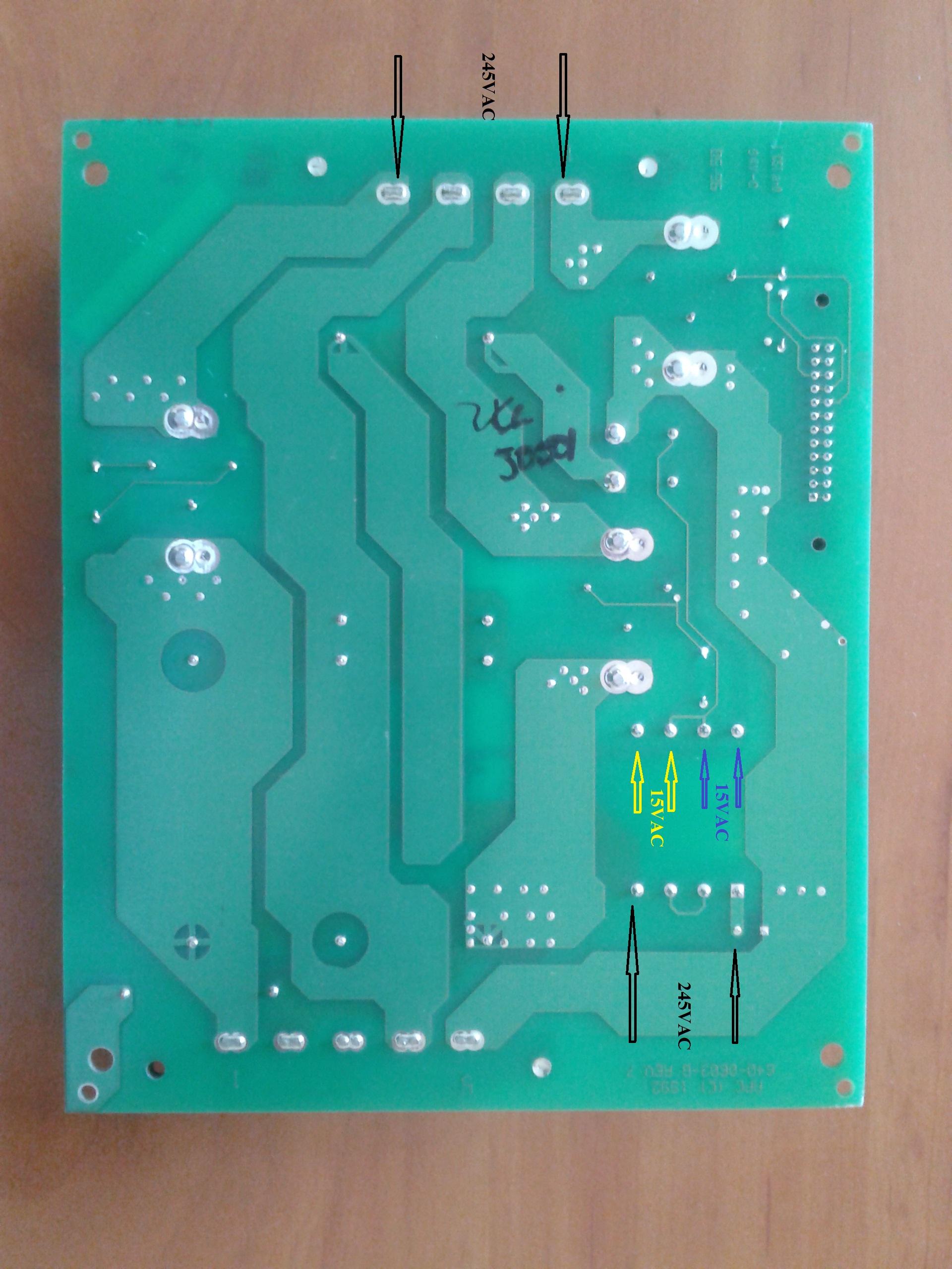

    Ok, I have 640-603 board and some 430-0025 xofmers also, however without a.7 at the end of PN. We should make some tests.
    Here is the board 640-603 foto. The next picture shows what voltages you have to have is some points of board if you apply AC voltage at P1 connector (left side of board).
    If you apply 120VAC to the board taken from working unit and get at the output of transformer about 7,5 VAC it means that the 430-0025 xformer is the same at your and my board.

    Hi.
    Although 640-0603 which I have looks exactly like you need, it doesn't means that this board will work in your UPS correctly. The number 640-0603 is a umber of printed board and doesn't say anything about parts mounted on it. I suspect that, depending of the destination area (we have 240VAC and you have 120VAC) different components were mounted on this board, especially xformer T1 may be different. It is the reason why I send you photo with voltages and asked you to measure what voltages you have on your board. Your answer will help me to recognise if the xformer T1 is the same on your and my board (my T1 has PN 430-0025).
    Generally in APC PN the digit after dot (7 in your case) has no meaning for us, it is information that something was changed in the manufacturing of this part (different materials etc) but functionality is still the same. I'm not sure what maeaning have 'a', may by it is 120VAC xformer version but I'm not sure.
    Please measure voltages, it gives us answer.

    Look at the pictures, there are 3000 and 5000 VA capacitor boards
    https://obrazki.elektroda.pl/2406251100_1371794256.jpg
    https://obrazki.elektroda.pl/4235083600_1371794297.jpg
    Capacitors, fuse, CT2 and T1 are exactly the same!!! I'm not sure CT1, CT3, CT4 but this is not important for us. The most important that T1 is the same. If you have uncomplete cap. brd. for 3000VA you may take T1 from this board and move to the 5000 board. It should work.
