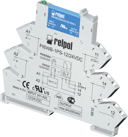

    Most systems for control, be it a PLC or some kind of BMS use relays on the output. I find this quite noisy, even when the switchgear where the equipment sits is behind a wall you can hear the relays. On the controller side of things, it's simple to "pull out" the relays and control the outputs with transistors (or buy a PLC with transistor outputs), the problem is what hardware to use for 230V switching. The assumption is a lamp (wall lamp) is about 60W, let's say a large chandelier about 400W which would give some less than 2A maximum current.
    The question is what kind of READY electronic relay elements to use which can be mounted in the switchgear on TS35 rails. They definitely need to be less than 1 module wide and at the same time not get too hot. sSD "cubes" about the size of a cigarette box are out right away. They are too large, require heat sinks or rather cumbersome mounting and have switching currents of 20-50A (much too large for this application). I don't want to play with building "modules" with a triac and optotriac inside, I would like something ready-made.

    Thank you for the suggestion, however these relay strips are similar in size to relays, width roughly 1 module/1 relay. This will take up quite a lot of space in a switchboard. I have found that Relpol (and other manufacturers) produce so-called "interface" relays, in very slim enclosures and on slim TS35 rail mounts. Which electronic relays for TS35 rail for 230V light control?
    Unfortunately their load capacity at 230V is of the order of 1-2A, only achievable with a distance of a few cm between relays.
    And can anyone suggest some "quiet" relays, with a load capacity in the order of 6-8A at 230Vac?

    After all, the one in the photo has a maximum current of 6 A at 230 VAC .
    This is the load capacity of the "base".
