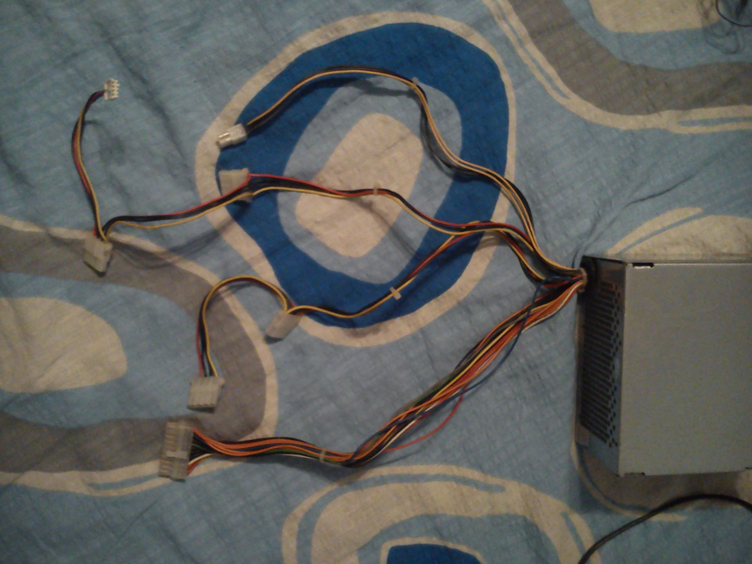

    Ok, I got a power supply from an old PC, but I don't know how to connect it to this radio now. I am asking for tips, and preferably a diagram;]
  • #9 12891838
    magi23
    Level 21  
    Posts: 506
    Help: 22
    Rate: 72

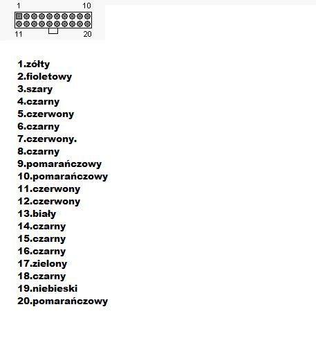

    The yellow wire from the power supply is +12
    Black mass
    Two pins must be shorted in the motherboard cube.
    13 and 14 are the colors Green and Black Wire

    And you can not explain more precisely what to connect to the radio in the power supply? What cable for which? Which cable for which ankle and in which place?
  • #11 12897527
    djandriu
    Posts: 1115
    Help: 40
    Rate: 170

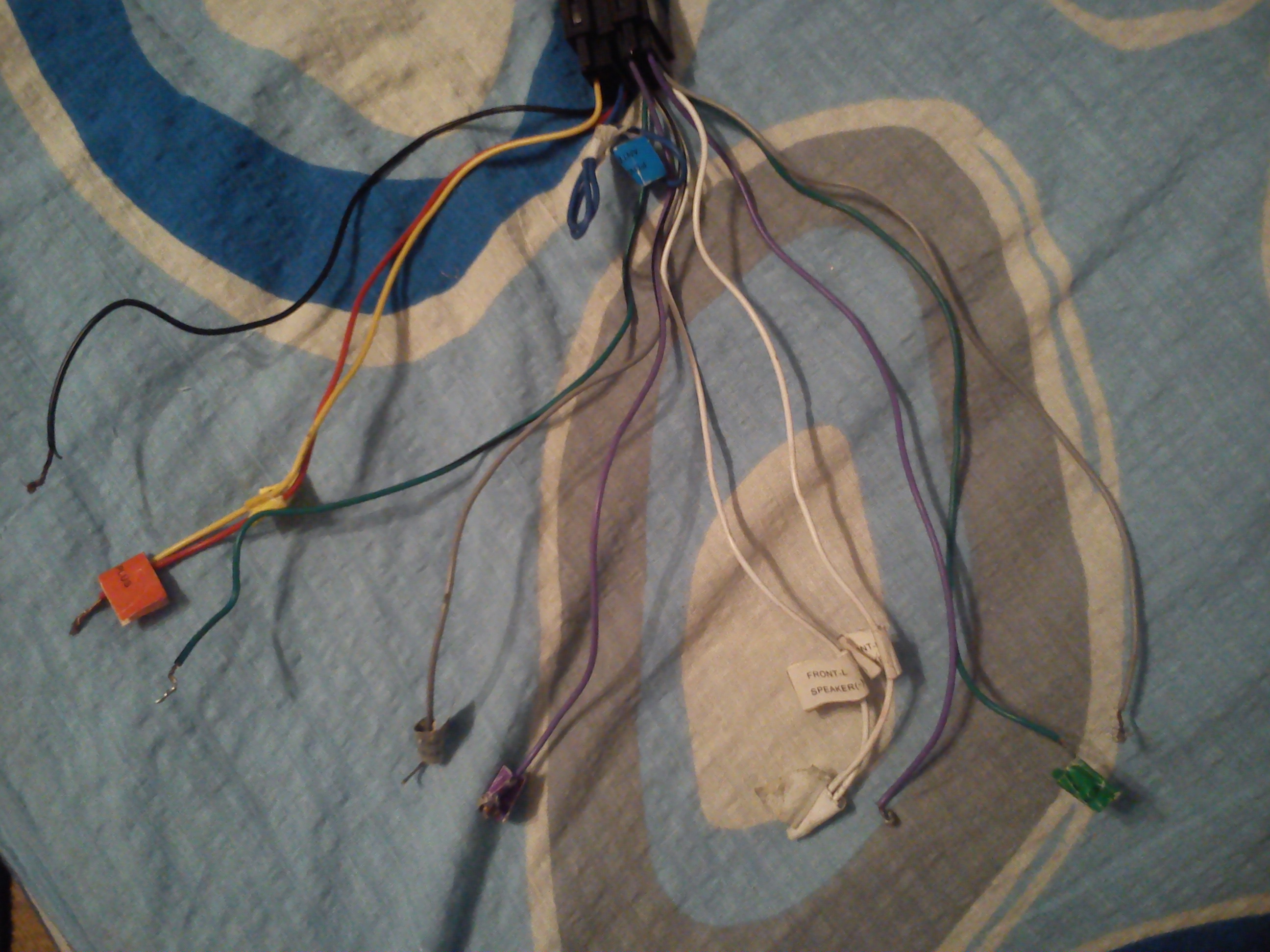

    You connect green from the power supply with one of the black ones, then another black from the power supply connects to black from the radio, yellow from the power supply connects to yellow and red from the radio ... :)

    I attach these photos and ask for a specific description of what to connect to ;) If someone knows such things well, I am asking for help, because I just don't want to burn anything; P

    Man, this topic will end up in the bin, I wrote to you as a 5-year-old what to connect with ... Maybe you will still ask how to connect the speakers to this radio ?? I understand that you can be "green" in electronics, but to read with understanding, they rather teach in elementary school, so now you should be able to do it in middle school, a bit of your own invention would also do no harm, because if you looked well, there would be a list of radio wires, you would even use a google translator and you would know what to combine with what ...
