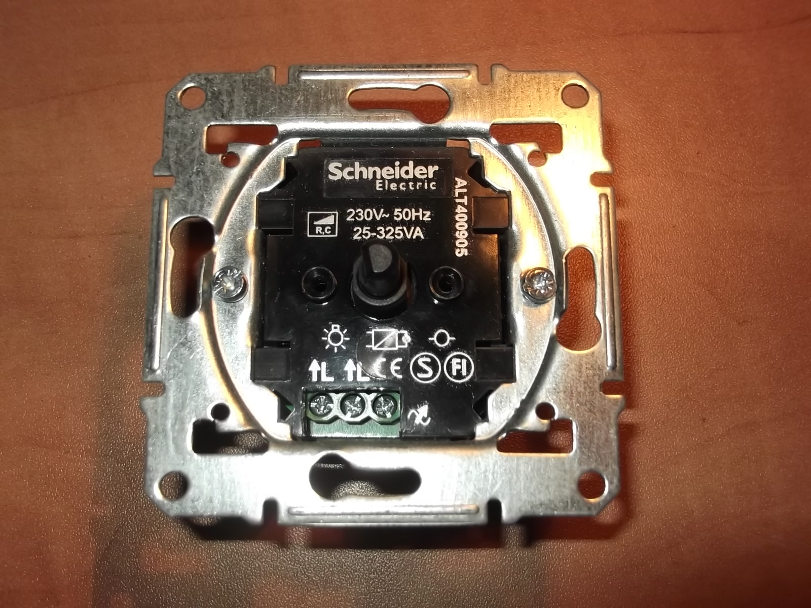

    I have a bit of a problem with relay selection, though not exclusively.
    I have two light sources "h1" and "h2" (230V halogen bulbs) and only two switches, actually one, as the other is the dimmer shown below.
    Operating principle:
    The bell switch changes states on relay 1 (bistable):
    - switching on light h1 at 100% possible brightness,
    - switching on motion detector 1, which, upon detecting movement, turns on light h1 at the brightness set on the dimmer,
    - switching on light h2 in 100% possible brightness,
    - no possibility of switching on light h1.
    Motion sensor 2 switches on light h2 with the brightness set on the dimmer.
    Which cannot be changed:
    number of switches: 1 switch + dimmer,
    dimmer,
    number and type of movement sensors: two sensors OR-CR-207,
    What can be changed:
    type of switch,
    relays,
    I don't know much about relays, so please choose the right ones and reduce the number. Someone may know how to wire it better, maybe there is some wonderful cheap relay that will take care of the whole thing. I won't hide the fact that some sort of schematic for the layman would be helpful.
    One more question, can the dimmer work without being loaded, i.e. give voltage at the output but not power any bulb ?

    OK, I just don't know to what extent it solves my problem. In what way does its functionality differ from the dimmer I currently have. The current one dims or brightens with a knob and clicking on it turns it off or on. This is more about bypassing the motion sensors.

    OK, I managed to reduce the schematic by one relay. All I had to do was use a staircase switch (simple right:]). However, I still don't like the fact that these are electromagnetic relays, admittedly they are cheap (a finder relay is about £16-18/pc), but noisy. Maybe someone knows of some 'cheap' solid state replacements?
    My issue is that I have two rooms, each with: 1 switch, 1 motion sensor and lighting. I just want to get as many possible states as possible. Anybody have any other ideas on how to put it all together?
    I repeat the question:
    ..can the dimmer work without being loaded, i.e. give voltage to the output but not power any bulb ?

    The vendor states that the motion detector can supply 1200W - nothing prevents getting rid of more relays and inserting a switch for each bulb (circuit).
    Current flow from L:
    one dimmer, then two independent "channels" consisting of : motion sensor (contacts), switch and halogen - to N.
