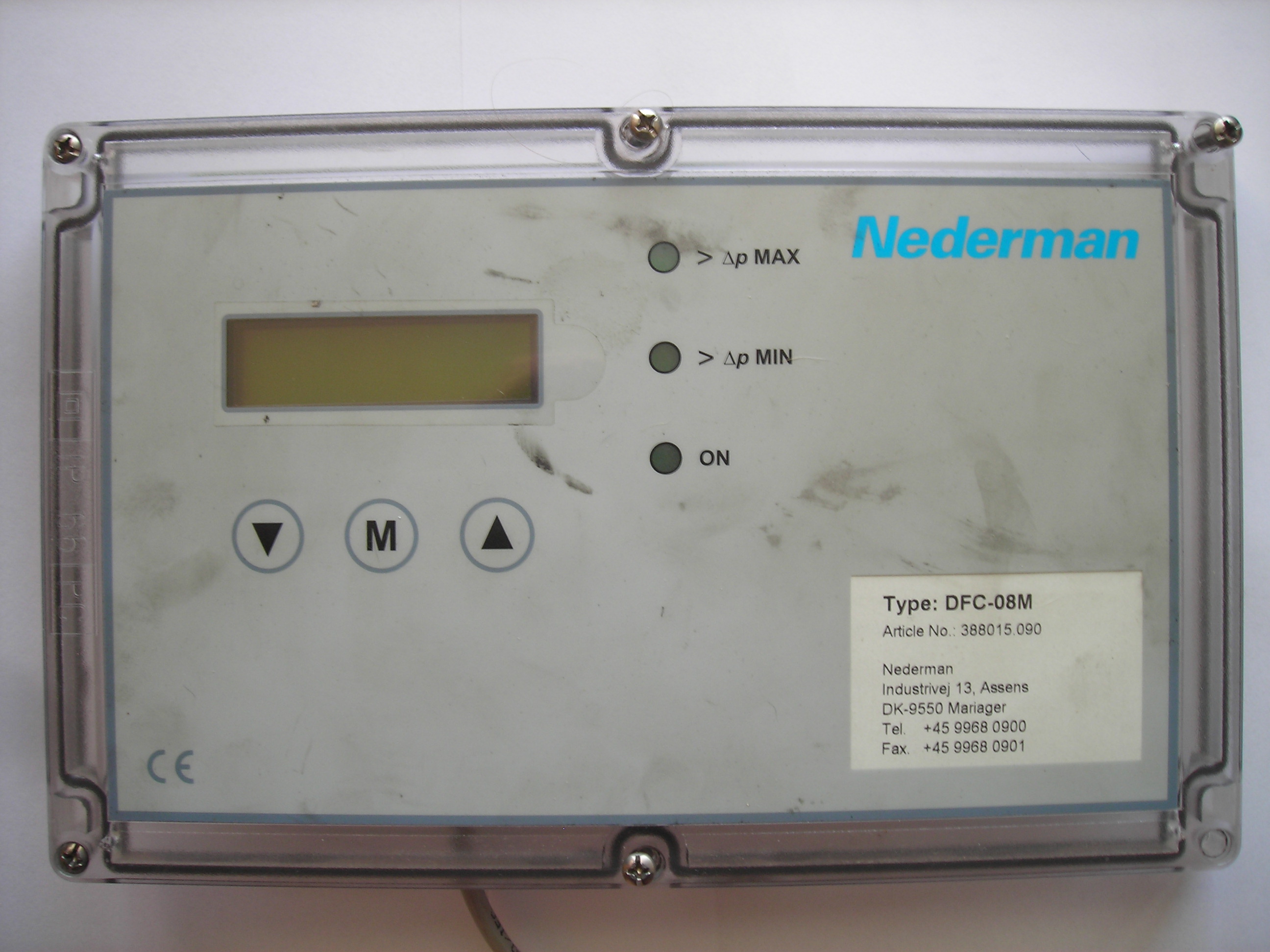

    Do any of you own a NEDERMAN DFC-08M ventilation filter controller or have a charge for the at89c51ac3 processor. NEDERMAN DFC-08M Ventilation Filter Controller & AT89C51AC3 Processor Charge Inquiry

    Does anyone know how to reset the hour meter?
    I have this driver but some functions are blocked :(

    You need to press and hold both arrows until the parameters appear. Then use the arrows to look for the hour deletion parameter, hold M, enter the code, confirm by holding M, confirm with the arrows changing from NO to YES, and confirm by holding M.

    Does anyone know the code?
