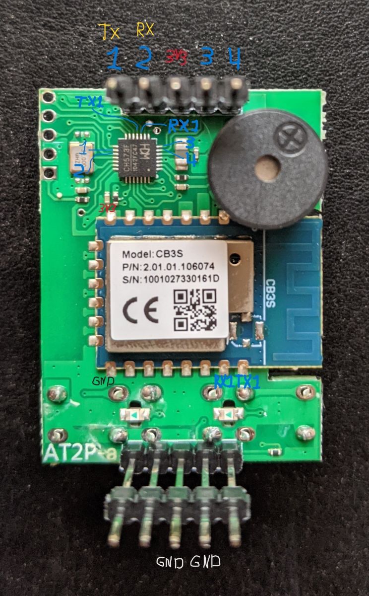

  • Inside, a CB3S TuyaMCU handles WiFi/Tuya Cloud, while a CH573F MCU manages power monitoring, screen, buttons, and RS485 over UART.
  • Pins 1 and 2 carry RS485 TX/RX, and ESPHome works when they connect to RX/TX with a 120 Ohm resistor across A and B.

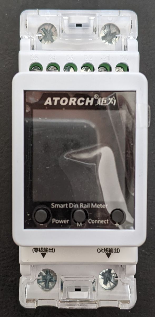

    The overall build quality is excellent. The screen is bright and clear, and the device offers a full set of features. However, there are a couple of drawbacks:
    •The RS485 interface does not use Modbus; instead, it relies on a proprietary protocol developed by Atorch.
    •The device is not bi-directional, meaning it cannot measure exported power. This I believe to be a software limitation.

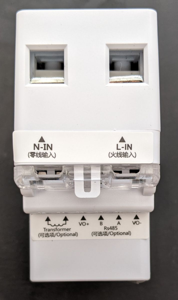

    Atorch electrical energy meter with a display and buttons for DIN rail mounting.
    Front of an energy measurement device with visible inputs labeled N-IN and L-IN.

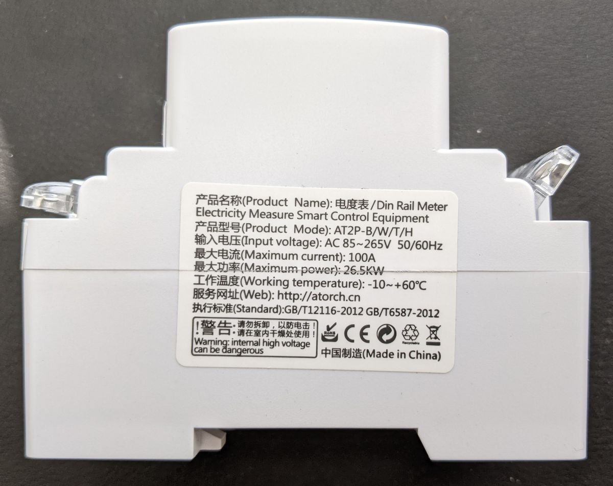

    Nameplate of an electricity meter from AliExpress

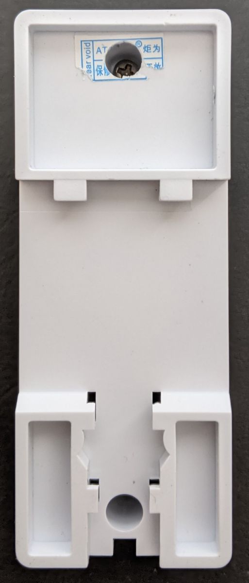

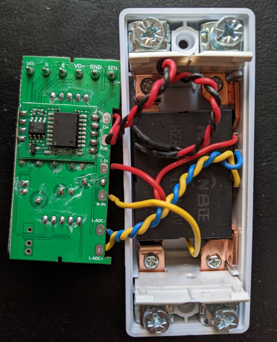

    Opening the device is simple, remove the locking mechanism and 2 Philips screws.
    Back of an electronic module case with a label, open space for the screw.

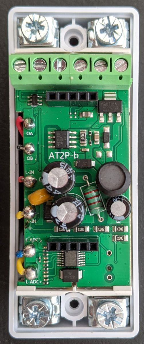

    Once opened, the construction appears high quality. The daughterboard is connected via a 10-pin standard interface, the power electronics are well-arranged, and there's a small beeper for audible alerts.
    CB3S module on a green board with electronic components.
    Interior of an electronic energy meter.
    Interior of an energy meter showing a circuit board and wiring.

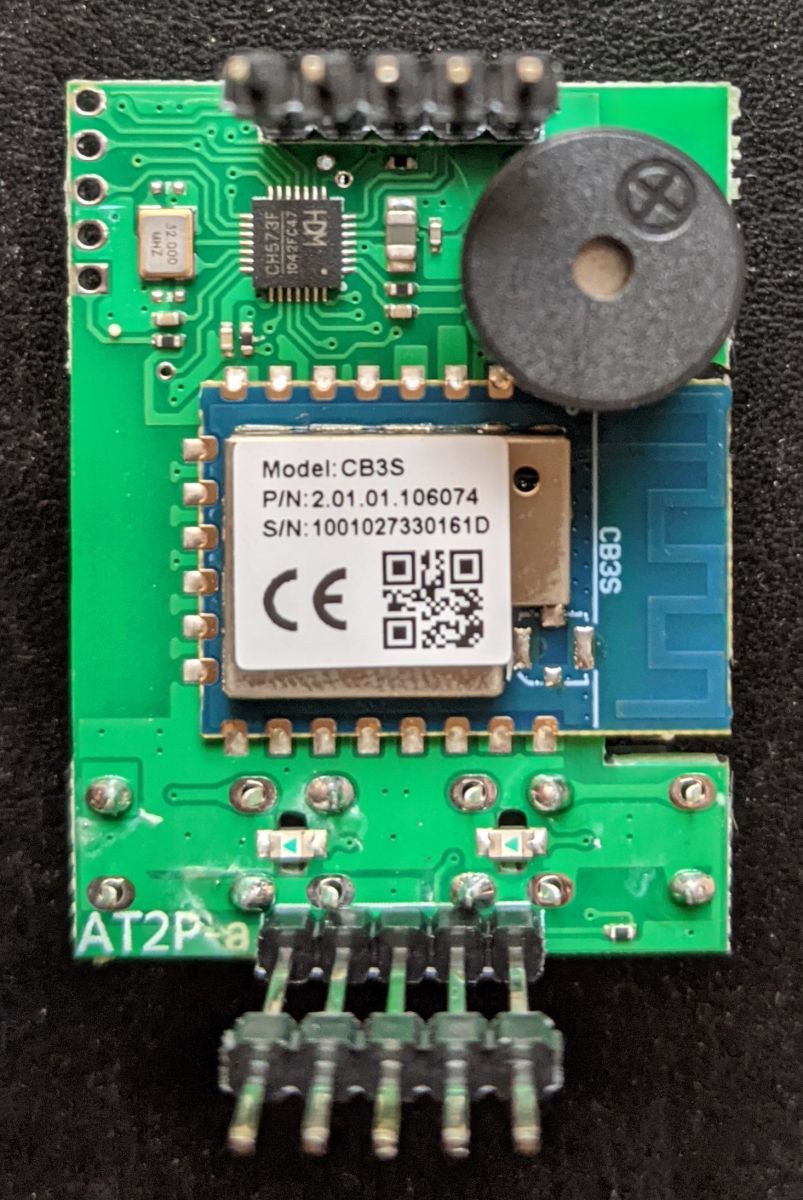

    The meter contains a CB3S TuyaMCU, which is responsible for WiFi connectivity and integration with the Tuya Cloud/App. This connects via UART to a secondary CH573F MCU, which handles power monitoring, screen, buttons and RS485 communication. Pins 1 and 2 are TX and RX for RS485.
    Close-up of CB3S module on a printed circuit board with labeled pins.

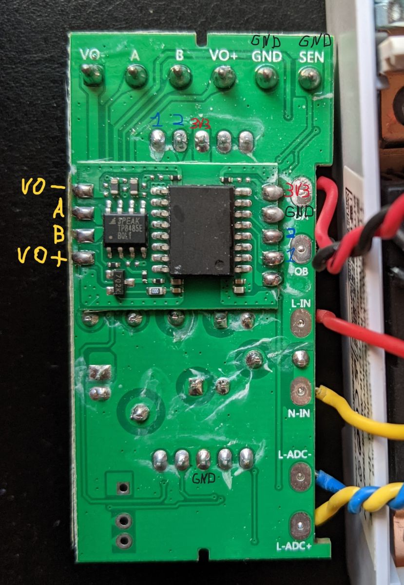

    The RS485 module works directly with ESPHome if you connect Pins 1 and 2 to RX/TX respectively (I have tested this) and it works fine as long as a 120 Ohm resistor is placed across A and B.
    Close-up of a circuit board with electronic components and labels.
    If Pins 1 and 2 were disconnected from the CH573F and instead connected to the CB3S TuyaMCU, Modbus control via ESPHome could theoretically be enabled.

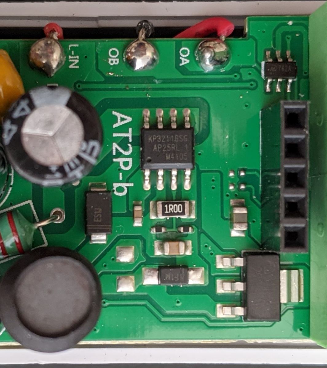

    This IC seems to be there for 3.3V DC power regulator:

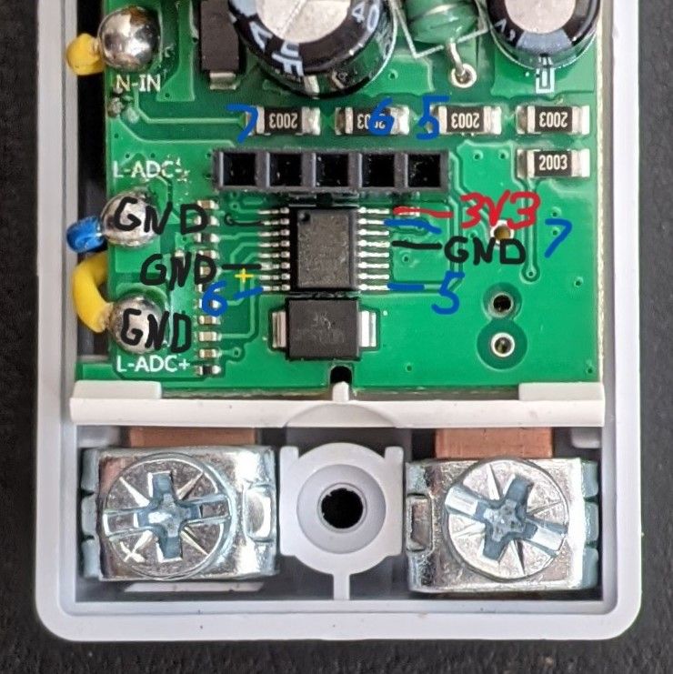

    One key IC is the AC power metering chip, but unfortunately, all its markings have been removed. I have attempted to mark it as best as possible. If anyone can identify it, please let me know!
    Interior of an energy meter with visible printed circuit board and pin labels.

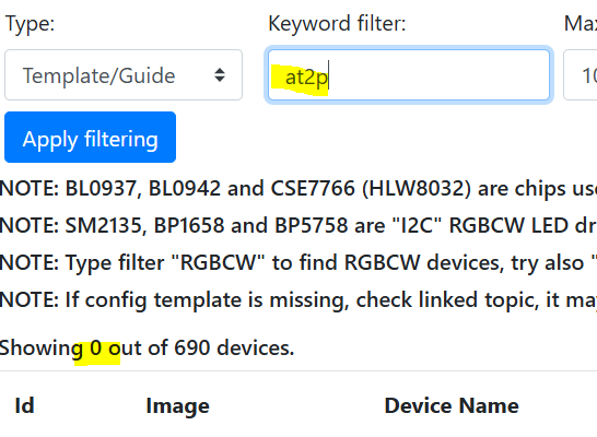

    I think I may need to go through all the topics and check if each has entry on list... because we sometimes forget about it.
  • #5 21420305
    Posts: 5216
    Help: 448
    Rate: 917
    yes. I have caught quite a few by going back through, but there's undoubtedly more, I wasn't terribly methodical.
  • #6 21420310
    Posts: 14767
    Rate: 12906
    I can get a list of all topics in IoT section and then write a little script to compare it with what we have on Teardowns List, would that help?

    As requested, I have de-soldered the MCU and performed a firmware backup. I presume this is what you were looking for.
    readResult...-46-31.bin (2 MB)You must be logged in to download this attachment.
    Also, Atorch is sometimes branded as HiDANCE, which I believe is the same company.
    I have tested the RS485 interface, and it works fine with their proprietary software. However, as mentioned before, it does not use Modbus but rather Atorch's own communication protocol. It is possible to make it use Modbus over RS485 by connecting the RS485 to your own MCU.

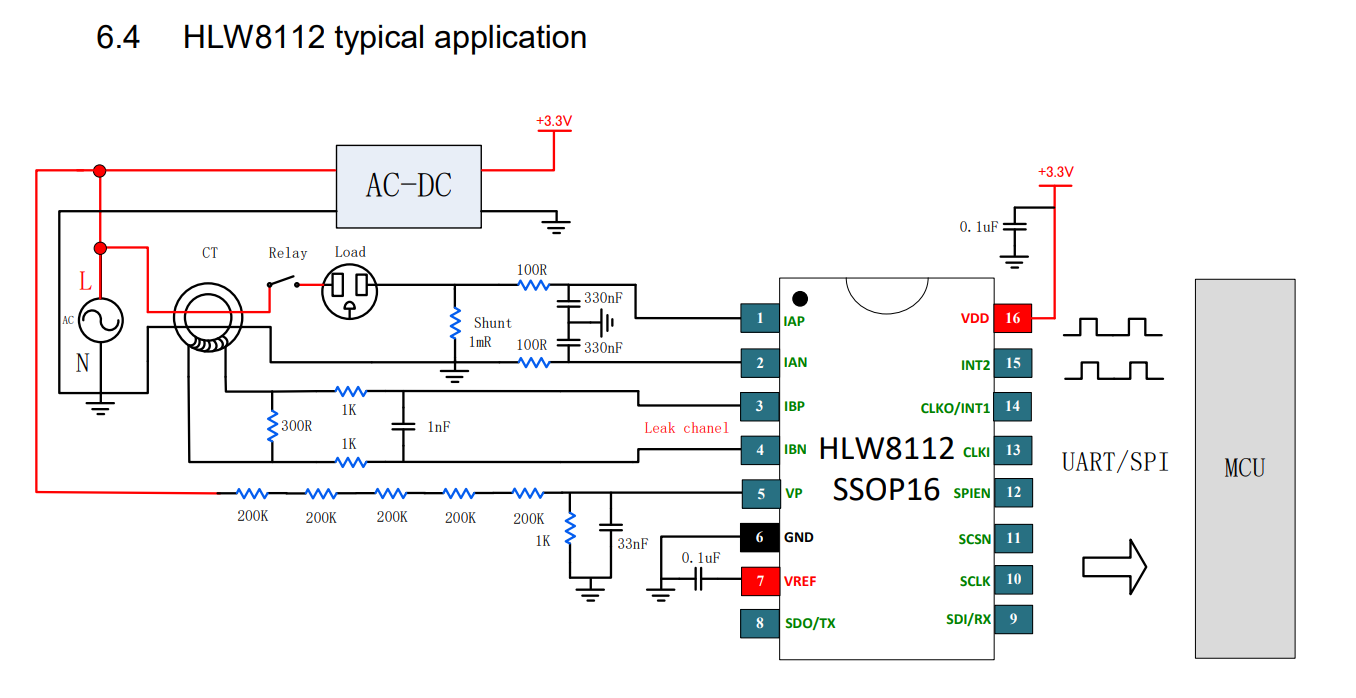

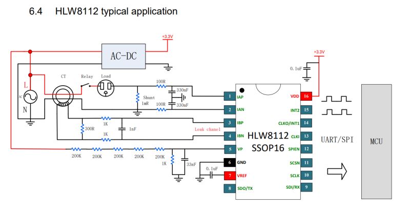

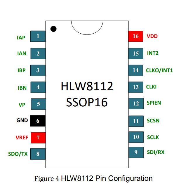

    One of the key integrated circuits is the AC power measurement IC, but unfortunately all its markings have been removed. I’ve done my best to label it as clearly as possible. If anyone can identify it, please let me know!
    In my case, the marking on the HLW8112 hasn’t been removed.
  • #18 21925770
    Posts: 14767
    Rate: 12906
    I think it actually fits:
