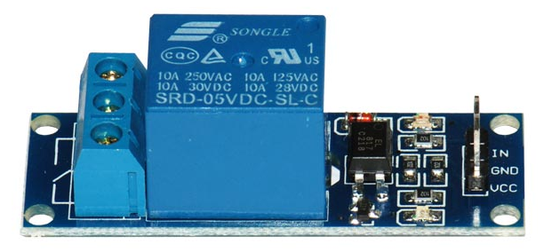

    5. Relay module based on Songle SRD-05VDC-SL-C 3.1.18. It is forbidden to publish information to sources that expire after a certain period of time (publishing links to short-lived sites). Edit: Raspberry Pi for automation of external blinds/room lights. Selection of components
    enough from switching on/off the power supply to the sockets and lamp? Is it suitable for hiding in the cable box?
