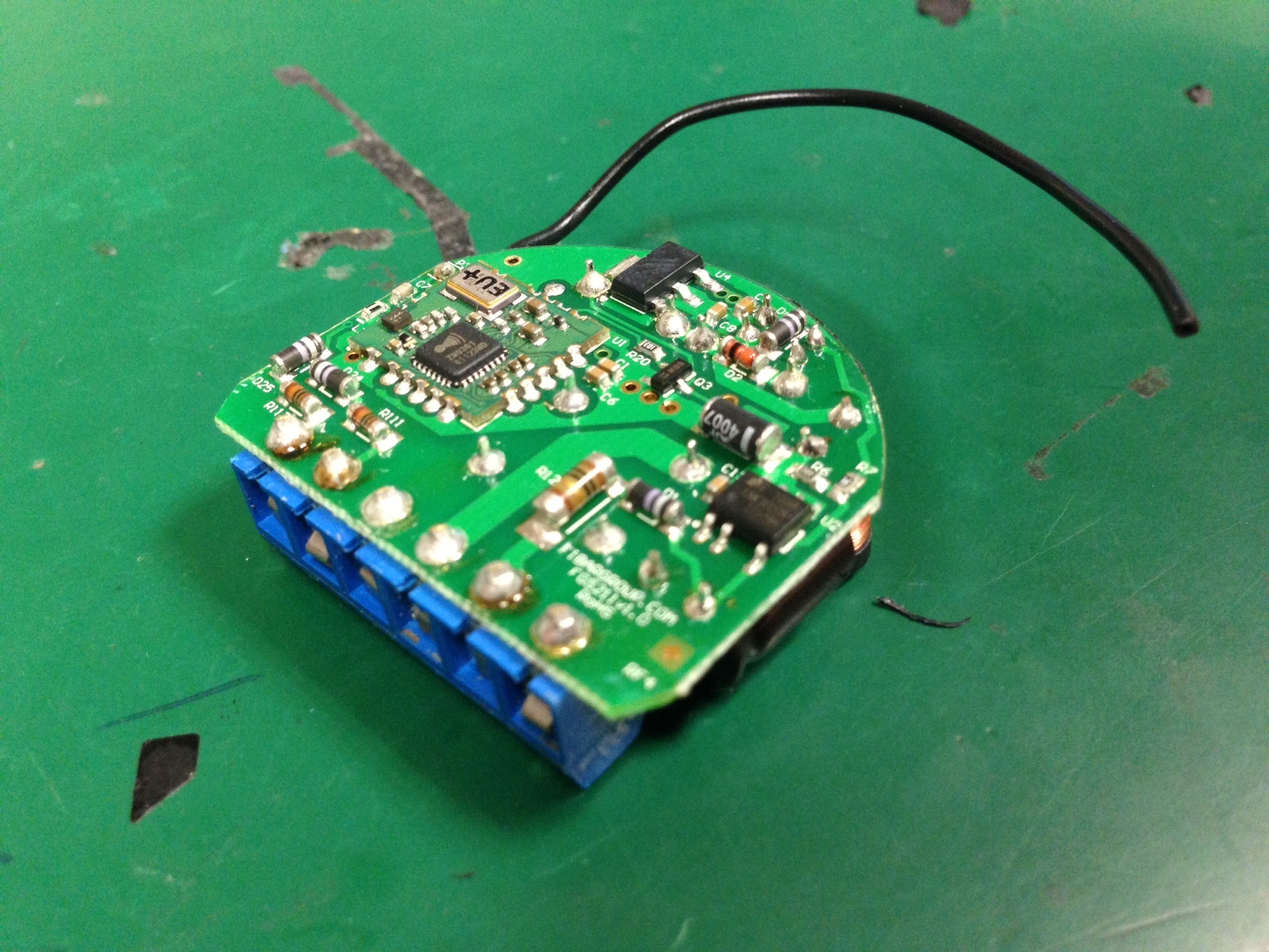

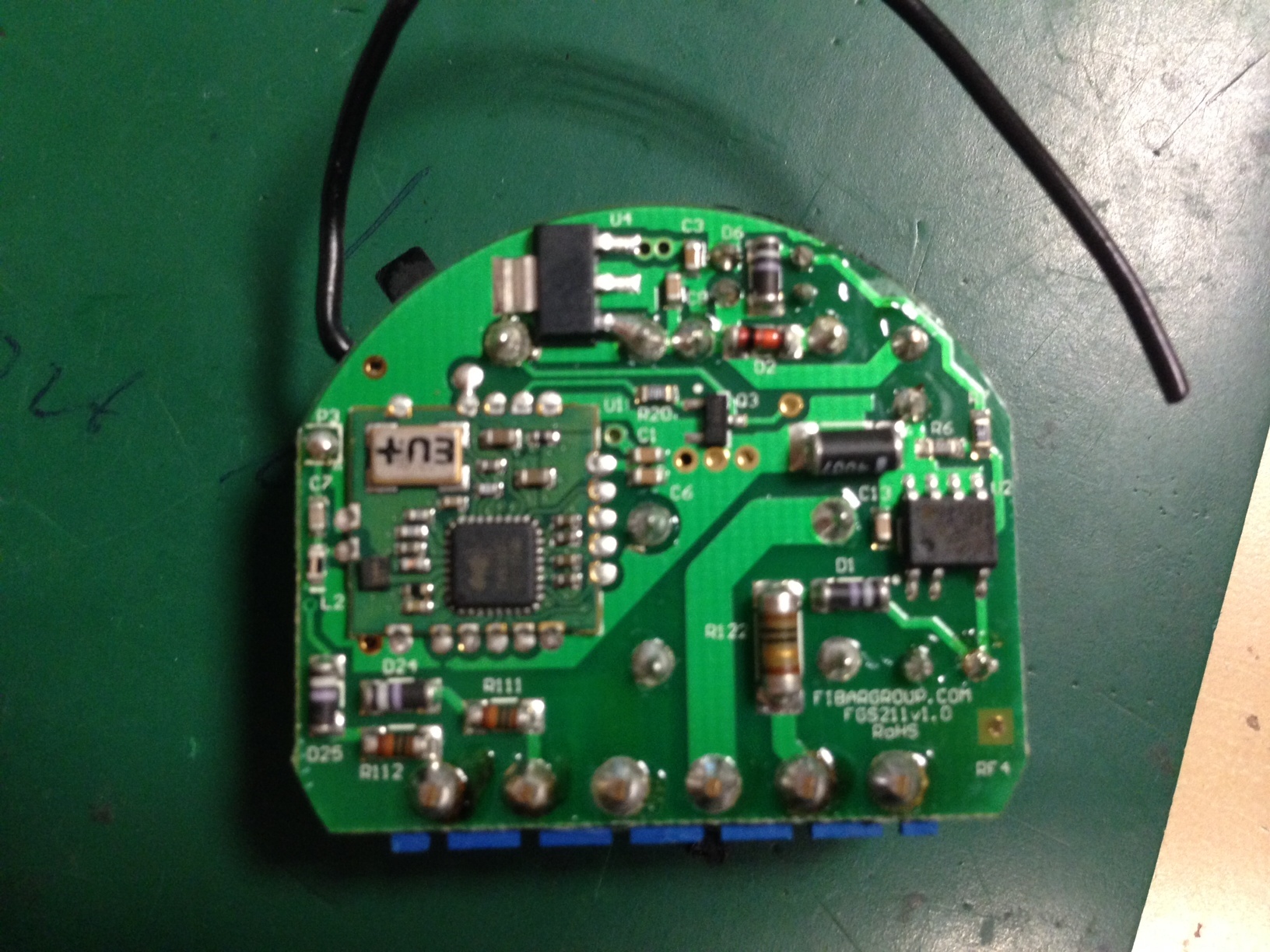

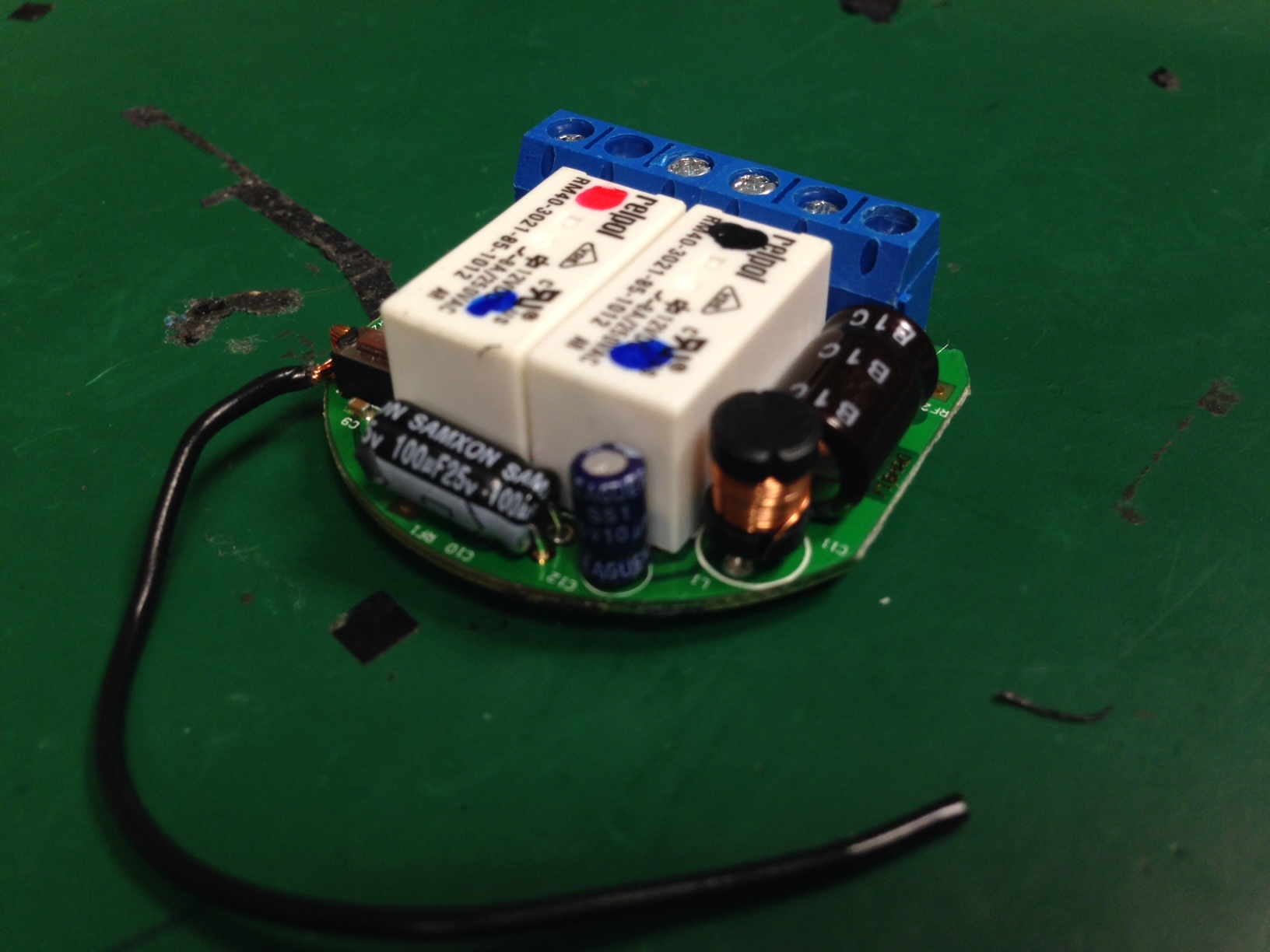

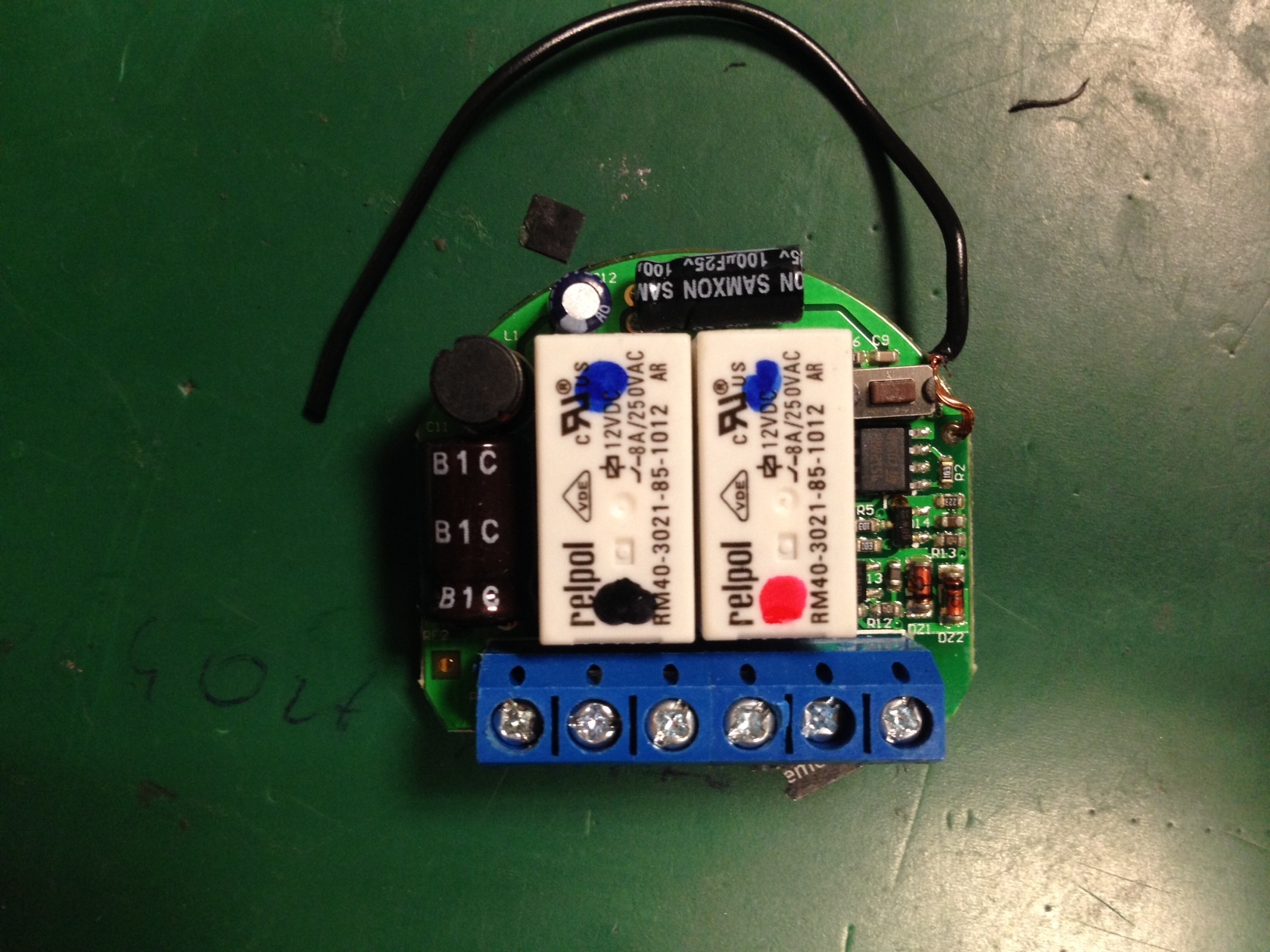

    Hi,
    I'm probably not the only one curious about how Fibaro "toys" are built, especially how they solved the power supply issue. Today I got my hands on a 3kW switch module, so I took the liberty of opening it up and photographing it. The switching system is Relpol RM80 relays with a load capacity… 8A, which is just under 2kW. If you have other Fibaro modules, throw in :)

    I think what they meant was that you can squeeze about 3kW out of the whole device. If the two relays are connected in parallel then it will probably work out that way. However, when the 'RELPOLEs' stick together, cook or explode is another matter. The only thing that can be complained about is the width (cross-section) of the power paths (in my opinion).

    I think this is one of the first designs by Fibaro, which is establishing itself as a high-end brand.
    What I see here:
    - not the best quality connectors and electrolytic capacitors [two main causes of failure, due to the passage of time (these are home automation modules so they work 24h/356 expected life min. 10 years)]
    - rather too weak relays for universal home applications [as above].
    Besides, 90% of the technical thought of this device is contained in the z-wave radio module [this is not a Fibaro production].

    Probably "something" from Power Integration that is a power inverter. It's hard to tell from your photo what exactly they put in there. And what exploded and has a hole in the middle?

    This is the LNK304 from PI.
    Generally from the hardware side these modules look uninteresting. In front of the LNK according to should be a piltr pi with two capacitors and a choke ( LinkSwitch-TN
    Design Guide Application Note AN-37) but in the module you will find only 1 small capacitor. No protection at all.
    Looking at the wallplug I was not surprised that it is not approved for sale in Sweden. The rules regarding the spacing between paths have not been followed.

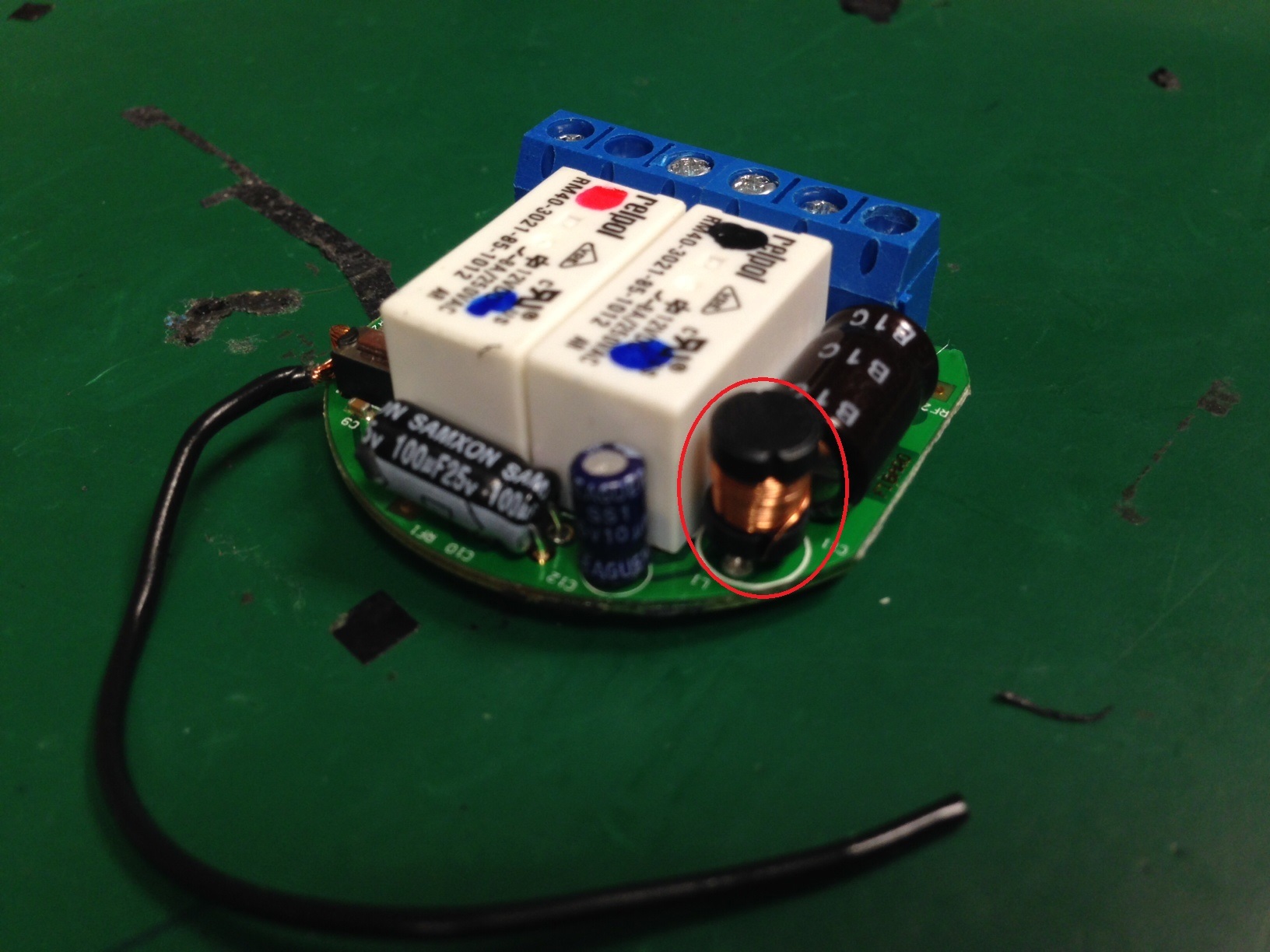

    pepe_lodz
    Posts: 324
    Rate: 65
    Is this what I have highlighted in red ?
    And how to pour it and with what varnish ? From my wife's nails I understand that it can not be :) ? Construction and power supply of the 3kW Fibaro Switch module - photos and descriptions ?
  • Diagnose the squeaking coil before applying varnish
    #18 15354510
  • #19 15354513
    pepe_lodz
    Posts: 324
    Rate: 65
    OK and how do I check if it is this component that is squeaking and how do I flood it ?
