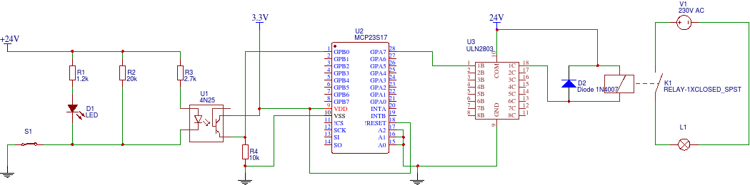

    Thanks for the hint with the port expander. I've decided to use MCP23S17 (SPI - raspberry-pi gives 2 CS to start with, so I can connect even sixteen dice) and ULN2003.
    As for opto - I'll probably take some ISP521-4 type kit to have fewer dice.
    For the moment, I have prepared myself a schematic. In the schematic I have prepared one input and one output each. The output is not galvanically isolated - I wonder if it is needed. This is where I would need advice.
    E.g. why does http://hapcan.com/devices/universal/univ_3/univ_3-2-3-x/univ_3-2-3-x_b.pdf use 0R at the relay coil?
    I prefer to leave the diode at the relay coil - as there will be a long distance between the ULN2003 and the relays.
    Am I going in the right direction with this schematic?

    Diagram rather ok, but I'm also an amateur, so I probably shouldn't comment.
    As for that 0R it is indeed something strange. I have no idea what it is doing there. You could ask the author.
    I wonder why the galvanic separation. I don't think anyone does it that way because it's not worth it. Each optotriak costs money and when you have 30-40 inputs in a module, it's easier to replace the processor if something happens. See for yourself in this project they have added a protection diode - a transil. It's a special diode that can take on surges if one were to occur.
    I have 3.3V logic at my place and I plan to make switches: open/closed to ground and I'm worried that it might not work if something is induced in the cables.... We'll see in the wash.

    The 0Ω resistors were probably used so that the paths on the PCB could be routed more conveniently or a lower voltage relay could be used.
