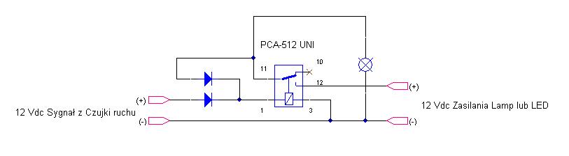

    Hello, I have a problem with selecting a contactor for lighting around the house. The led lights something like halogens 10 W,230 V are to be activated with a time delay contactor with delayed switch off. The contactor has to be controlled by 12 volts, because that is what I have on the output of the sensors. I have searched there is a lot to choose from but I don't quite understand what I am reading. Will something like the PCA512 UNI fit?

  • Use PCA-512 contacts for self-latching delayed switch-off
    #6 13469895
    pafciowaw
    Automation specialist
    Posts: 2439
    Help: 480
    Rate: 365
    This is an inelegant solution: a small capacitor will not extend the time significantly, while one with a large capacity will either not have time to charge or will very quickly destroy the detector contacts with a significant charging current.
    The only advice I can see is to power (excite) the tripping of the PCA-512 with a signal from the detector and, through its contacts, to sustain its own power supply (i.e. from the detector to supply a switching signal and a 12V constant power supply).

  • #11 13472091
    pafciowaw
    Posts: 2439
    Help: 480
    Rate: 365
    Col. retrofood: all my solutions revolve around the PCA-512 UNI being powered on 12 Vdc (12-264 V AC/DC), so both power and switching can be done on the same supply. To the PCA-512 UNI, all you need to do is feed the signal from the detector, the 12 Vdc power supply (to the LED), and separate the voltages with a rectifier diode (or diodes).

    #13 13472902
    retrofood
    Posts: 31317
    Help: 1140
    Rate: 4798
    Let them circulate, just how does this relate to the Author's assumption?
    LED lights something like halogens 10 W,230 V should be run...
    Therefore mine revolve around two tensions.
  • #14 13473069
    pafciowaw
    Posts: 2439
    Help: 480
    Rate: 365
    Indeed...mea culpa....
    As the PCA-512 has only one working contact: you have to add a relay and only from its contact supply the 230 Vac circuit.
