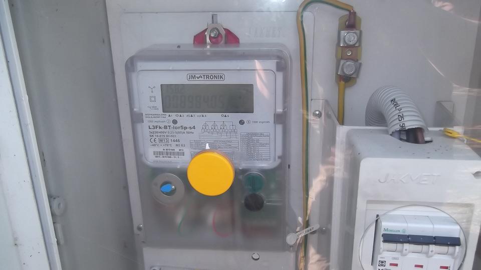

    I provided this link to indicate that it is not always necessary to read the physical data from the counter. An alternative solution is to count the flashes of an LED. Every electronic counter has such an LED. So this is a universal method. The ZE often mounts the meter in a cabinet behind plexiglass and the user has no physical access to it.
    Raspberry Pi - Which meters for remote water and energy reading?
    From behind this glass, however, LED flashes can be detected. An analysis of daily power consumption in my opinion only makes sense for houses with many different appliances. There, there is usually something to save on.
    Note that simple water meters do not have any electronics. In this case, you can only count the rotations of the dial (optically or with a reed switch).
