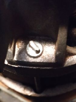

    Hello, I have a problem with unscrewing the screw (screw), which has three recesses on the head. I think there should be a cross, but for three.

    There may be several solutions. If there is an access and you can grab the screw's head somehow well, some small pliers can help. You can try to redo any endings you have. I once managed to unscrew the screws from the power supply with a properly selected flat screwdriver. Torx has 6 teeth, you can try to get rid of the three and maybe you can do it (remember that this is tool steel so it probably won't be easy). Of course, you can find such a screwdriver somewhere on the market of tools or drill the screw head, remove the remains and give a new screw.

    Use a suitable screwdriver, do not catch with tongs.
    It's probably about TRI-WING

    This is a water pump, thanks to which I will be looking for the right tip, because you can't get hold of the pliers.

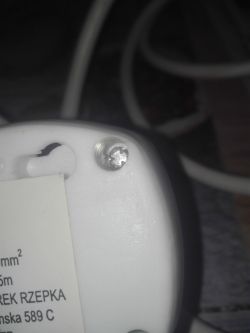

    I also have these screws on the power strip with obi, 3 node security? how to unscrew it?
    The strip fell a week after purchase, and there is no receipt. :)

    Could someone please tell me what this screw is and how to unscrew it?

    "French" or "Swede".

    You can cut a tube of a suitable diameter and the key is ready

    How French, how is a 5mm screw?

    You did not write what size. Cut a slot at the end of the steel bar.
    Have you tried with flat tongs?

    You can also try a flat head screw. :) In the kit shown above, there are flat slotted screwdrivers in the center, and they should also do the job, unless they're made of a very soft material.
