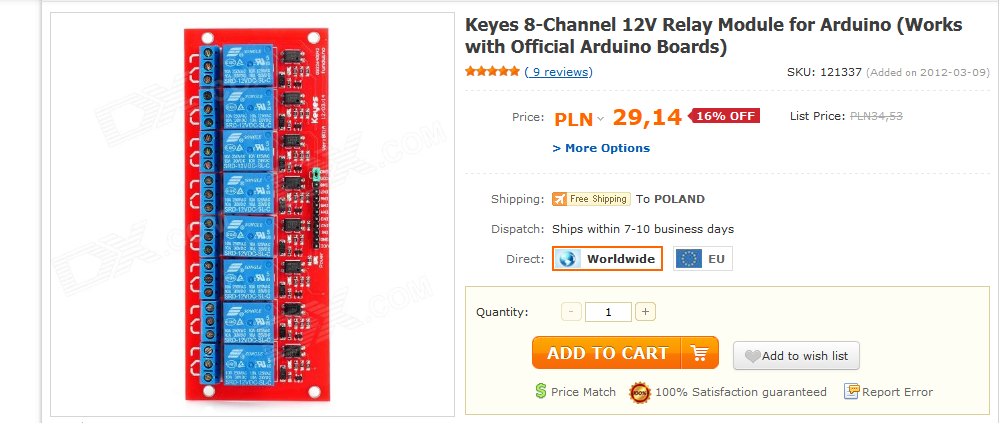

    You can connect external boards with relays or control inputs, temperature sensors to both platforms. Rapsi is more "high-positioned" if you know what I mean, for the BMS in my opinion the Arduino is more suitable.
    Example actuators ;) for Arduino
    Raspberry Pi or Arduino - Is it possible to build a BMS without relays?

    And for the Arduino under the BMS is there any ready software???? How many boards like you have shown can be connected, per relay how many components can be connected????

    How many actuators can be connected to the Arduino?
  • #6 13859742
    gglmaster
    Posts: 24
    The case is that in the simplest version of the Arduino (UNO), we have 14 digital inputs/outputs available (of which 6 can be used as PWM outputs). In this case, we could connect 14 simple actuators (e.g. LEDs, relay) to the Arduino.
    For the use of a large number of such devices, extended versions of the Arduino have also been developed, such as the Arduino Mega, which has as many as 54 digital channels.
    In addition, we can extend the capabilities of the platform at low cost using various components, such as sliding registers. More on this subject here .
