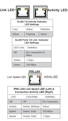

    As in the topic, I'm interested in a theory that I can not find in the network, what do the LEDs in the LAN ports mean, what do the colors mean and does the flashing frequency also mean something? Thanks.

    I found a solution, such a schematic satisfied me and resolved my doubts, maybe someone who is also as inquisitive as me will help.
