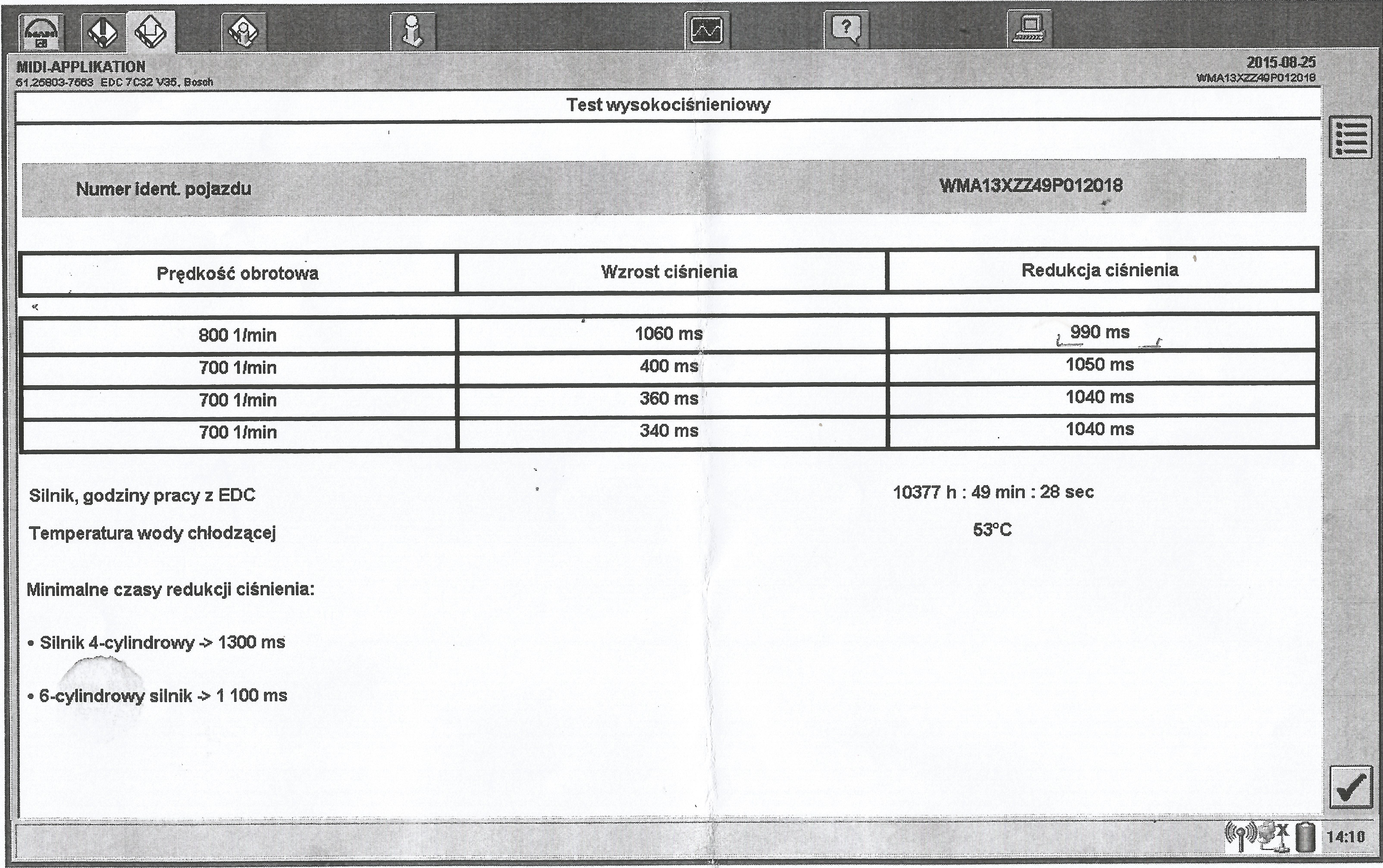

  • #13 14934859
    turnip4
    Posts: 73
    Rate: 67
    Could the author please write what helped him? Specifically what he did, because I have the same error and a similar problem, except that with me it shows the following errors:
    EDC 03780-01
    EDC 03779-01
    EDC 00094-02
    EDC 03775-02
    EDC 03776-01
    When the car is switched off, the driver starts it and the errors pop up, as if he would not manually delete the errors, the car will gently choke. He manually deletes the errors on the car's computer, starts and drives, the errors light up, but the car drives normally, has power, the combustion is as it was.

  • #17 14945827
    turnip4
    Posts: 73
    Rate: 67
    There is no oil in the spider, I checked, the filters were very dirty, strange because after 6500 km barely. Today I'm at the service, initial diagnosis that the fuel system pressure is too low. Diagnosis continues and it will be either the injection(s) or the high pressure pump.
  • #18 14949402

    Well in my case it came out to be the high pressure pump, and they didn't diagnose the injectors well for me because they said it was 990ms on the pump, and it should have been 1100ms. The injector test was not conclusive as the pump was not giving enough pressure. So it remains to be seen what the injectors are like after replacing the pump.
    MAN TGX 440: EDC 03780-01 Error at Idle - Possible Causes, New Filters, 380,000KM, MPROP Range
    Pump supply? You mean there is still some small pump before the pump and it is worth replacing it straight away? That a pressure drop of 110 ms is already a reason to replace the pump?

    I think this is a case of normal wear and tear. There is still a fuel filter between the low pressure pump and the CP pump which should catch the filings.

    I can hardly see it, you have given one test and where are the rest? Pressure parameters? DLS was done? Pump capacity? Overflow? Apart from the errors, nothing is known.
  • #22 14952435
    turnip4
    Posts: 73
    Rate: 67
    That's all they gave me and said pump to replace. Well nothing, I will go and ask for the rest of the tests.

    Problem solved, the high pressure pump was replaced. After replacement a test was carried out on the injectors. It turned out that the 2nd injector to be replaced, in the service 1300 zł. Net. Replaced and problem solved.
